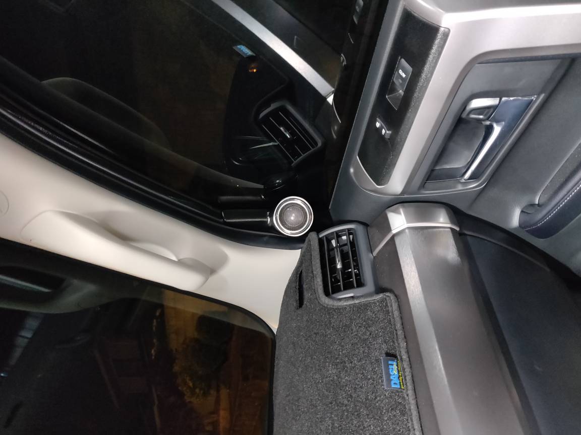

Finished me some tweeter pods
Sent from my ONEPLUS A6013 using Tapatalk
