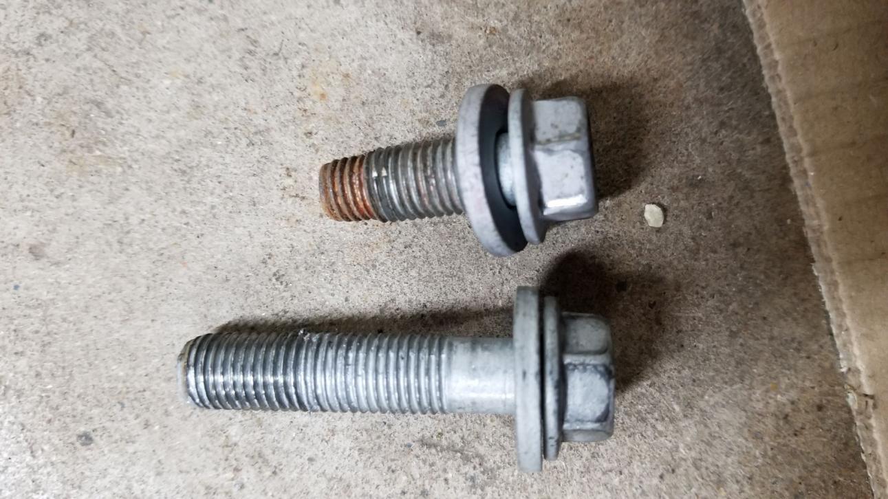

i just put mines on. let me know if you ran into a problem with the 2 supplied bolts for the rear. I had to reused the current bolts because the ones toyota sent were too long. (bottom=sent along with skid plate, top=current) anyone else had that issue?

You have to chase the threads in the bolt-holes to use the new bolts. I'm gonna pick up one of these, it would have really come in handy for my slider install, too.
Kastar 971 SAE and Metric Thread Restorer Kit https://www.amazon.com/dp/B003QHQEPE/ref=cm_sw_r_cp_api_i_85b3EbDV6APDD

Absolutely chase the threads for all. It is paint from the factory frame painting. Then anti seize. Older 4Rs paint and crud
Otherwise stripping of the female threads can easily happen

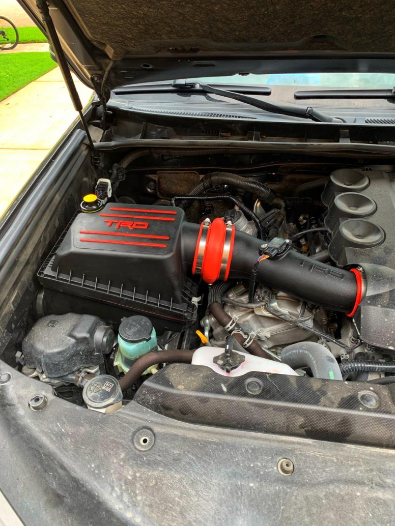

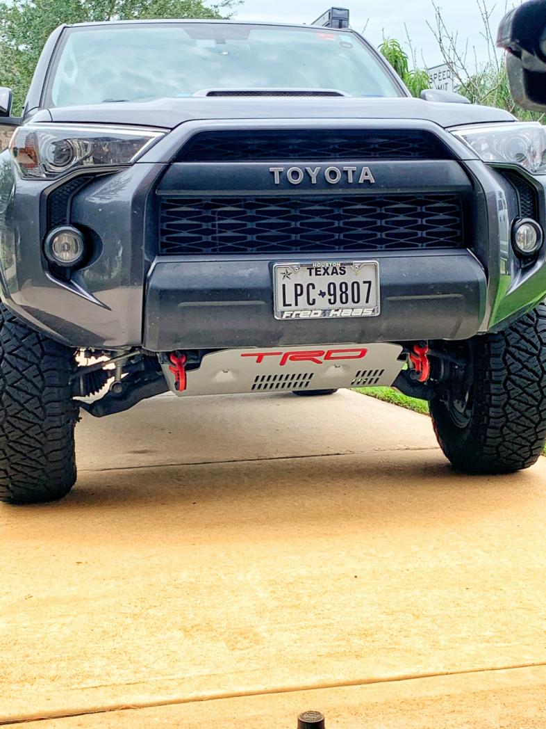

Installed TRD skid plate and TRD cold-air intake.

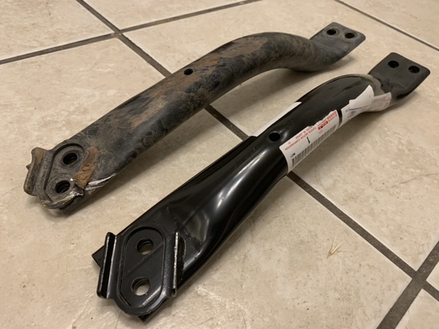

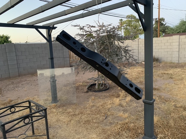

Stripped the small amount of surface rust off the replacement trans crossmember and gave it some fresh paint/primer.
Took delivery of the new support arm.
Prob throw the crossmember in tomorrow.

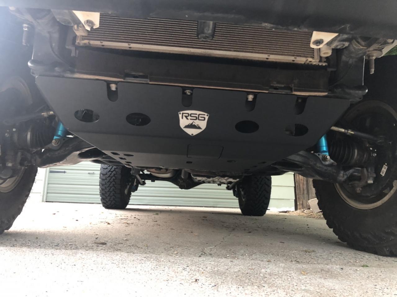

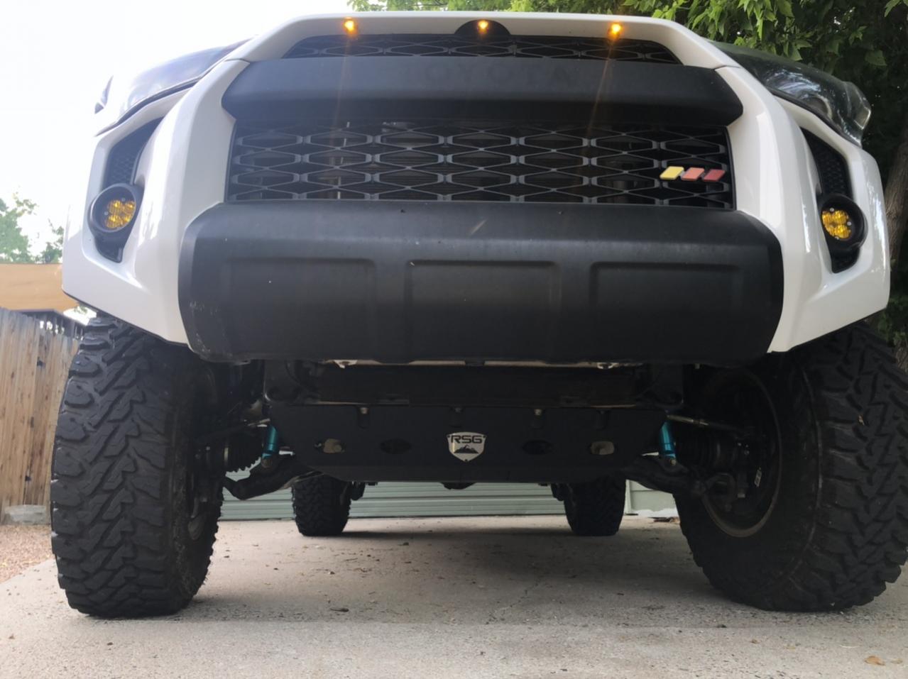

Installed the new RSG Metalworks 1 piece engine and transmission skid plate. Looks good and is super beefy!
I just used the shorter bolts that were already on the 4Runner. Unlike my '10 that did not have the 4 galvanized bolts installed and where I had to chase the threads, the '20 came with all 4 bolts installed even though they were not holding anything in place. Maybe that's how Toyota makes sure the nut threads are clean after welding. The only difference is length and the shorter ones still extend sufficiently beyond the nut, so no functional concern.

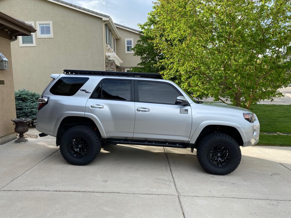

I've always been fine with the factory TRD Pro wheels on my 4Runner, but finally got the increasing urge over the last year, to swap them out.
I thought I would stay with black, but after seeing a few cement Tacoma's on gunmetal Ray10's, that made the decision easier......Still getting accustomed to the color change though...
I always thought I would stay with black, but after seeing a few cement Tacoma's on gunmetal Ray10's, that made the decision easier......Still getting accustomed to the color change though...
Those look much better! I am so tired of black wheels, blacked-out emblems, etc. and am enjoying seeing wheels in gunmetal, bronze, etc. Even with my factory ORP wheels, I wish they had left the recessed areas either aluminum or used silver or gunmetal paint vs. the black.
