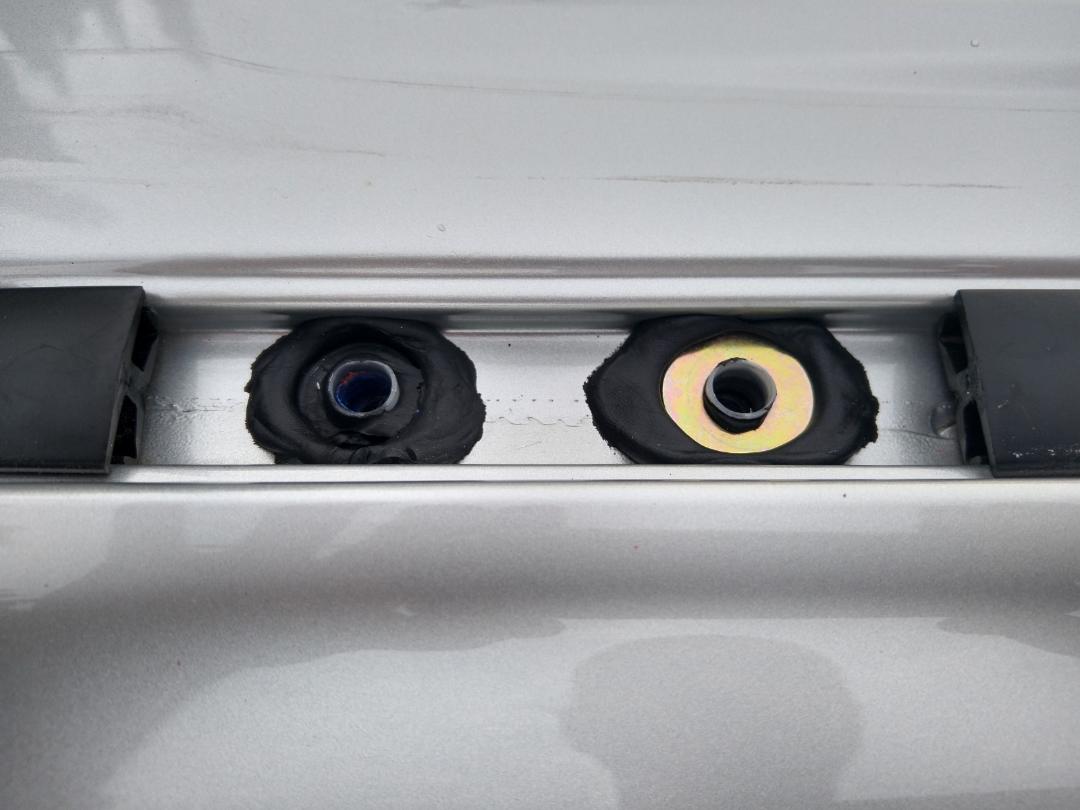

Installed a Prinsu Rack. Used butyl tape and ptfe instead of silicone. I'm gonna hose it down today to see what happens. Not looking forward to it lol

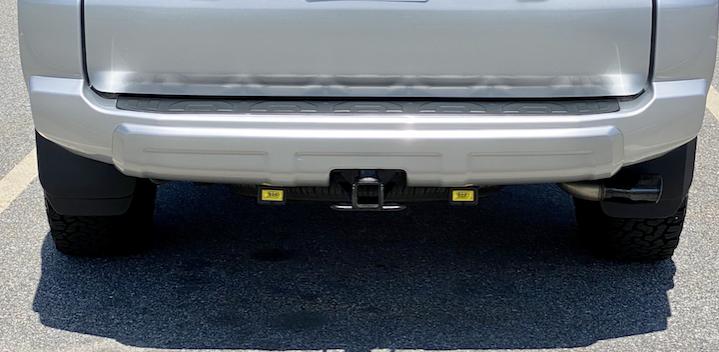

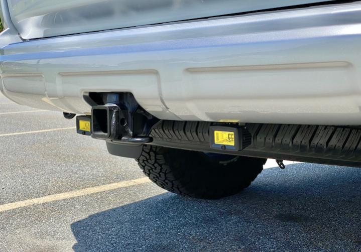

Also finished cleaning up the wiring for the rear KCHilites
(2" C-SERIES C2 LED - 2-LIGHT SYSTEM - BACKUP - 20W FLOOD BEAM)
and added Lamin-X yellow to the rear and front light bar to match. does warm up the light slightly without cutting the output)
May move the switch positions in the future but for now - one for the rear lights - one for front light bar, simple and I actually like these rocker ("cockpit") switches.

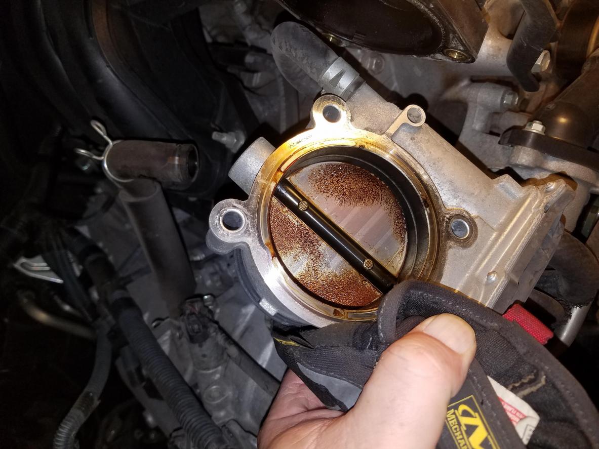

Cleaned the throttle body and MAF sensor. throttle body was totally loaded with crap on the backside and took some serious scrubbing. It had developed a ~1/16" ridge of gunk where the plate meets the inside all the way around. Not bad for 200,000 miles though. Will see if I notice any difference in MPG, idles as smooth as can be.
