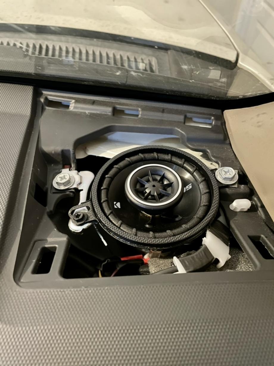

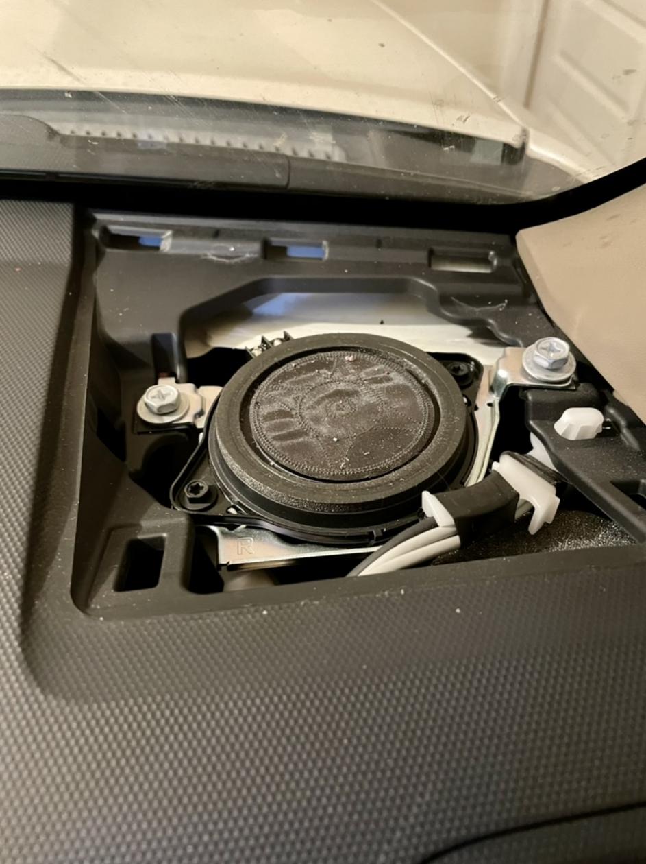

Replaced my blown OEM JBL dash speakers, sounds so much better now. Tweaking with the JBl system is possible boys! If you have questions or need help, shoot me a PM. Trimmed the plastic cover so that it didn't limit the travel of the sound since these are much larger & wider and the OEM cone didn't go around the entire speaker

This really peaks my interest as I have a 2011 Limited. Nothing I read made it seem like there were options for the JBL owners, but you just proved it can be done!

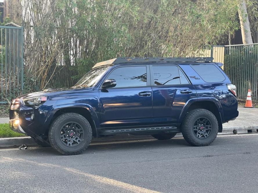

Ceramic window tint by G5 in Pasadena today,

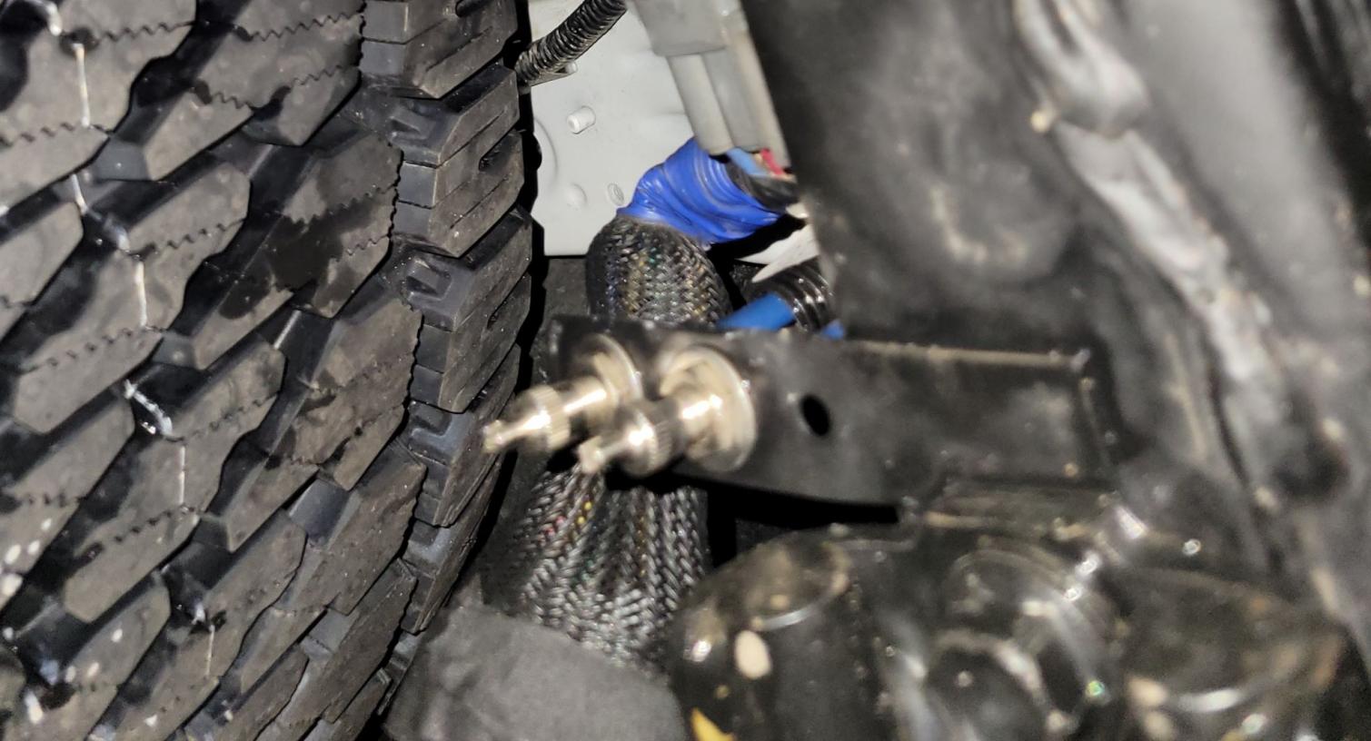

Found and fixed a leak in the airbags from my install a couple weeks ago. Just sitting in the garage they wouldn't loose a single pound of pressure, even if left for several days. But, after a 1/2 mile drive around the block I'd find both sides virtually empty. :dammit:
Seems I hadn't left quite enough slack which created some tension and a rather sharp curve in the lines just as they entered the valve stems. :doh: Just the slightest pressure on the lines and I could hear the dreaded, "sssssss".
A quick relocation of the valve stems and all is right with the world again...

Nice.. How dark did you go? Looks pretty dark from the photo. I was just there on Wed for my 3M Crystalline tint. I also had them apply Llumar PPF to my headlights. Those were a b*tch to apply.

50% on the windshield, 15 on the front doors an 5 on the rest G5's work is pretty much on point.

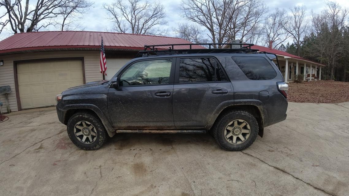

Aftermath
Had some fun hitting the Ouachita National Forrest trails. Did a quick rinse off, but will need to do a good pressure wash at some point
