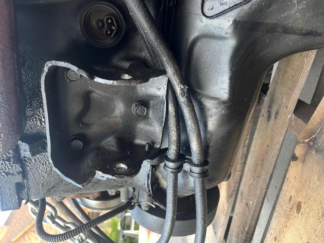

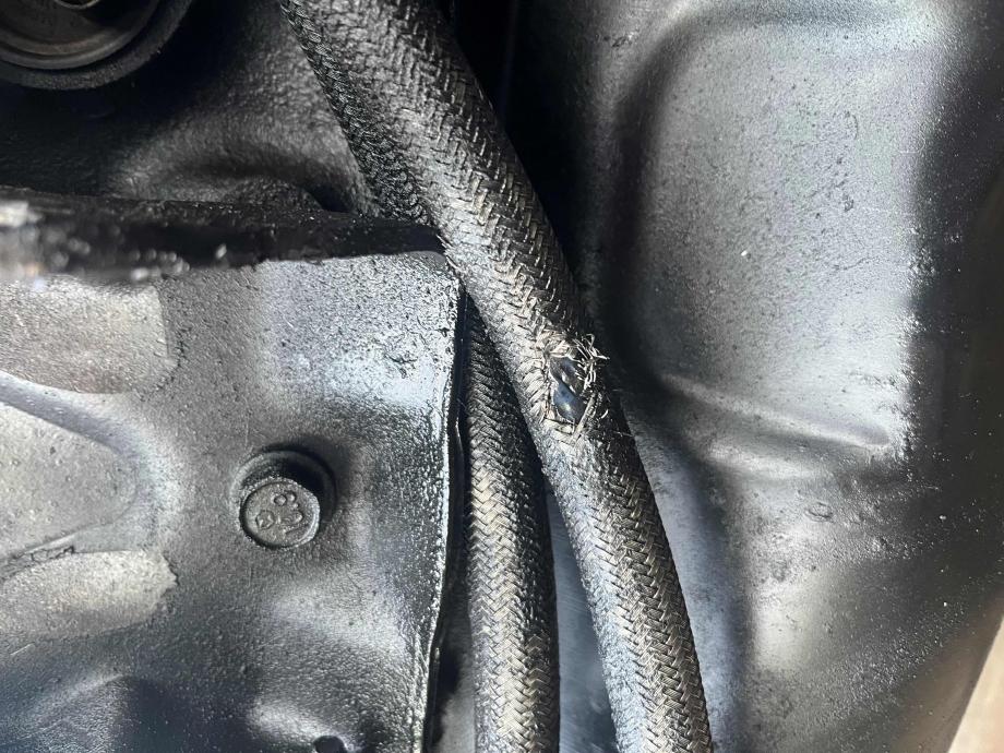

Not all my vehicle are 5th 4Runners. I have a ‘94 and ‘99 K2500 Suburbans with 6.5 diesels, despite their reputation, the diesels have been reliable with 296K on the ‘94 and 242K on the ‘99. Unfortunately 242K was it on the ‘99 as it suffered a catastrophic oil loss going up Skalkaho Pass in Montana. With no place to turn around, I had to keep going until I could turn around, then coast my way down with no power. The engine was toast.
Cause of death was from the bolt going through the engine mount losing its nut and backing out, allowing the engine to vibrate and rub through a braided stainless oil cooler line.

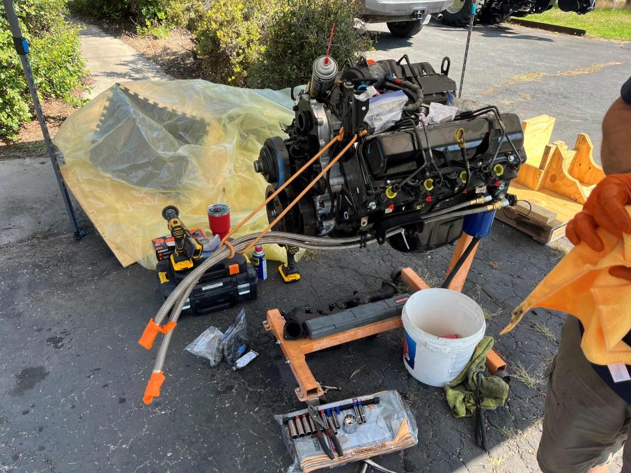

tow capacity. I also love the fact that it has no smog equipment such as EGR, DPF, etc. Also a new diesel truck would run around $8OK. I certainly can afford that, but I prefer my old rig. So I ordered a new 6.5 Optimizer long block from AM General Engine Products in Franklin, OH who bought the line from GM and supplies the U.S. military for HumVees. It’s an uprgraded 506 block like the one I had in the ‘99. Better metallurgy with higher nickel content to prevent cracking on the web mains, better heads with added coolant passages, and most of all, a forged crank versus the cast in the stock engine.

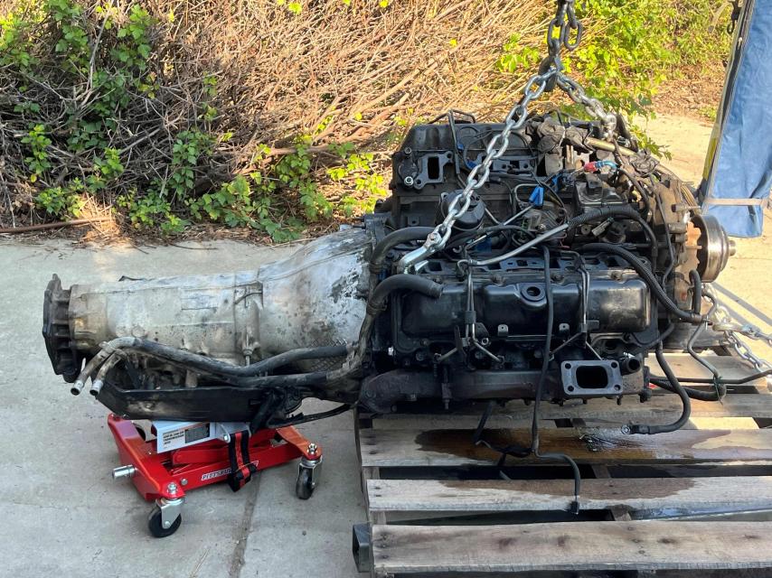

We’ve pulled the old engine and trans and are slowly prepping the new to go back in, which should happen tomorrow. I have a friend, retired Army Ranger and fellow 6.5 fan, helping me with this job, while staying at my ranch in Montana.

Oof. Rubbing through an oil cooler line while going up a mountain pass is my nightmare. My other vehicle is a '94 F-250 that I picked up to do some heavier towing. I'm also a fan of less popular engine choices, going with the 460 big block instead of the 7.3 PSD. I picked up another 460 from a '95 F-350 for 200 bucks that I'm hoping to rebuild this winter. In the meantime, I've added a set of longtube headers, deleted the cat, and upped the fuel pressure with an adjustable regulator. It weighs about 800 lbs more than my 4Runner, but is so much faster!

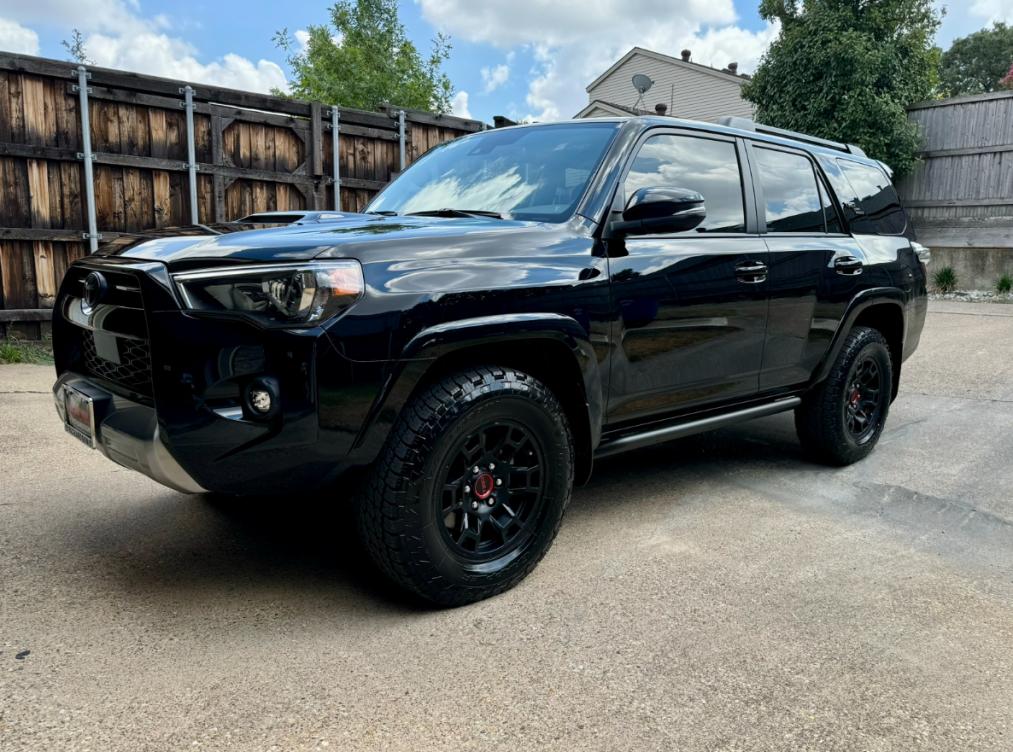

Some of the work y’all are doing to your T4R is pretty cool to follow along - can’t wait to do some of it myself when the time comes. That may be a while though because of what I just did to my 5th gen…just brought it home for the first time. New ‘24 TRD ORP. I have put about 40 miles on it in the last 24 hours, so she’s up to 50 on the odometer now.

so shiny and new

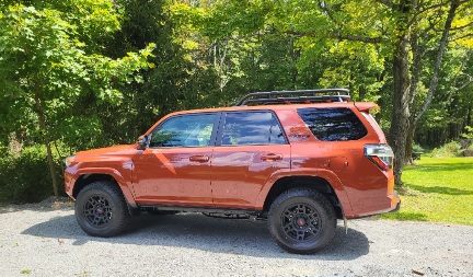

So far I've added RCI skids, back seat protectors, interior full LEDs, LED reverse lights, glove compartment/center storage organizers, center storage pad/cover and TRD Pro wheels w/ GG ATX tires in C load. Ordered, but still awaiting Westcott sliders and the auto dimming dash sensor. I love how supported the 4Runner via the aftermarket, it's insane
Edit: Almost forgot, LFD crossbars with a mounted River Quiver for fly fishing

The install of this 6.5 Optimizer diesel seemed to fight us all the way to the end. Almost the next to last thing to install was the exhaust crossover pipe. I ended up dropping it and it hit right on my cheek bone, imparting a nice cut. It was not deep enough to suture it, but deep enough to use surgical crazy glue (aka JB Weld).
Anyway, we got it lit and now it is purring. Already did the first oil change after 30 minutes. Will start putting some miles on it tomorrow.
