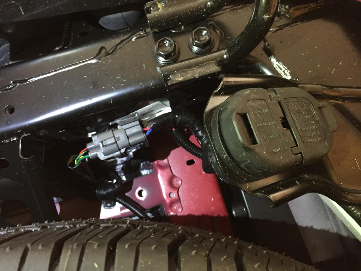

Installed these LED floods as backup lights.
Like this!

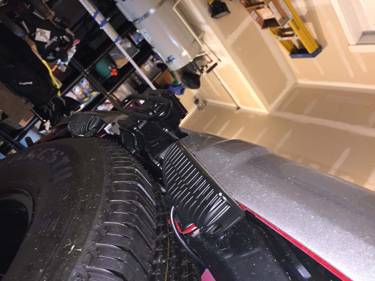

Can you take a photo of where you mounted them?
I used the existing bumper bolt.
Wired them to the trailer harness
They are bright
so do they light up only when you pop into reverse or can you turn them on if need be? also how exactly did you wire them to the trailer harness? thanks in advance
They come on automatically when you shift to reverse, I did not wire them to a switch but its possible, there are some wiring diagrams on this forum that show how to do it. I just wanted them to come on without me having to do anything special.
I wired them to the the reverse and ground poles on the 7-way trailer harness. There is a wiring diagram on the cover of the 7-way connector that will show you which pole to connect to.
The harness is mounted by 2 bolts and connected to the electrical system by 2 connectors that easily disconnect. I removed the harness and place it on the workbench. I opened up the wiring cover and traced the wires to a convenient location to splice into and soldered in the wire leads I needed. I re-wrap the protective cover over the wires. On the other ends of the 2 leads I crimped on male blade connectors. Then I re-installed the harness in the vehicle. Now I had a pigtail ready to connect to when I installed the lights.
you can see most of the work and the wiring diagram on the cover in the picture. I was very careful to seal up and insulate all the connection. All in all it was very easy.
