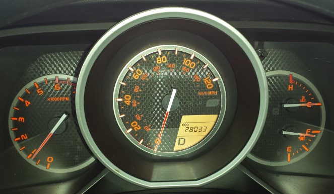

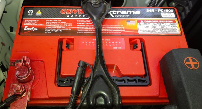

She just turned 4.............where does the time go?
Treated her to a swanky dinner.............tank full of "Top Tier" 91 octane, and a night on the town.

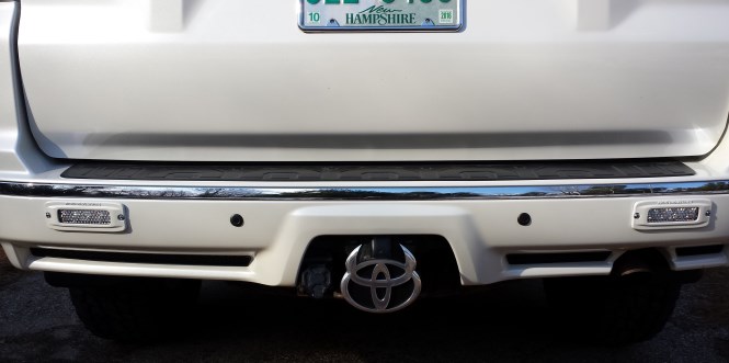

Early B day gifts included new battery and rear lights, nothing but the best for my baby!

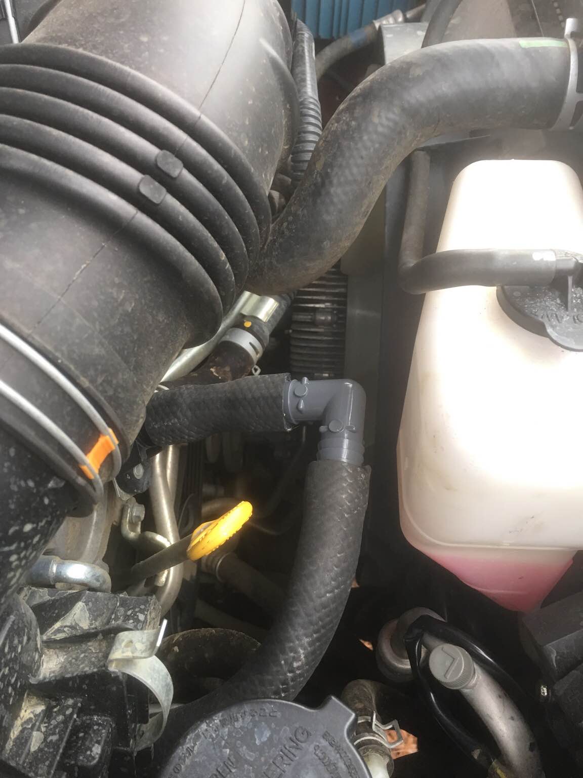

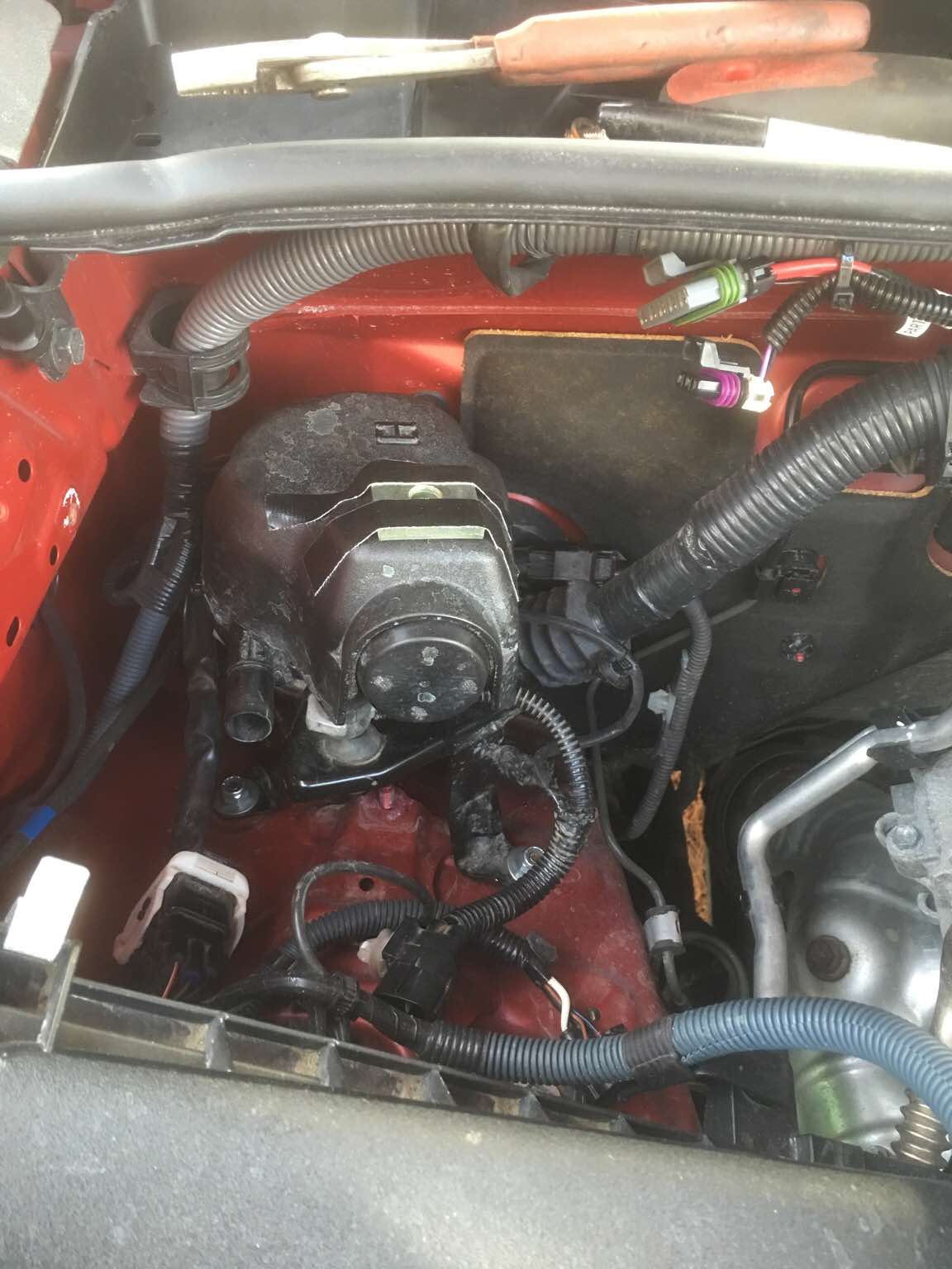

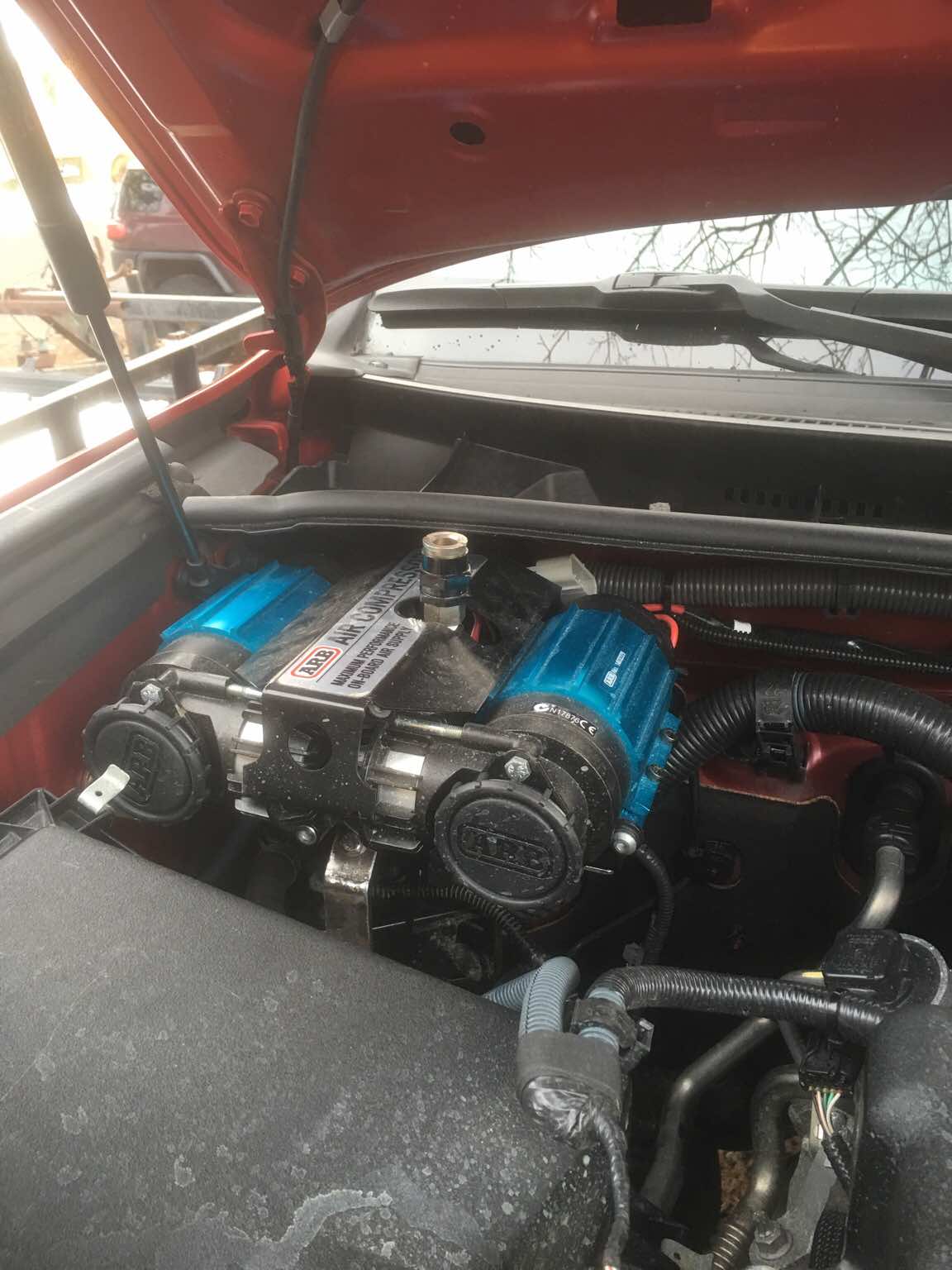

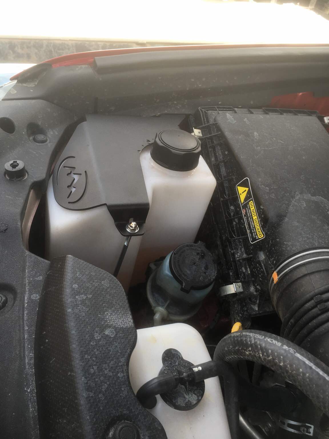

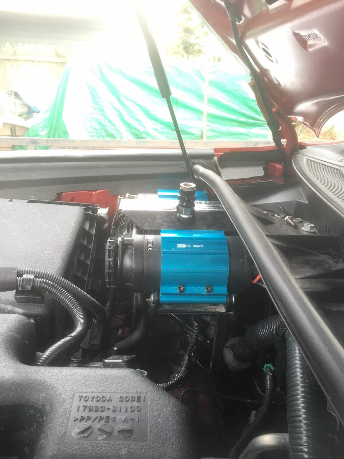

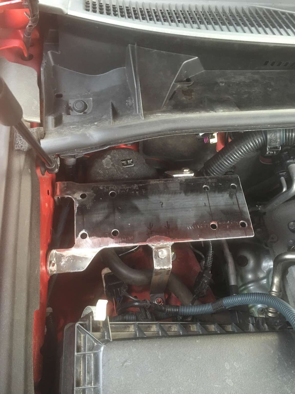

Had a custom mount made by [MENTION=125603]bandi[/MENTION]. In order to instal expedition one windshield washer reservoir the air pump needs to be relocated in the empty spot at the passenger fender unfortunately that's where my ARB twin compressor was. In order to properly relocate everything [MENTION=125603]bandi[/MENTION] made a custom mount for the ARB compressor that allows for the air pump to be under it. I'm very pleased with the results [MENTION=125603]bandi[/MENTION]'s work is truly top notch.
Also I should mention that expedition one air pump relocation kit sux and you're better of piecing the hoses and connectors yourself.

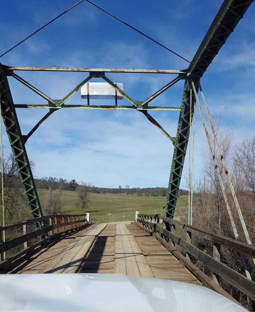

Went for a ride to Beale Falls and did a nice hike. Came across this bridge on the way out. Should have stopped and got a better pic, but food was calling.
