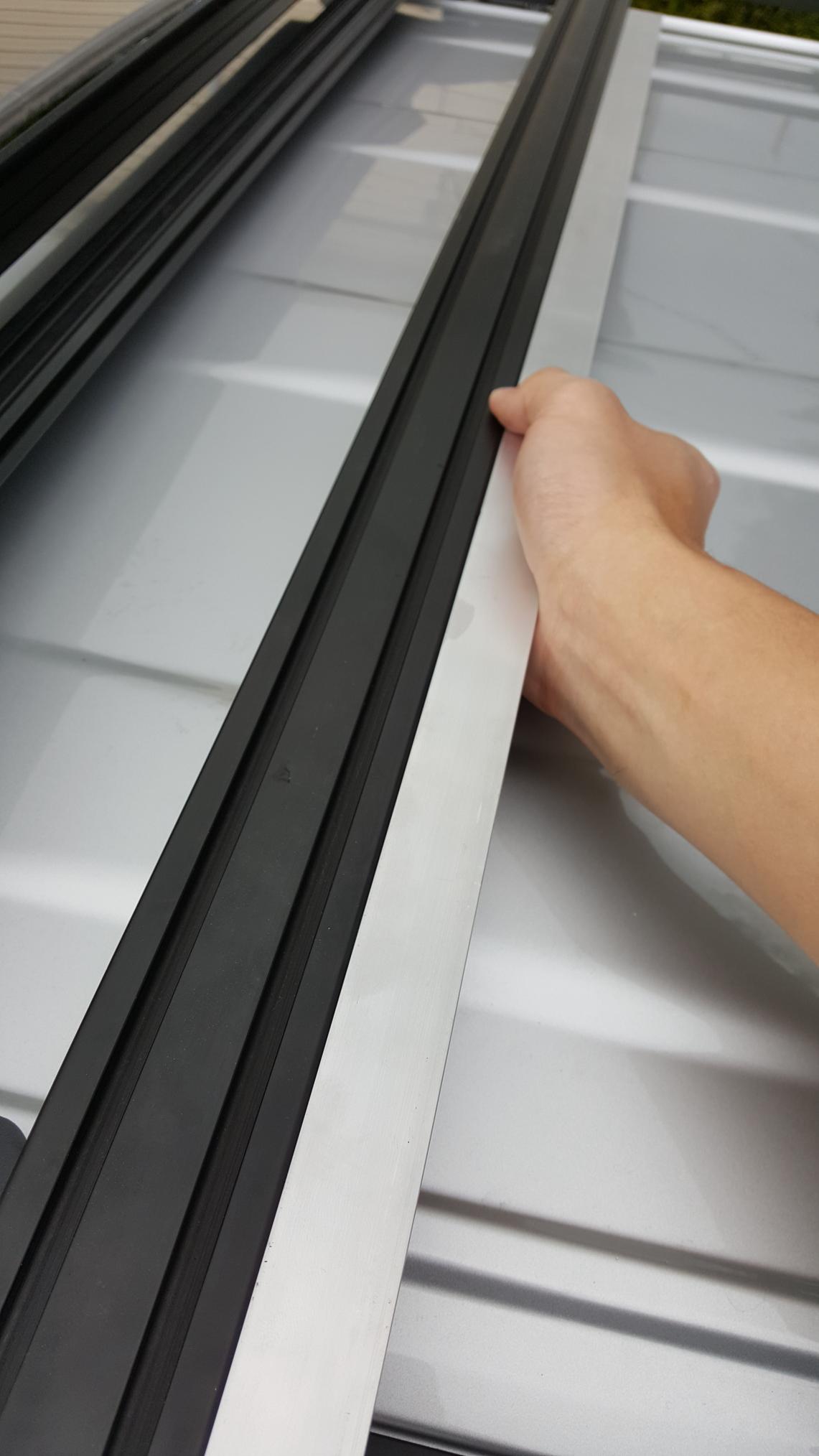

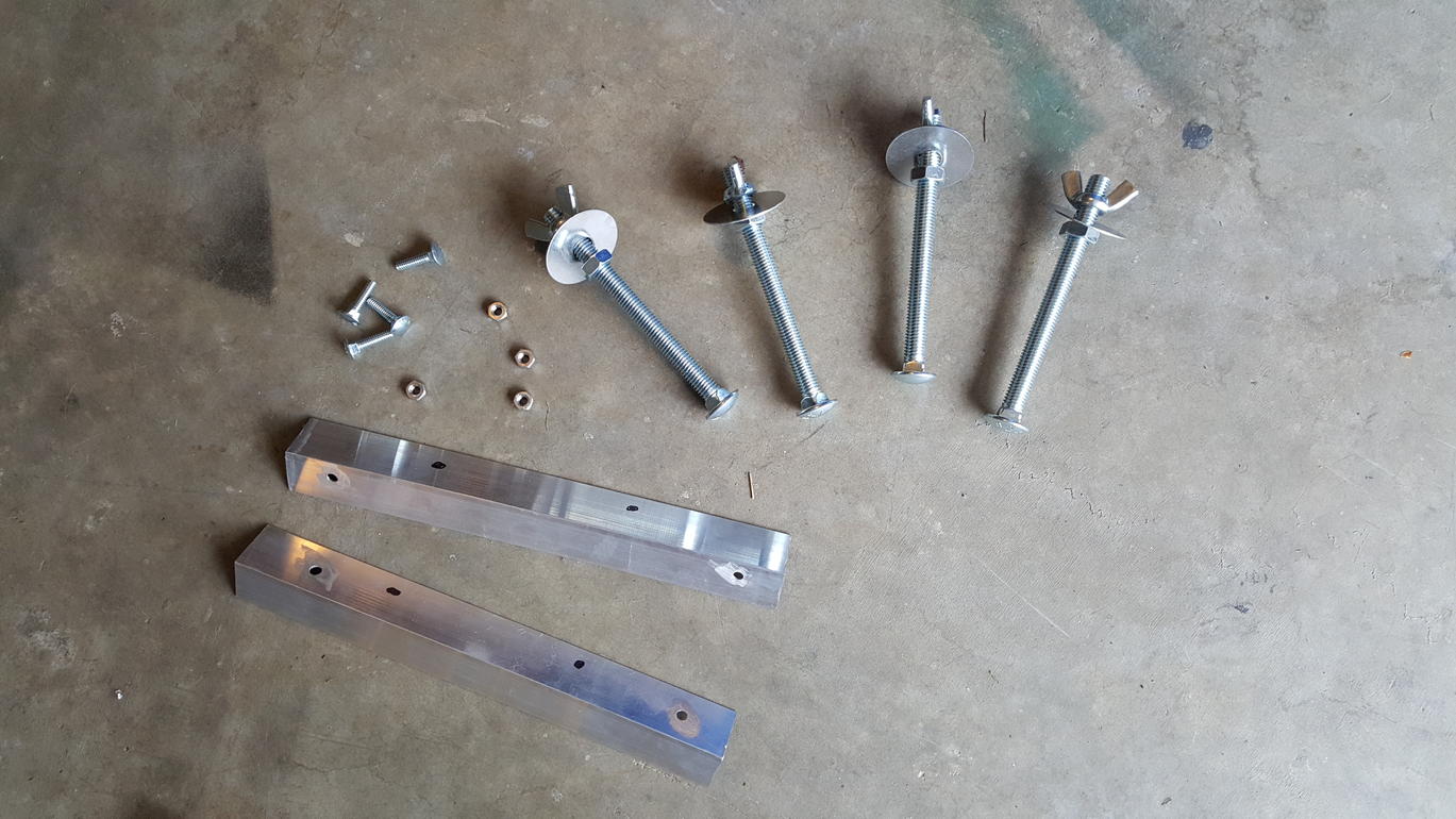

I jused the following:
1-1/4" aluminum angle, cut to TRED width. One for the front holes and one for the rear holes.
4x 1/2 x 6 carrier bolts
4x 1/2 nuts
4x 1/4 carrier bolts
4x 1/4 washers
4x 1/4 nuts
4x SS 1/2 washers
4x 1/2 wingnuts
I put the aluminum angle against the crossbar slot, measure and mark. Drill my two holes. Do this for both angle pieces.
The 1/4 carriers bolts slide perfectly through the crossbar slots. Put my freshly drilled angle piece onto the two bolts per bar. Screw the nuts on to secure the brackets then place TRED on top, mark the holes. Then take 1/2" drill to make your holes. Slide your 1/2x6 bolt and tighten nut and put it back onto the bar. Put washer, nut, tighten and repeat for the other bar.
If you have everything measured right the TRED holes will line up perfectly.

I haven't seen a Gobi personally but I'm sure you can build something. Maybe some type of U bracket that can hang off the side of the rack tube then attach a modified version of my bracket.

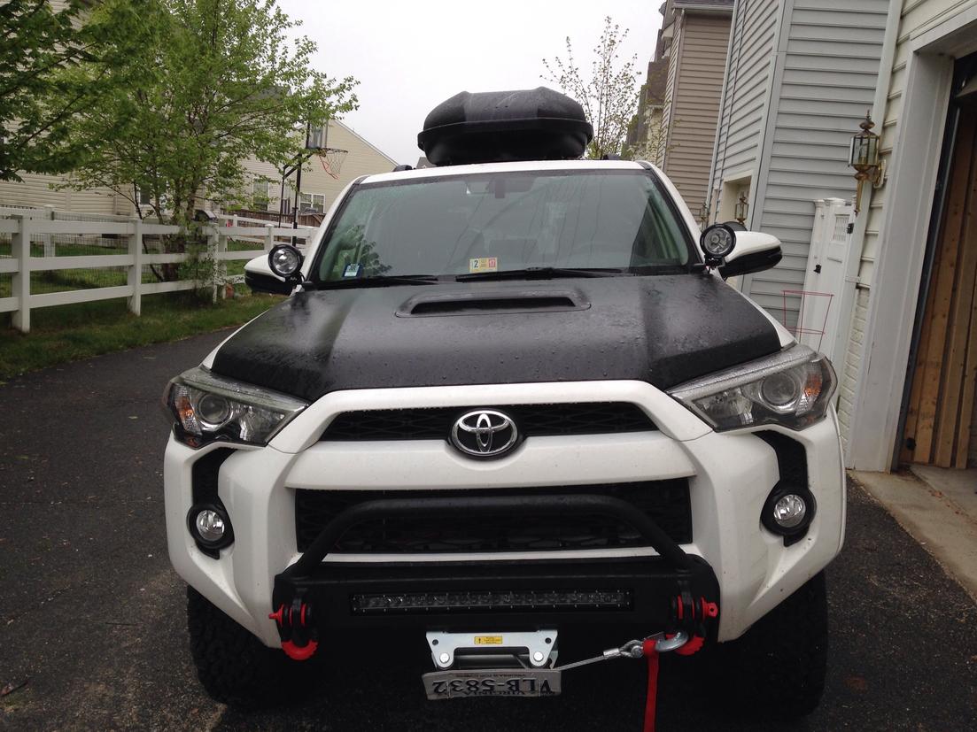

Installed CBI A-pillar brackets and VisionX Light Cannons. Simple install and looks great.

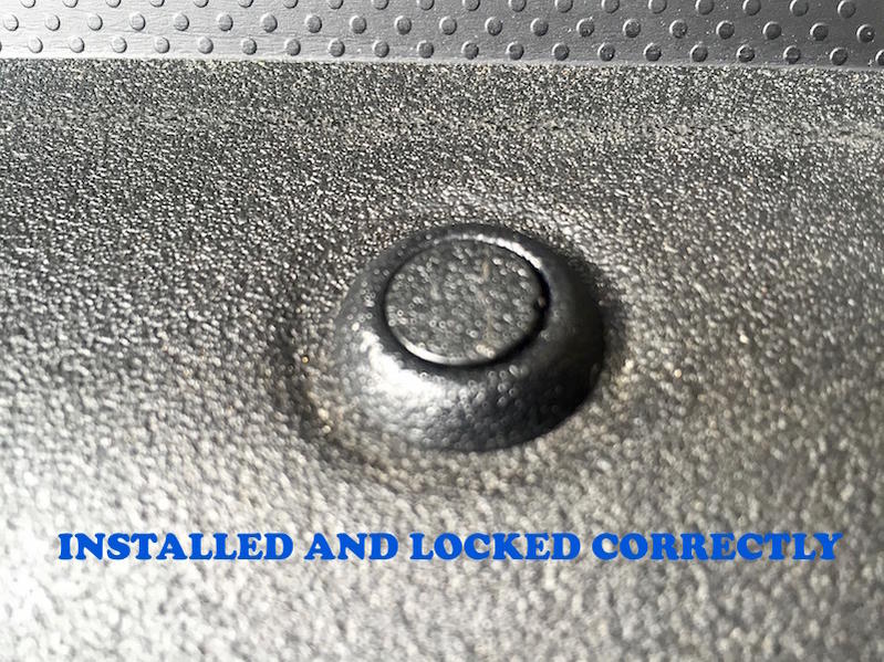

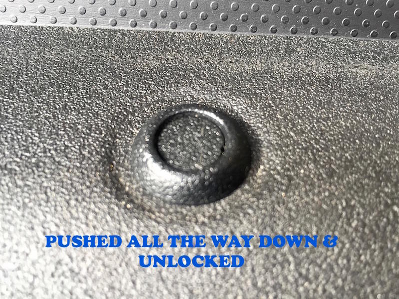

Repositioned my Hella horns for more volume and, at the same time, figured out how to remove these clips in the cowl panel above the radiator without using a sharp pointy object and how to make sure they're locked in snug instead of rattling around loosely in the trim.:thumb:
Though this is probably common knowledge, if you press them down so they are recessed like the first picture, the cowl panel and clips will lift off. Of course, you have to later press the nail portion back up into the clip for reinstall. Then as you put them back in, only push the nail down until the first click, flush with the top of the clip like in the second picture. This puts maximum expansion on the clip to hold everything in place.
I hope you all are as amazed as I was. :lmao:

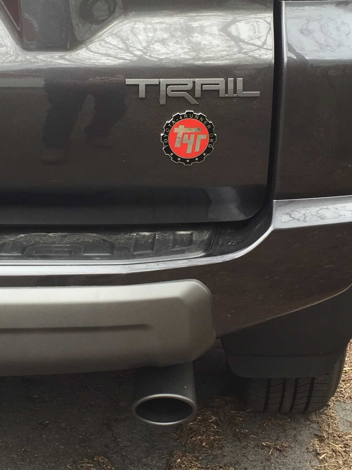

Got my T4R.ORG sign!
My T4R.ORG sign arrived in the mail today, so I put it on the rear window. I ordered two of them, one in silver and one in white, so I could decide which would look best. I picked the silver:
I also added a RiffTrax sticker to the rear hatch. :) I put the sticker on flexible magnetic sheet and trimmed it to shape. This way the sticker won't mess up the paint, and I can move it or replace it when needed:
