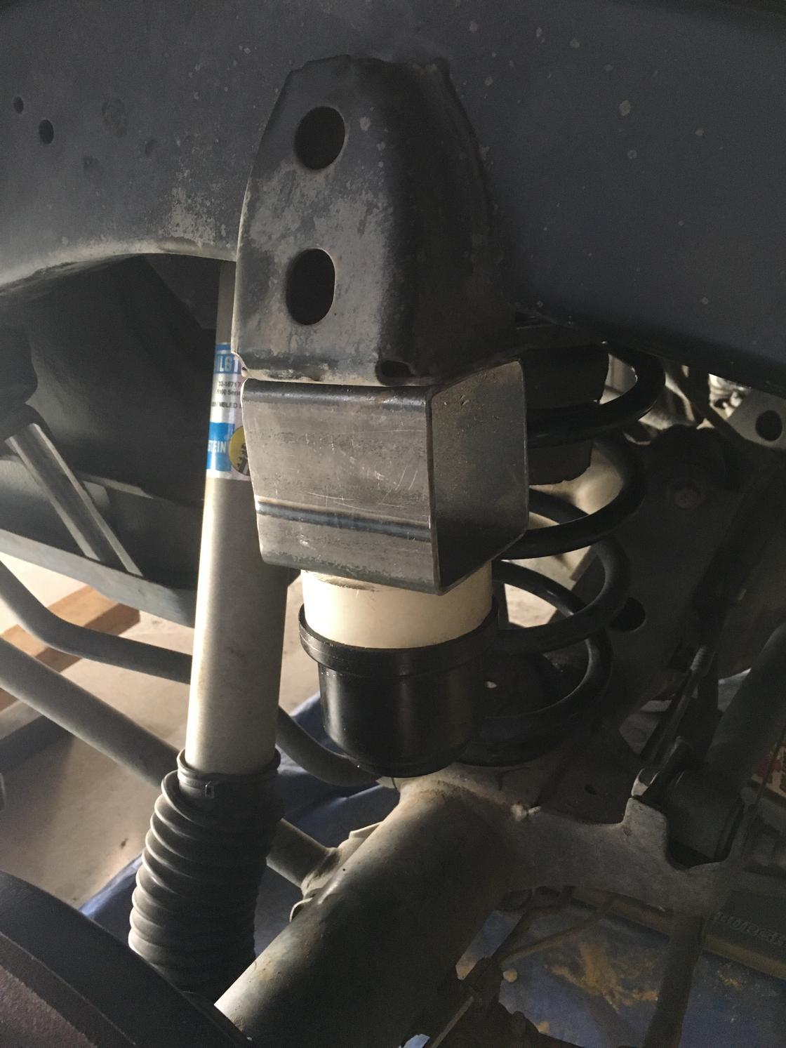

Installed 5th gen 5100's with some Wheelers Superbumps. Also did the rear diff breather extension while I was under there.
