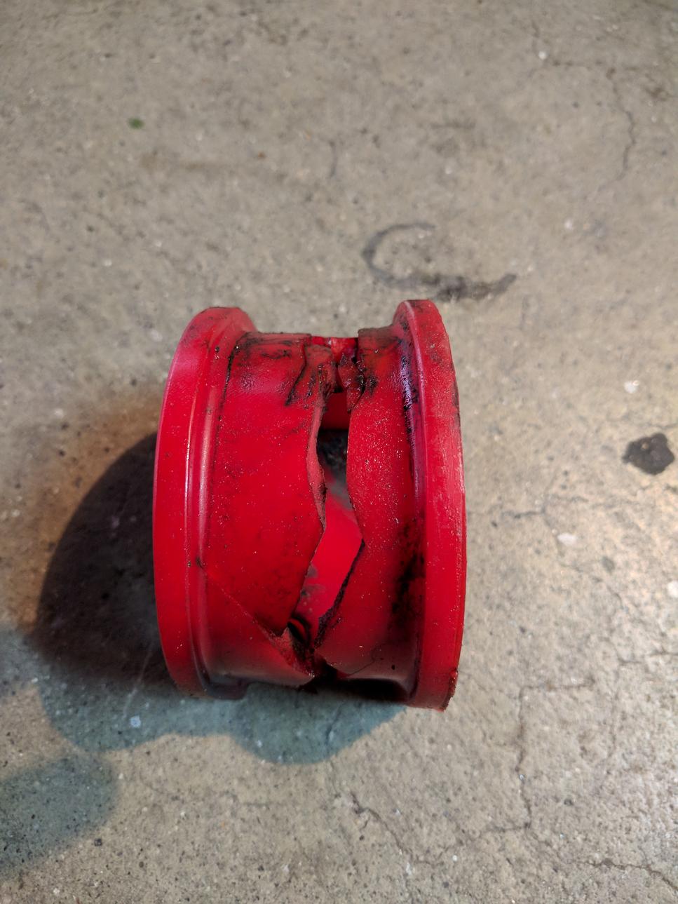

I took the Runner back to the dealership because it handled like crap after getting an alignment yesterday. They were supposed to put it back on the alignment rack, check their work and bring me into the shop to show me the screen because they "can't" do a print out of the alignment.:rolleyes:
I get called back and find the runner up on a lift along with a different tech showing me some worn steering rack bushings and telling me that's my whole problem, and that I'd have to replace the whole rack because Toyota doesn't sell just the bushings.

[MENTION=175725]2ndhandyotaman[/MENTION] Definitely just replace the bushings! The poly ones that octanejunkie linked to are great.

Hmmm. I saw the Energy Suspension bushing kits, black or red. I'm going to guess that the color shouldn't matter, although back in the day- their black bushings were graphite impregnated to help with the squeaks. How many miles are on those busted bushings?
Roughly 7000 miles on them. It busted when I was wheeling one of the hardest trails in my area. Iol
