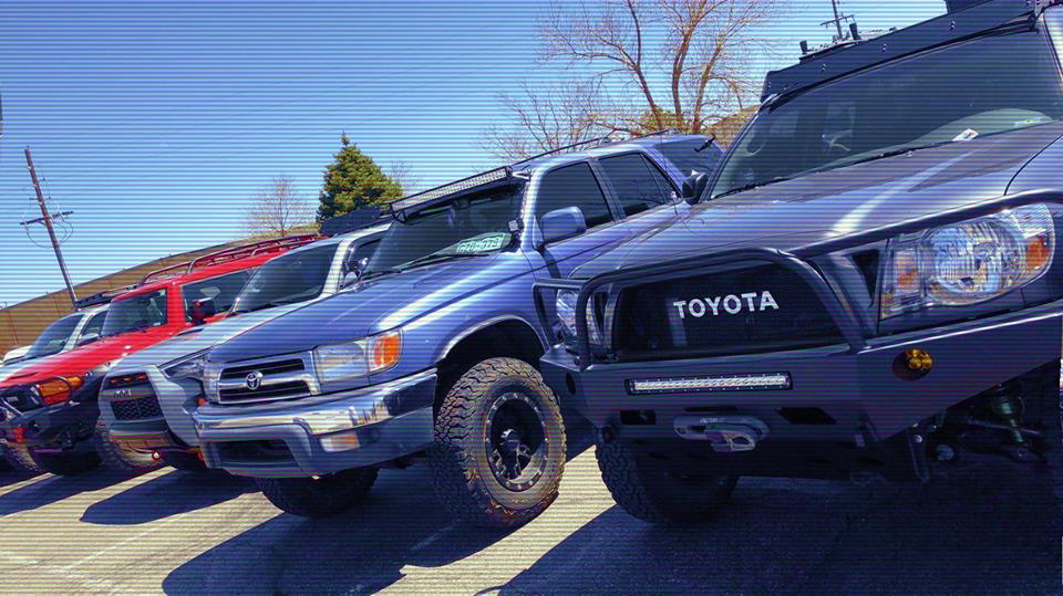

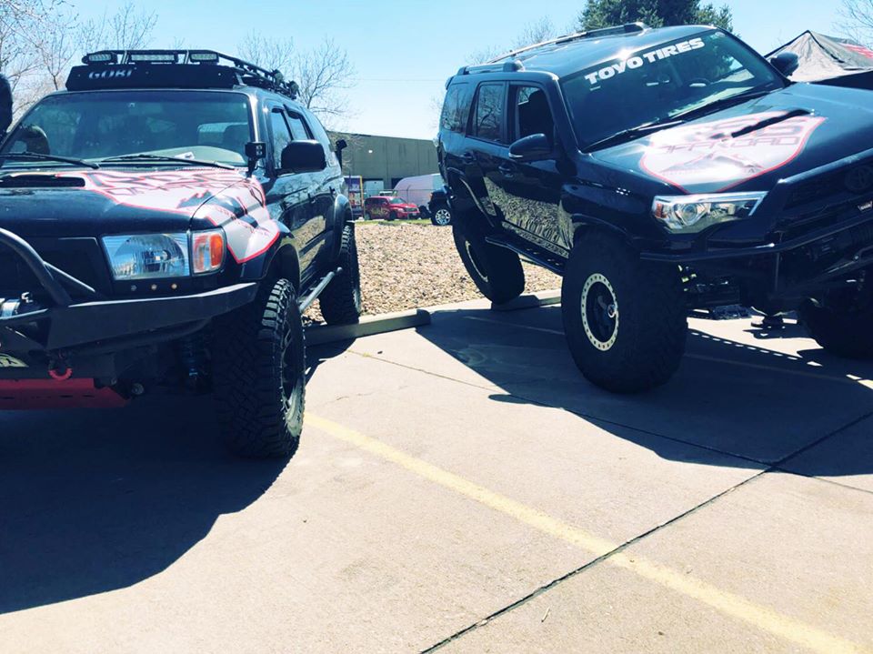

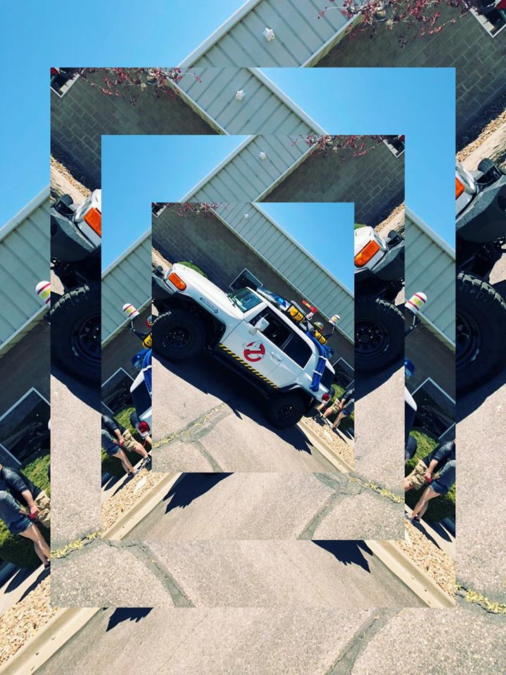

Sparked some ideas from sweet rigs last weekend in Denver.

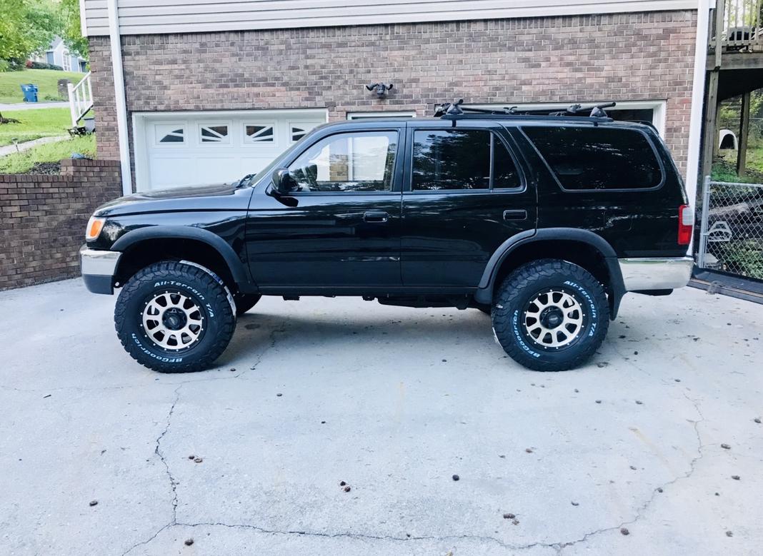

Finally pulled the trigger on the lift.
F: Tundra 5100 & OE Coils on 5th Perch
R: Tundra 5100 & LC 8 Wraps
I love the feeling of fresh struts (the OE struts were 100% shot).
Looks a little too high up front. I think in the 3rd gen FAQ are some standard measurements of what’s acceptable before you start breaking stuff. It looks like you maybe have 1” of down travel?
I think i am under 2" of front lift, but it is hard for me to visualize because it was sagging since I've owned the truck. I will go take a hub to wheelwell measurement to be sure, but it never came to mind that I would be pushing it with the OE coils.
FWIW, it is a temporary measure for me to get my 5100's on the truck and replace the totally dead rear coils with the LC's i had laying around. The front coils will be getting swapped with Toytecs or TRD's (If I can actually find a set) pretty soon.
edit: Just measured- F: 23" R: 24 1/4" -Thats way more than I thought.

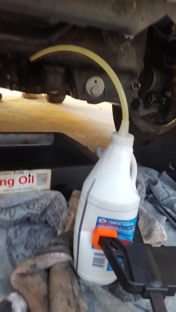

Finished up the new rear axle bearings, seals, brakes, shocks, diff fluid, then did the front diff fluid..... with my redneck fluid pump.
