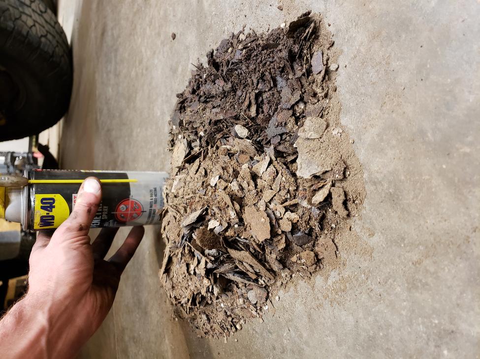

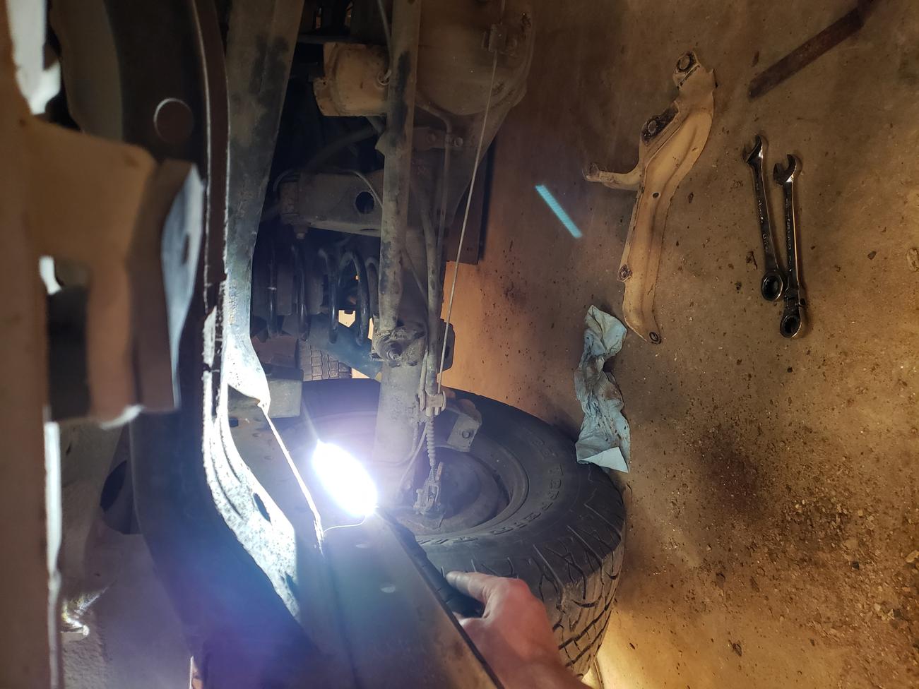

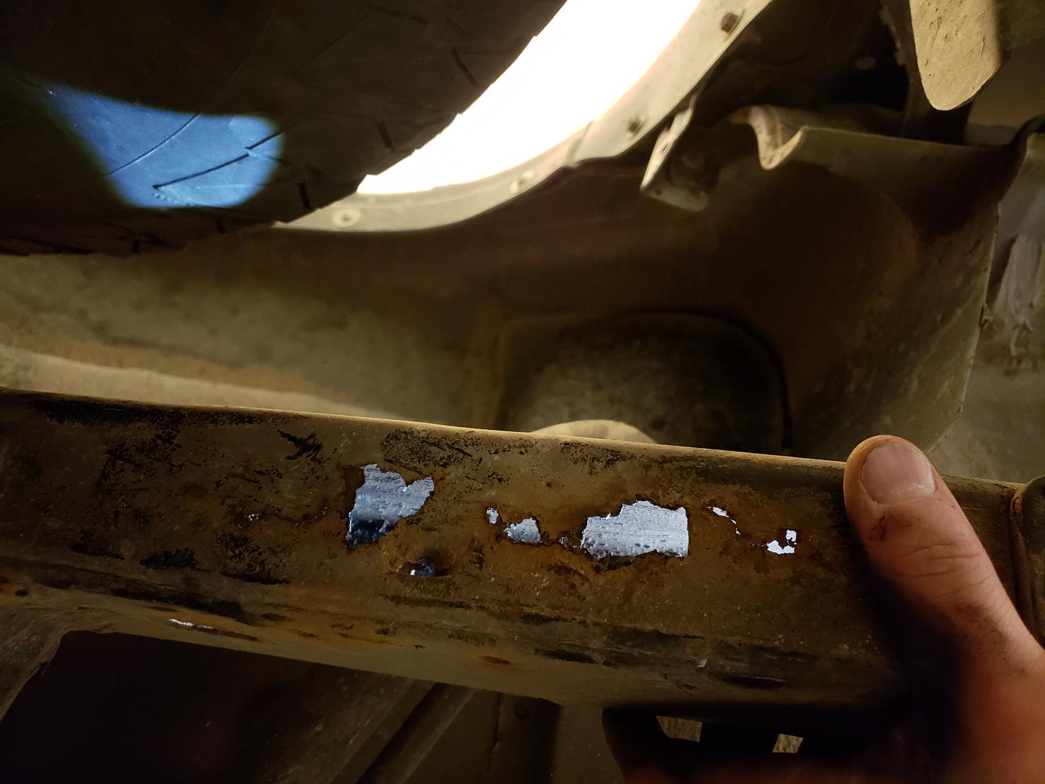

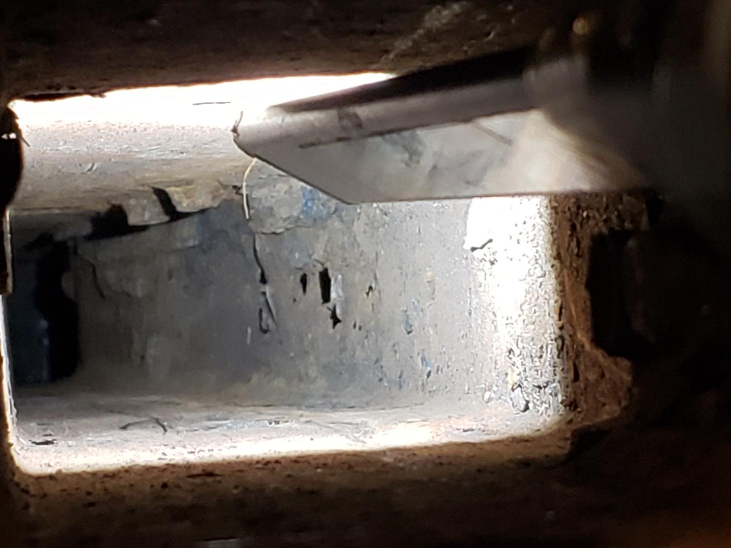

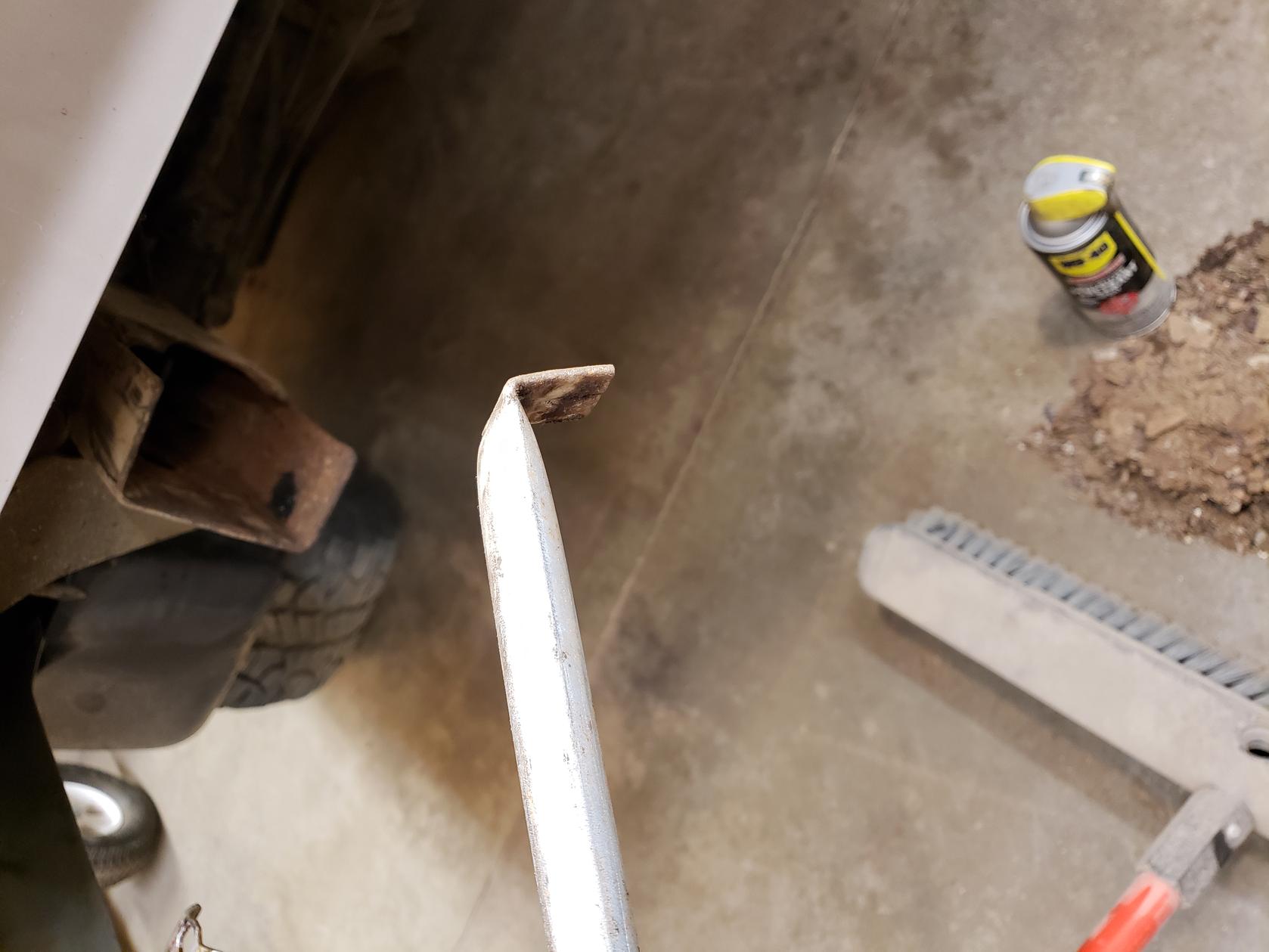

Well I wanted to get installed a 2nd trim packer on the driver's side last week before I take it in for a needed alignment. I also wanted to get the trim packer in before I drench everything in Fluid Film for the winter. Old man winter is knocking! While I was creeping around on the creeper I noticed a possible rust hole in front of the hitch mount on the driver's side. I then decided to removed the rear bumper and hitch so I could get a better look inside of the frame. I found a lot of flaky rust and sand. Much more debris on the driver's side than the passenger's side. I pulled most of it out with a 5' piece of conduit that I bent a 90 on. After it was relatively clean I smacked the underside with a rubber mallet. This broke up a lot more rust and exposed the holes. Luckily this is all repairable. Moral of the story for the rust belt dwellers is to keep the frame cleaned out as good as possible. Leaving a lot of sand and dust in the frame traps moisture and we all know what comes next.
