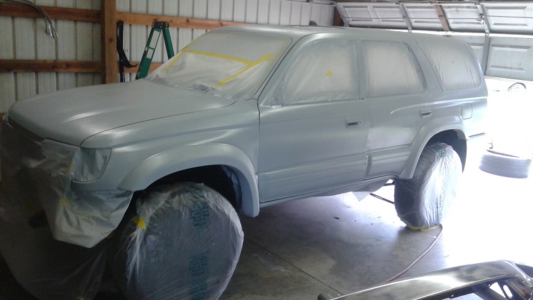

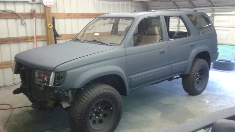

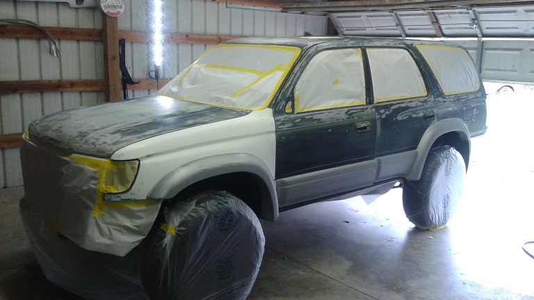

Finally got around to getting the flares back on. Put some ProComp 7069 wheels and Falken Wildpeak tires on it. Trying to get this thing sprayed in the next couple of weeks.
