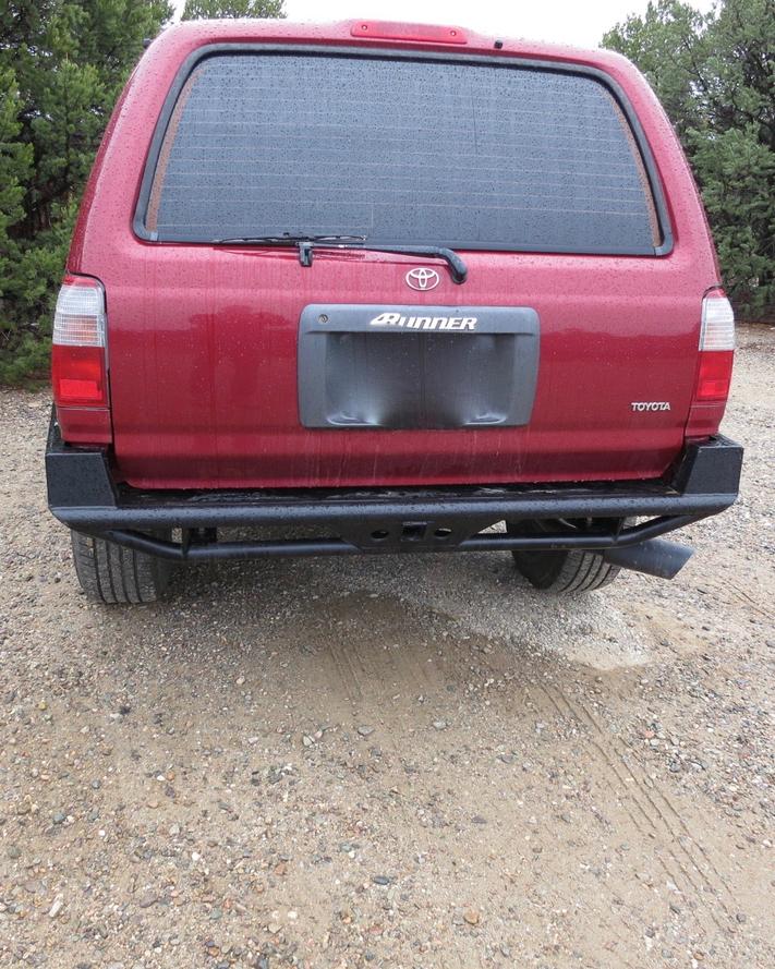

I just received my Tracking #'s for my 4xInnovations rear bumper, 3 weeks to build, And an estimated delivery of this Friday. And Adam has answered every Email and Phone Call.
I had some custom things done, and even received the Forum Discount.
:rockon: :rockon: :rockon:

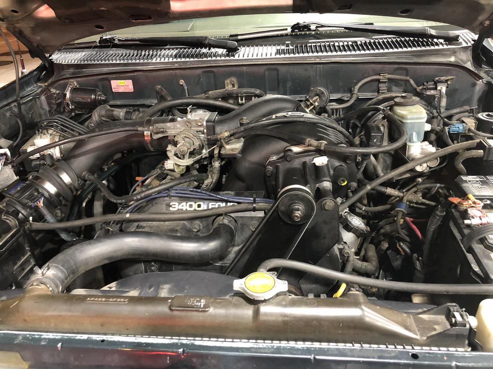

just something that needed to be done a Long time ago and has really helped the engine's performance, a new air intake 'hose' and sealed up a couple cracked vacuum lines - what a difference! :cowboy:

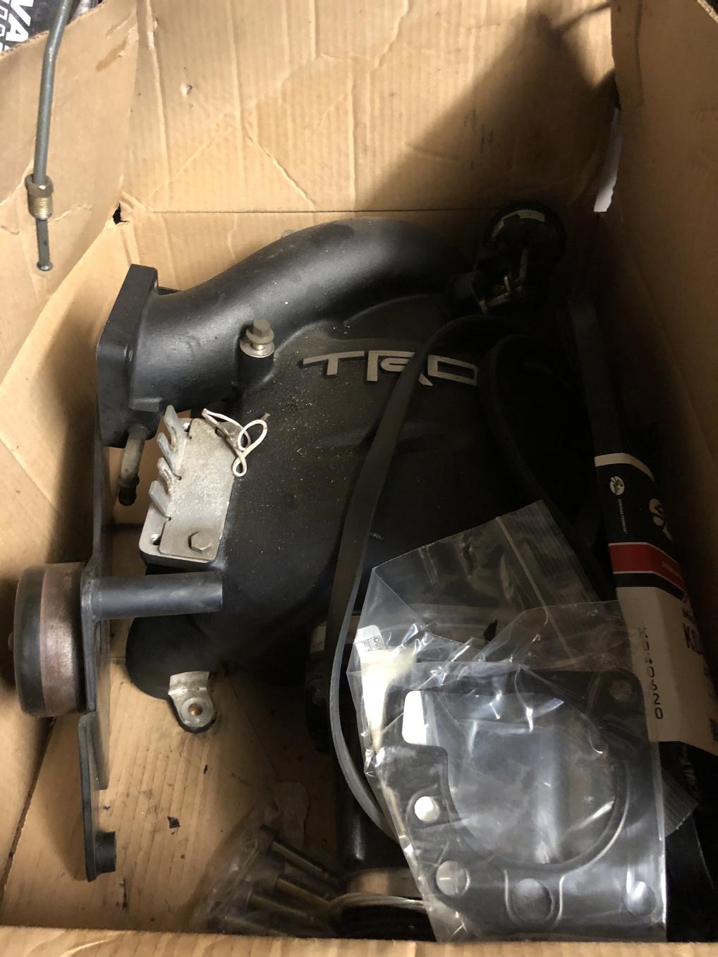

Did a thing with a buddy this past weekend.
I know my brake fluid looks nasty, hoping to get the TBU and new OEM LBJs installed this weekend.

Considering that looks like the original radiator and I don’t see a clutch fluid reservoir, I hope there will be a radiator swap forthcoming unless it is bypassed.
How much for the SC if you don’t mind me asking?
Yeah, new rad coming soon as well. Good eye on spotting the rad. Originally we agreed on $1100 including some civic suspension parts I had left over from an accident. I didn't know how bad the damage was to it so after he examined them and found significant damage to where it'd be best to just buy a new one we agreed on $1700 for the SC. Still need to install a/f and boost guage.
I was in the same boat but went the ebay $14 ko route on that top knuckle :D
I found the rest of the hoses OEM for cheap except for that dang PVC hose, it was the single most expensive one lol
