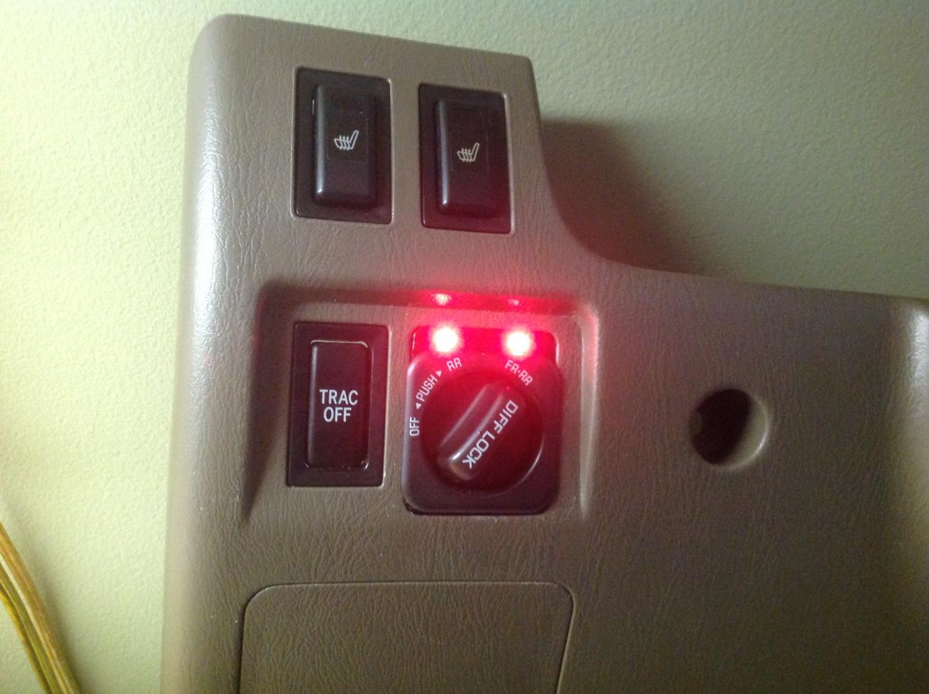

Locker ON indicator's final decision, finally.
Wanted gauge cluster indicators 01-02's use those open spots, what I came up with.
LandCruiser switch doesn't allow front locked only for dig's, circuit to allow this other half of this project.
After wheeling since June 20 as is, front dig option be useful.

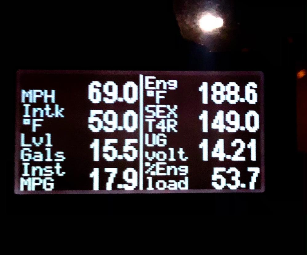

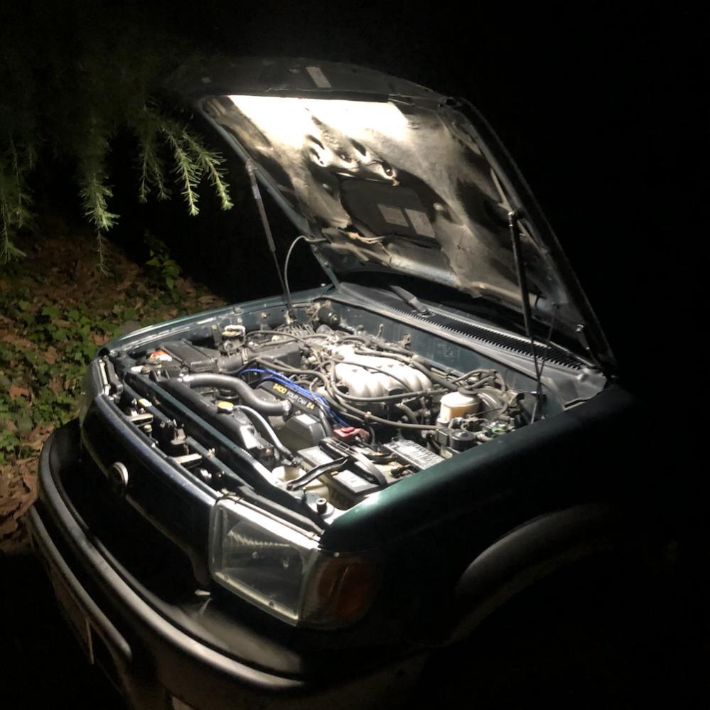

You could say I adjusted illumination in 3 areas
1. Added trans temp code to my UG
2. Swapped in some more-modern headlamp bulbs
3. Hooked up a Scarab under-hood LED strip
FIAT LUX

Tell us more about the under hood lighting. That looks excellent.
That is a little kit I picked up through a holiday sale at Opt Off Road a couple months ago. Pretty sure it's a product put together and sold by the young dude in the YT install video below. It basically tells you how to build your own, but a combination of crushing laziness and desire to support the young players, I bought it. I don't think Scarab has a sales site or reseller other than Opt but you can find him on IG @scarab.offroad
YT Install:
https://www.youtube.com/watch?v=ASFVwG7wpl4
LED is bright AF
Based in Colorado

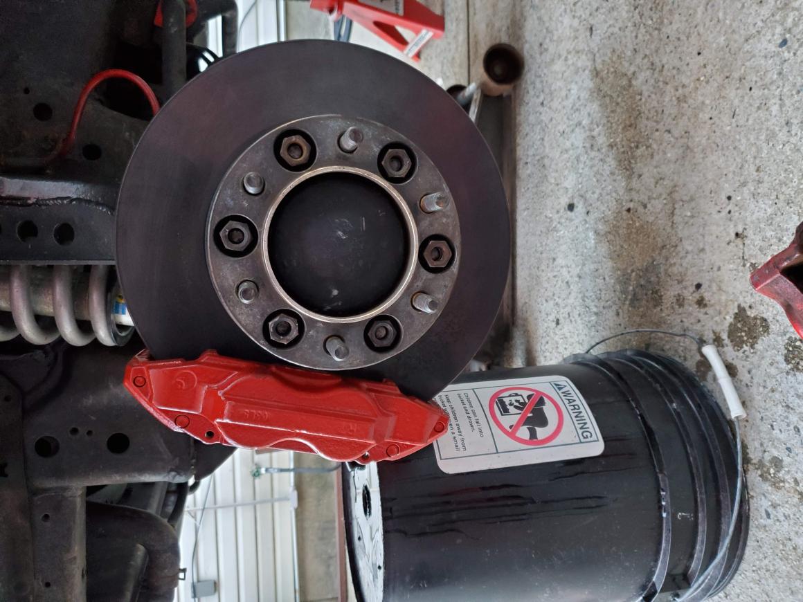

I finally got tired of my warped rotors. I also added speed bleeders. Night and day difference in stopping power. I've got an 02' and do not have the soft/extended travel brake pedal feel. I did bleed the system twice, the first using the traditional method and the last using Toyota Techstream to engage the brake booster electronically. Stops on a dime!
is that a TBU, cant tell from pictures. Also since the 2001 and 2002 is new to me, do you need a program to bleed the brakes ?
edit: watched MTBTM video on brake bleeding a 2002, he does not use a program so guess i dont need one.
YT Install:
LED is bright AF
Based in Colorado
Man, don't worry too much about not building your own. I looked into putting one together myself, and to get the quality/brightness of the LEDs he's using would cost almost as much as the kit! I'm a little jealous though. My lady told me not to buy anything for my truck before the holidays, and he sold out. So now I'm waiting for them to come back in stock to snatch one. Got some pretty sweet Spiker hood struts though. They make me grin every time i open my hood.
It is the TBU. I read that the extended or spongy brake feel can be caused by air trapped in the ABS module on 01/02s. The only way to fix the issue is to engage the ABS either by stomping on the brakes or using Techstream. I just want to do it right the first time because it's 30F where I live and it sucks working in the weather. I have access to Techstream so I used it. Techstream actually allowed the brake pedal to drop further to the floor than I could with my foot, so I'm going to assume it did a marginally better job at bleeding the system. Sure feels like it!

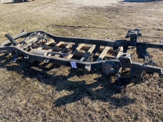

Donor frame has arrive. Up next, POR-15 treatment. I’ll start a build thread soon to document everything I can.

[MENTION=633155]cl4Rk[/MENTION] that is awesome! Have you seen The Durks thread about frame swapping?
Frame Rot!! Is this the end?
Thanks! Yes, I studied that thread a few times before deciding to go with a frame swap vs repair. It will be done at a shop with a big lift, so it should go pretty smoothly. The shop owner has done frame swaps before (Tundra, Jeep).
My current frame is nowhere near as bad as TheDurk's was before his swap. (I'll post photos in the upcoming build thread).
However, rust is a pretty big issue in my area, and since the rest of the truck is super nice, it's only got 200k miles, and since I don't wheel hard or really even drive much now that I work from home, I figure a full frame swap with POR-15 will give this truck a very long life.
