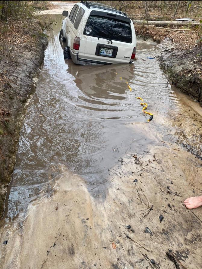

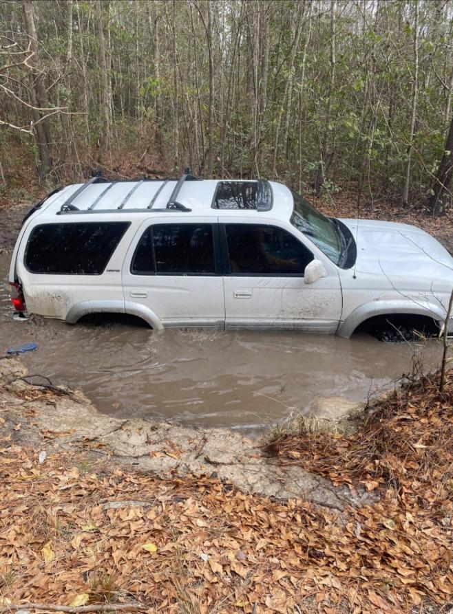

Got stuck for the first time. Dang Carolina sand.. always trust your first judgement, not the passenger that tells you "just gun it and you'll make it"

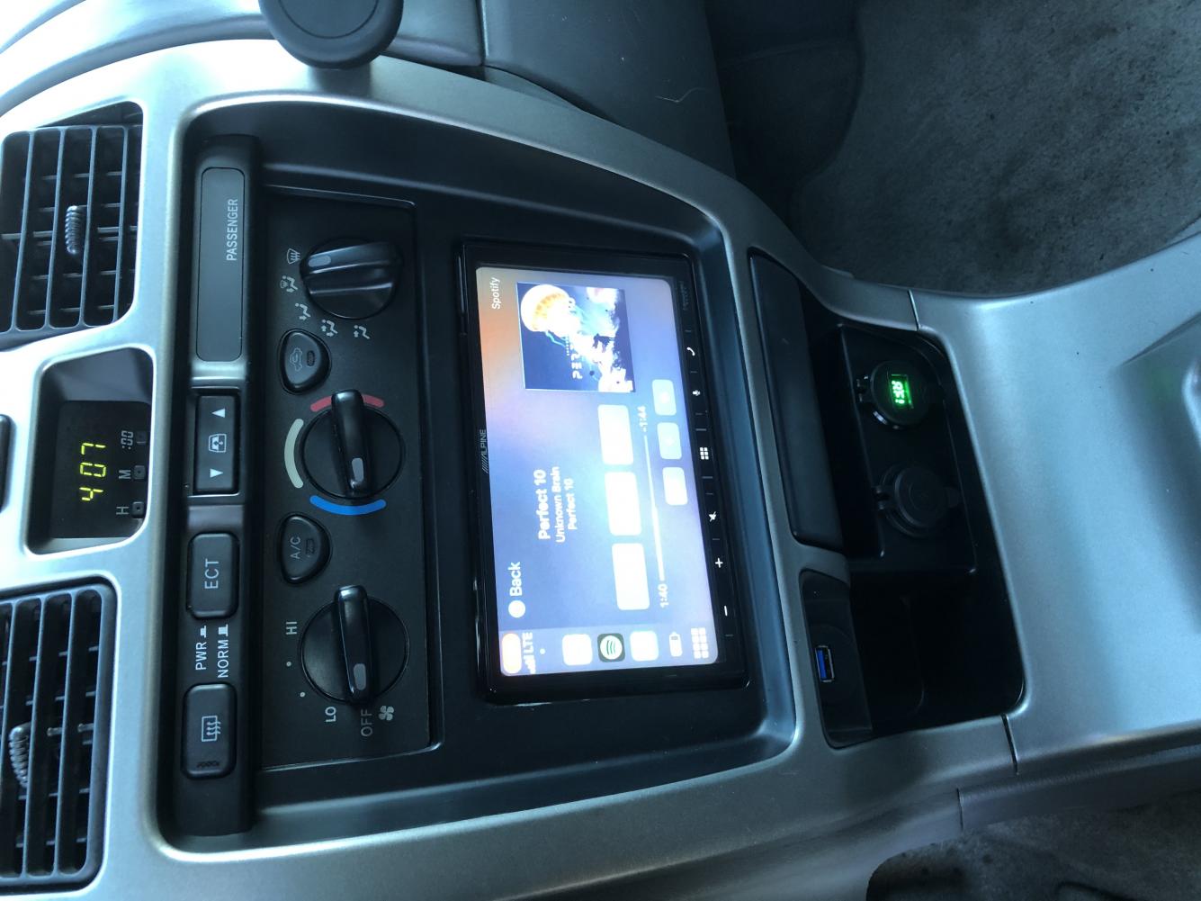

Alright folks, here's what i have today:
Alpine ILX-650
Wireless carplay dongle
Course motorsports magnetic phone mount
Dual 3.0 usb ports with voltmeter
Standard 12v socket
OEM BT mic from a Silverado gutted to allow Alpine mic to drop in
Tomorrow, I'll tackle the front and rear cameras.

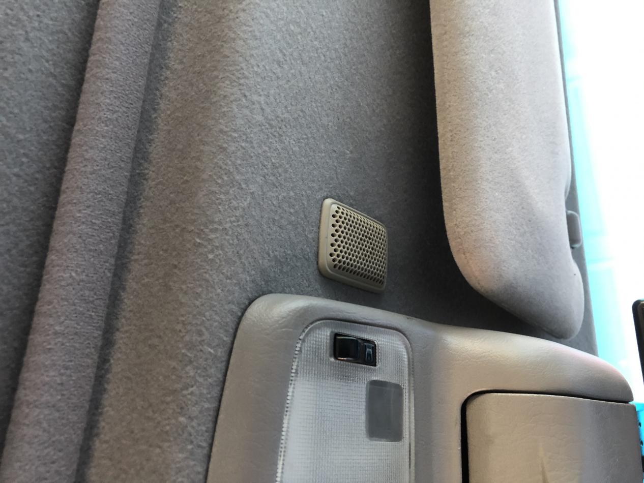

Nice integration of the microphone. That’s great work. Any idea where to source that particular mic?
Thanks. I got it from this seller on ebay. Headliner mounted bt mic. I had to install it on the passenger side of the sunglass holder as there is a metal bracket on the driver side.
I made several test calls with my sister and she said the audio is clear. One thing i did extra on the mic cover was drill out another round of holes with a 1/16 drill bit. The indentations are already there so just follow through it. Just wanted the mic to have more coverage.

Thank you! How did you adapt the wire? Can you just cut and crimp a bluetooth wire?
2014-18 Silverado & Sierra Headliner Mounted Microphone-Tan OEM# 23104659 | eBay
thnaks, prob one of the best mic mounts I have seen, thanks for the link, ordered one

I removed the OEM Chevy mic guts, carefully as there are several pieces. I drilled a hole through the backside until the Alpine mic can fit snugly. I filled the gaps with hot glue and that did a great job securing the mic straight. I wished I had taken photos, but was in the zone. It's really easy once you look at. You will need to cut out a 3/4 hole in the headliner and trim according to fit the base grooves. The mic cover snaps over the protruding base through the headliner.

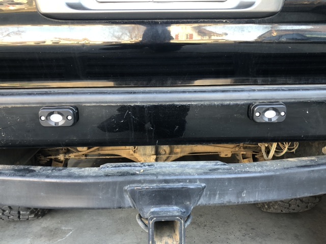

Installed some Harbor Freight lights in the rear bumper... we’ll see how they hold up
