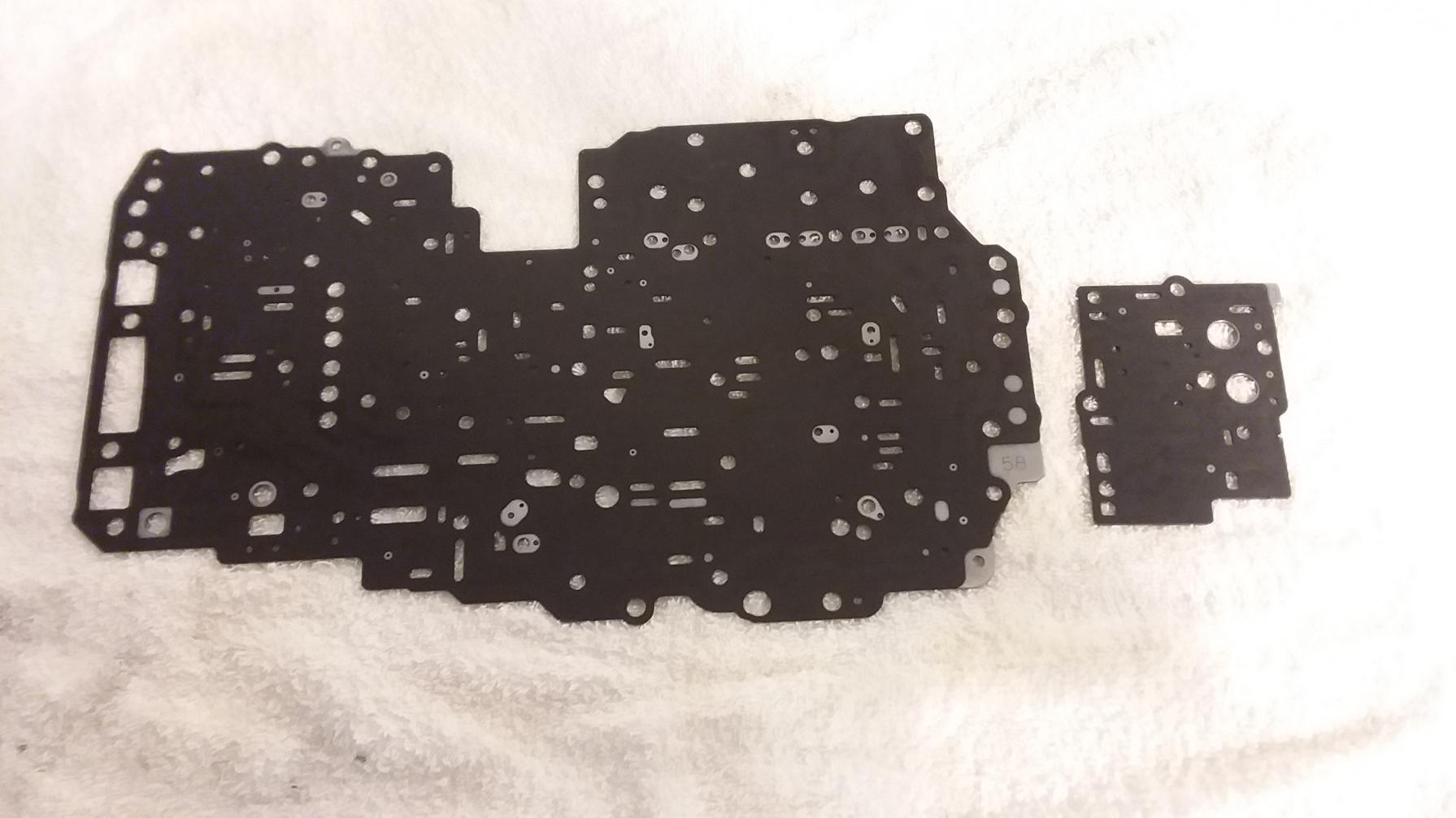

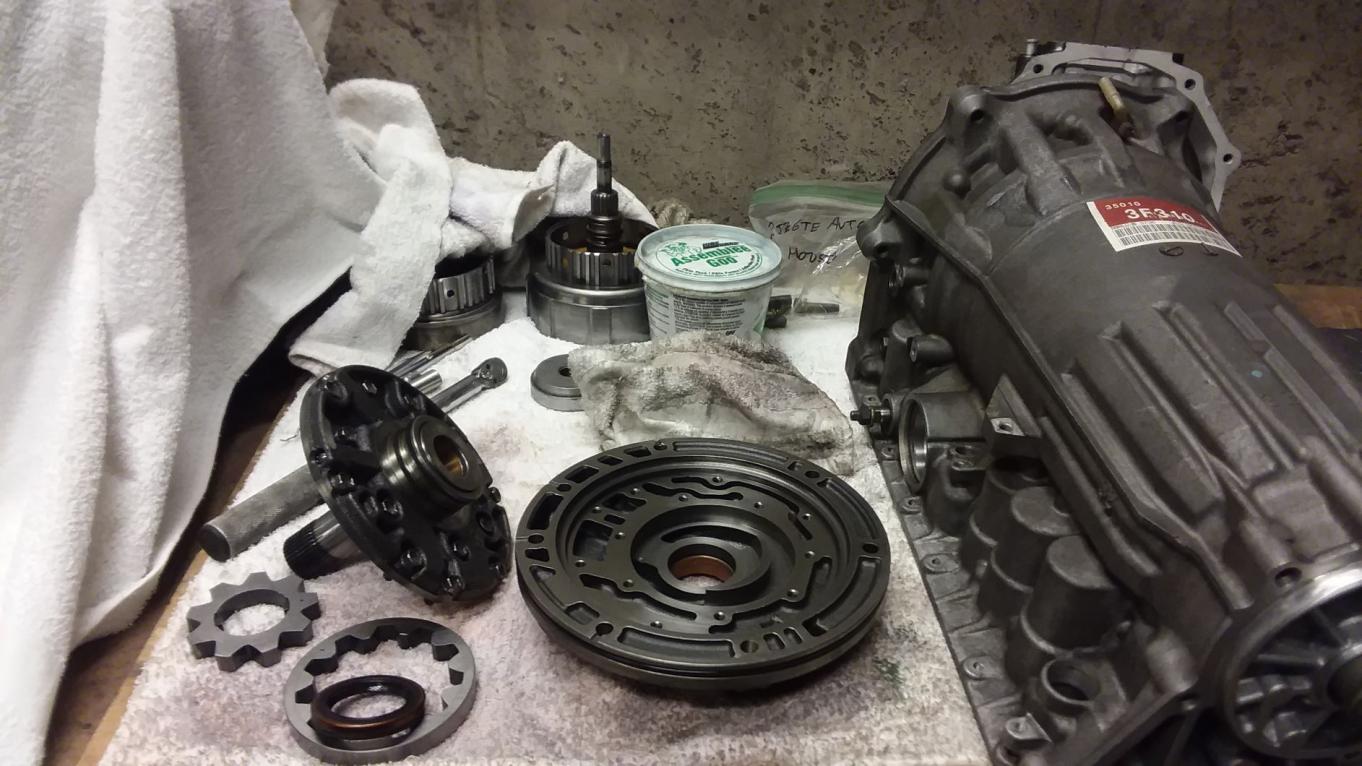

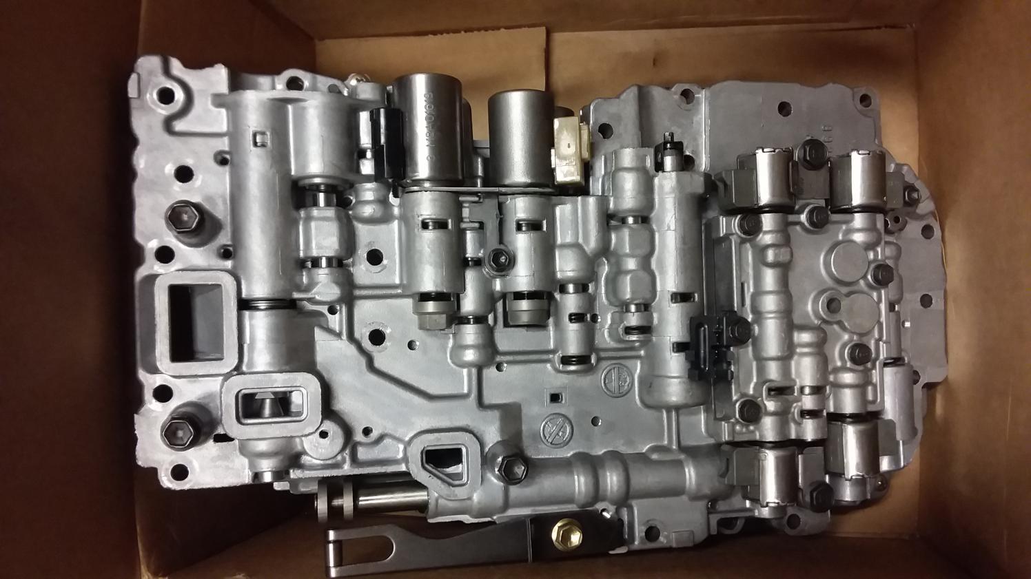

Drilled out the VB separator plate, went through the VB and did a few mods, cleaned, and checked the solenoids. Inspected the trans and started to resemble after having to remove and shorten the 2wd output shaft to adapt to a tcase.

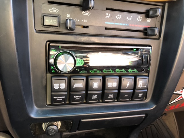

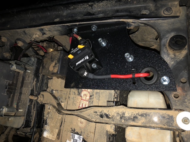

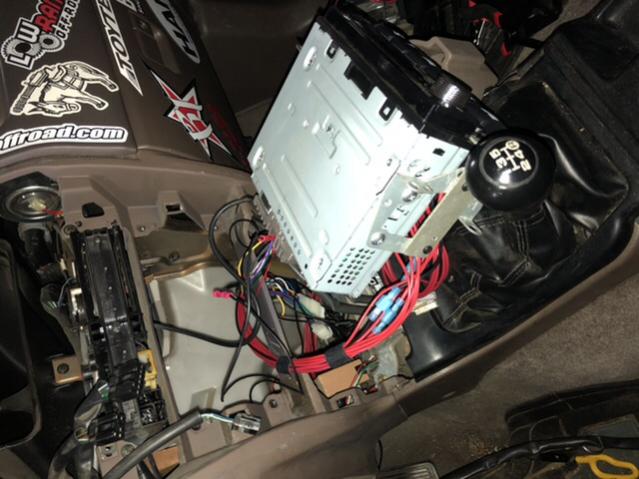

Finally made a bracket for the breaker going to my fuse/relay box, Mounted up my paranoid fabrications switch bracket, and put my power antenna on a switch

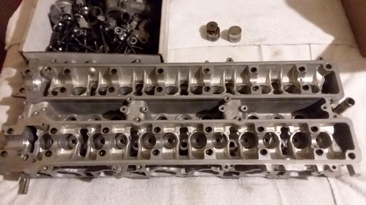

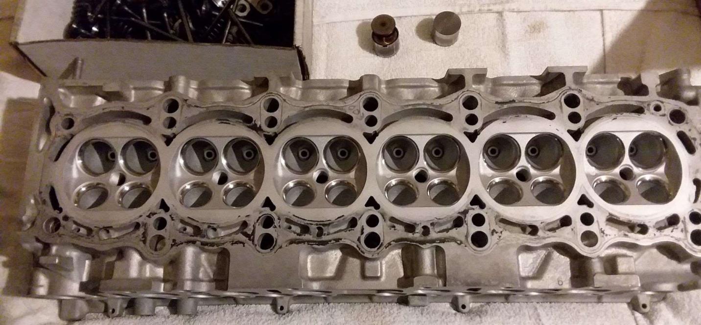

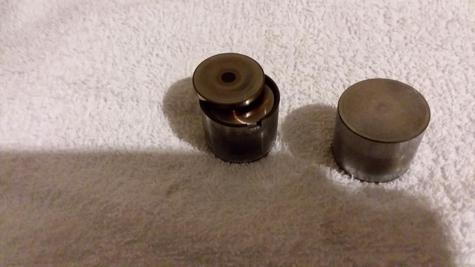

My low mile JDM engine needed a valve job. Decided to run with shimless buckets being that I have to do all the clearance work regardless and their lighter by a fair amount which adds up with 12... worked out some of the measurements and math for said.

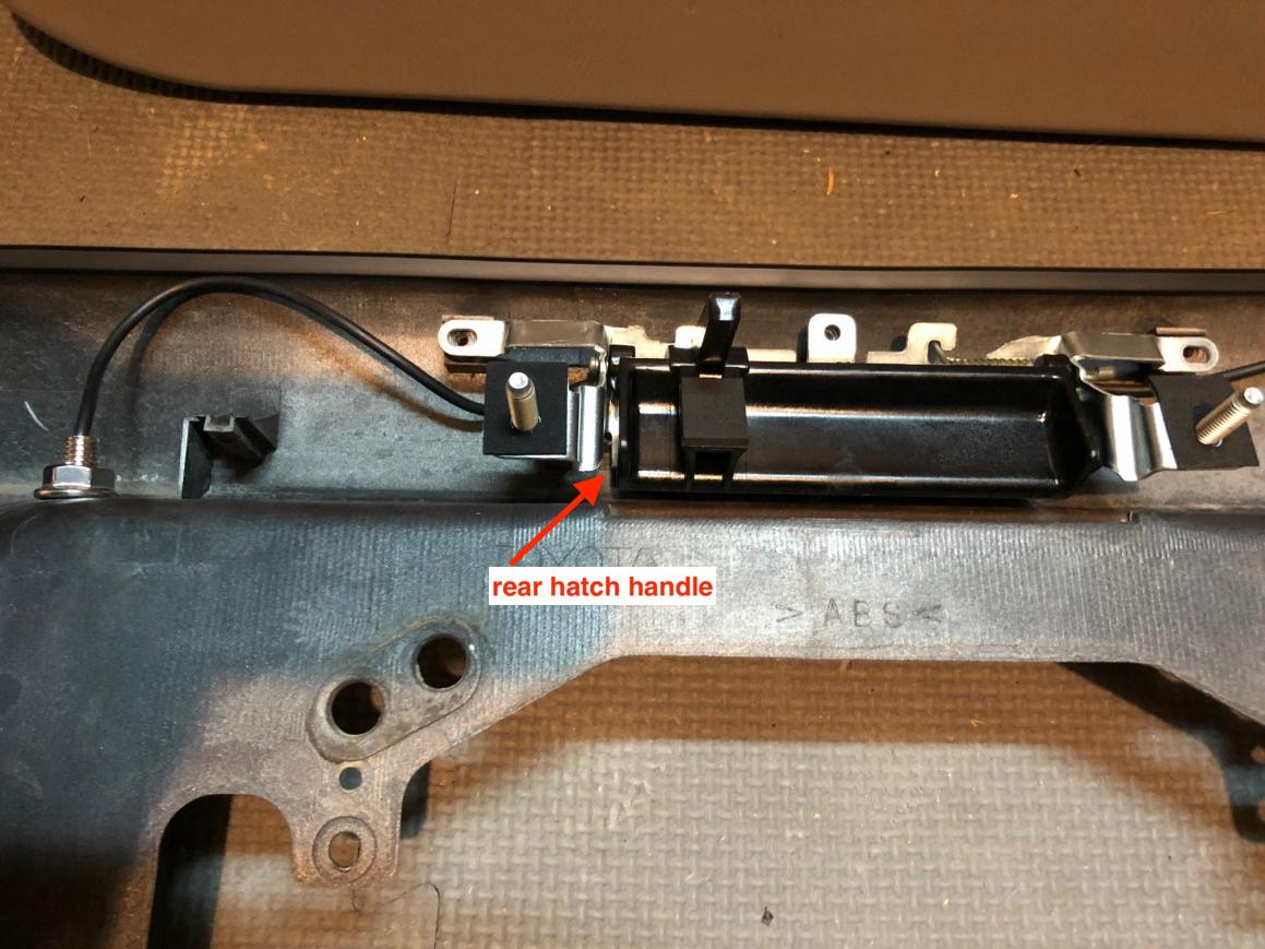

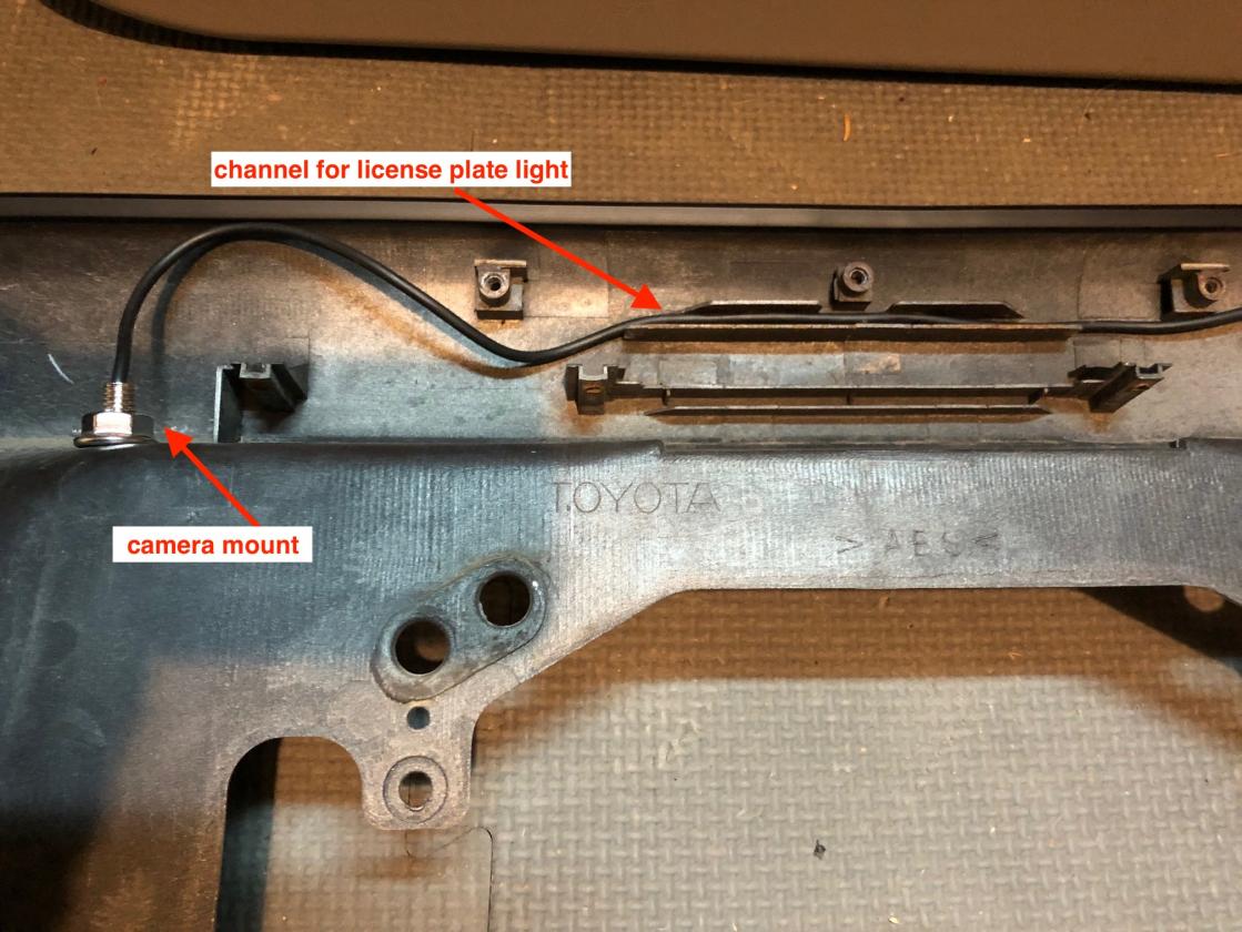

I also added a backup camera...
Thanks for this write up https://www.toyota-4runner.org/3589450-post31732.html [MENTION=631596]shawnathan9[/MENTION] it was helpful! FYI for those of you who also want to do this, if you take the extra time to remove the license plate bezel, there is no need to drill through the door (I removed my bezel because I also wanted to replace my rusty rear hatch handle and the gasket around the bezel while I was in there).
There is a channel behind the rear hatch door handle through which the wires for the passenger side license plate light runs. It will accommodate the camera wire too and you can run that along the path of the license plate light wires through the existing opening into the hatch where the key cylinder and license plate wires pass through.
