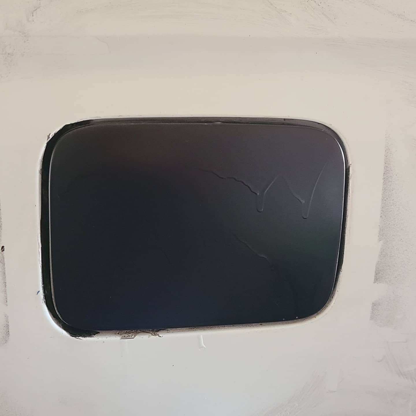

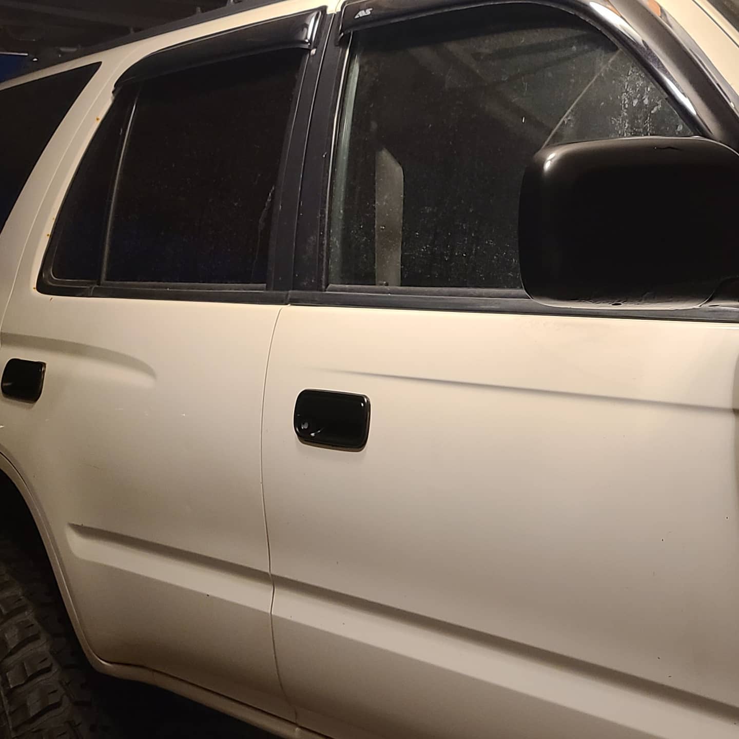

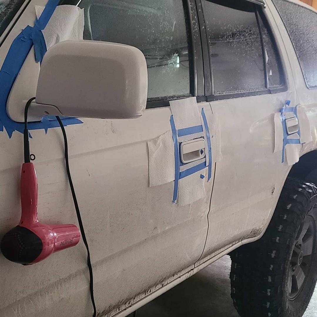

This weekend I:
removed a couple of emblems that I didn't want; and there are 3 remaining that I do want I am going to remove and paint
Removed the roof rack so I could fit it into the garage lol it'll go back on when the weather isn't crappy
Spray painted the side mirrors, door handles, and gas tank door. On a warmer day I am going to paint the chrome bumpers
I know it's drippy and it doesn't bother me lol :)

The contrast looks good. Are you just gonna paint over the chrome bumper?
My dodge has painted over chrome ( now black) and has held up ok for the past 2 years, but does scratch off easy, could have been my prep work. Im gonna be mounting a ARB bumper this spring in front, so the back being black ( yet stock) might look good.

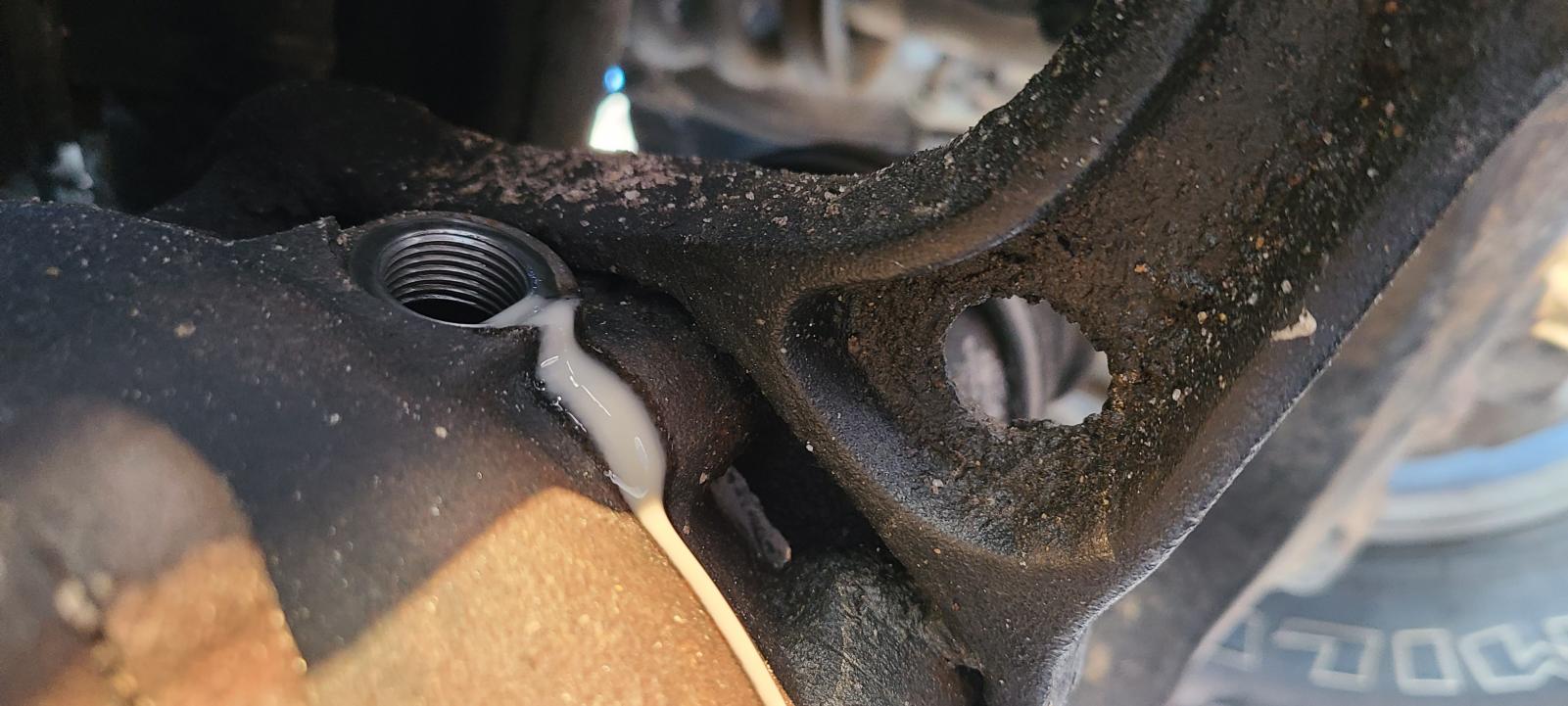

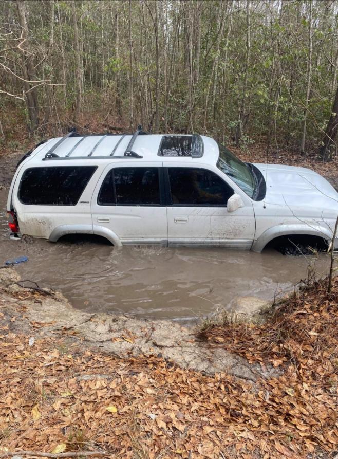

Got stuck in water the other day so went to check my fluids and this is what came out of the fill on the front diff. biggest issue is the drain plug is stripped (It has been been for a few months) Now I need to figure out how to get that out. Did the extended breather mod on the rear a while back and it checked out fine.. does anyone know if you can drive the truck with the front diff fluid like this without damaging anything in 2wd? Avoiding water and mud for a while

Get a sharp chisel and hammer a nice deep groove into the plug. Angle the chisel against the groove and give it a hard hit. That should loosen the plug.
I wouldn't drive around with fluid looking like that. You should drain and flush a few times when you get the plug loosened. You don't want to screw up your bearings. I hate water and mud! I don't understand why people enjoy driving in it. To each his own I guess.
use a siphon pump and put a hose down the fill plug and suckered out as much of the nasty fluid Take it to welder to get a bolt welded on to the fill plug then drain and fill

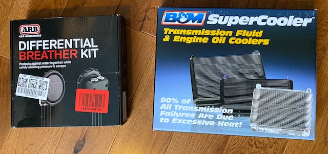

More stuff to knock out during the frame swap. We get wide temp swings (low this weekend is -14, summers we see 110+ days) so I’m planning on running the external cooler in series.

Yeah I was going to tape off the bumpers and paint those too once the weather is a little warmer. I was lucky enough to get away with the blow dryer trick haha! Thinking about doing the grill too and I think that'll require removing it so that will come later. It'll still look good once you have the ARB bumper! I plan on upgrading the bumpers but that won't be for some time. Happy building!
Bolt & screw extractor kits are nice to have for situations like this. Screw extractor for the front diff allen drain bolt. You can get cheap or pricier kits.

If that doesn't work have a bolt or nut welded on. Mobile welders are more expensive but convenient for situations (if you don't weld) when your 4runner isn't in an ideal driving condition.
My understanding is that the front diff still rotates in 2WD so driving with watered down gear oil is probably risky.
