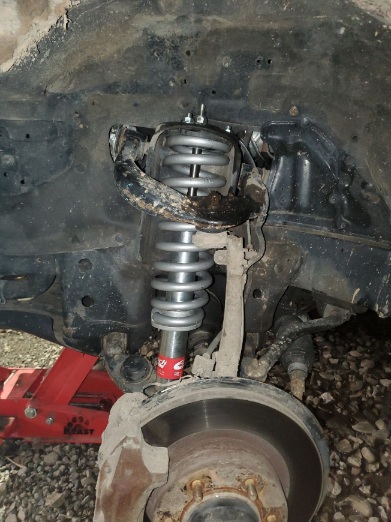

Put on eibach coils an struts not sure what I wanna do with the rear yet. Rides so nice in the front very impressed I think the old kybs were pretty tired.
