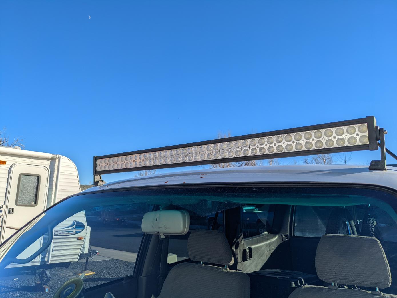

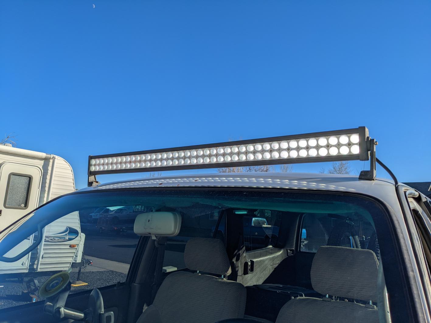

Light bar question
I recently replaced both relays that control light bar and aux backup lights. Now the light bar will occasionally have a few of the elements light up when switch is off. When activated the whole bar lights correctly, turn it off and after a few seconds some elements turn back on. I removed the switch entirely in case it was making micro contact, elements remain on with switch removed. Pulling fuse kills everything. The rear lights are on identical but separate harness, and I have no such issue.
Thoughts on why this may be occuring, and how I might fix it?
Note: the light bar did not have this issue prior to new relays replacing the rusted out old ones. Swapped relays, same thing.

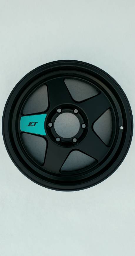

Picked up this 3rd Gen. It's awesome. I have to say.. I do prefer the AWD in the 01-02s for driving on ice/snow buuut this thing is super clean. Got my new wheels in for it. Just waiting on the tires now. I'll probably swap out the teal decal for a white one this summer sometime. 20220103_134340.jpg20220111_154323.jpg

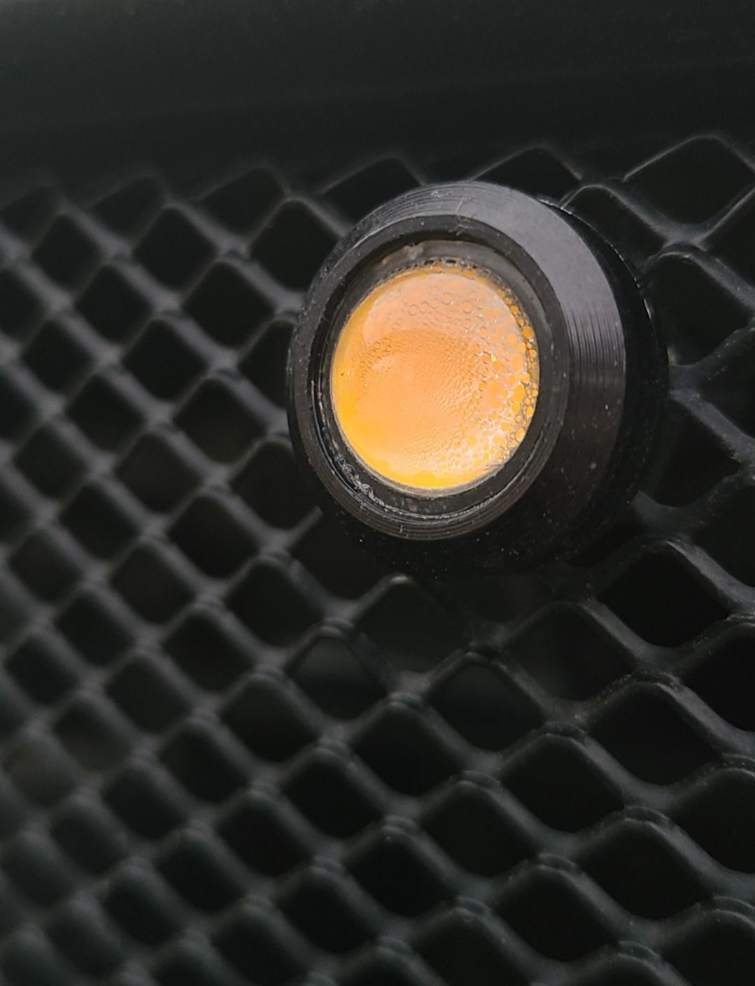

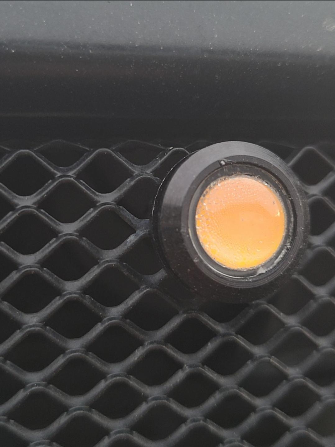

Monday afternoon I replaced my raptor lights in my SRQ grille for the second time.
This morning, less than two full days later I noticed one is already burnt out - looked closer and see there's condensation in two of the three brand new bulbs

Are those the same lights they use in their turn-signal filler panels?
Yes, they use the same ones. The problem, obviously, is they're not sealed - almost like they're meant to be interior lighting. When the grille lights went out the first time I noticed the lenses came off super easy, and since the turn signals would be pretty hard to replace individually I took the initiative to pop those ones off and put a small dab of clear gorilla glue on the back of them. At the same time I left the new grille lights alone as a sort of test to see if one would outlast the other; nearly a year later my turn signals haven't lost a single bulb but the 2nd set of raptor lights in the grille died this December
I shot them an email today about what I've noticed and asking what the deal is/why they aren't sealed, etc. I definitely can't be the only one who's had this happen, and they've been more than courteous with sending me replacements as needed - meaning they're probably losing a good bit of money on LEDs and shipping. I think it would just be better for all if they used a better bulb or something
