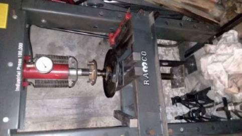

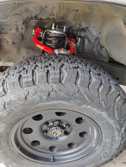

Finally swapped in the manual hubs, new OEM seals and bearing, replaced the UCA with a JBA UCA, and got it aligned.

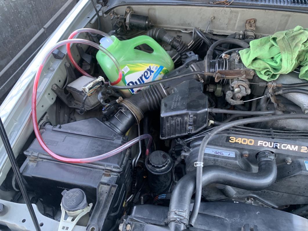

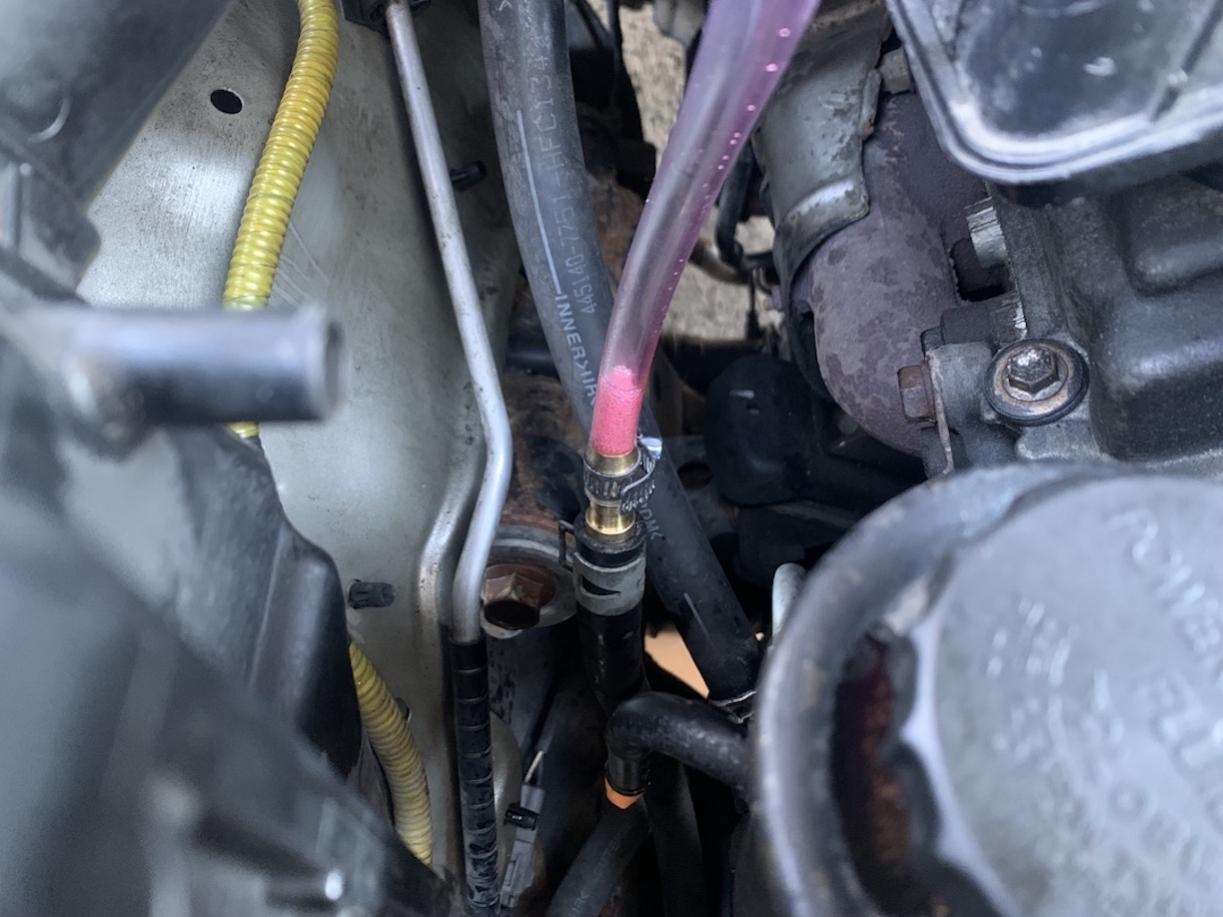

Flushed the power steering fluid today in attempt to fix the sudden high pitch whining noise when driving/turning the wheel but unfortunately the service didn't fix it. Truck needed the flush anyways.

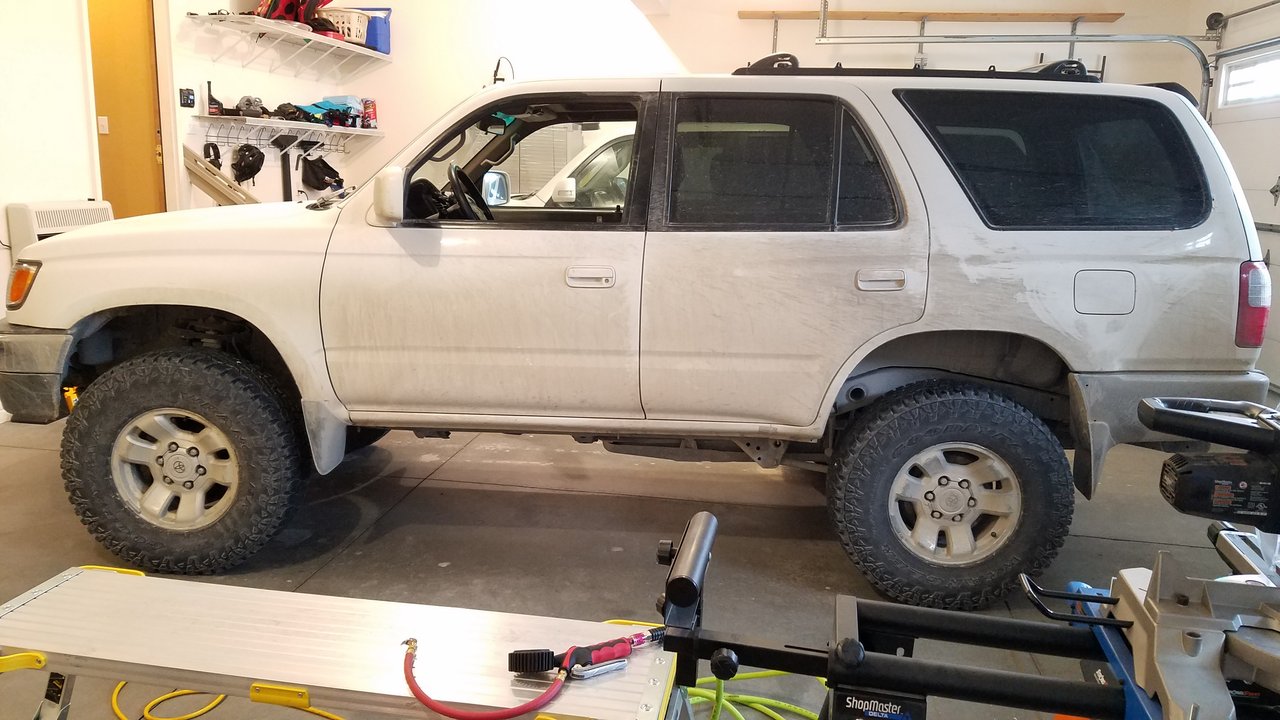

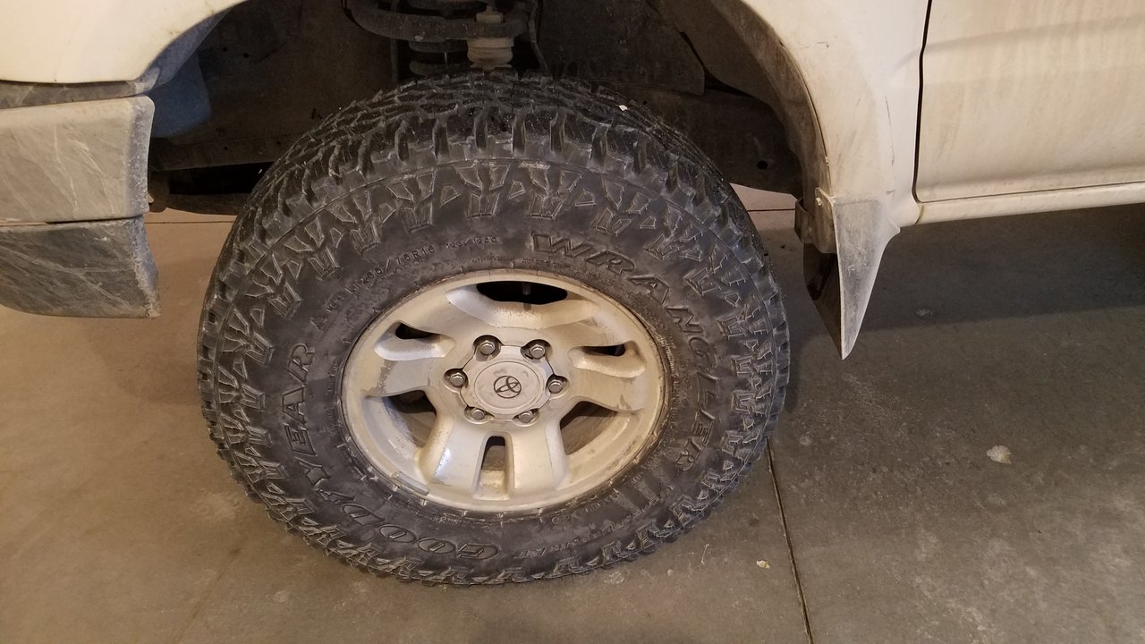

New tires... Goodyear Wrangler UltraTerrain AT (only available at Discount Tire) LT265/75R16 E1 ply rating. I really like these tires so far and they were a decent price, and in stock. I was skeptical of getting E rated after having KO2 E1 but these UltraTerrains ride totally different they are much more squishy. The KO2s might as well have been filled with sand. Feels like these need more psi than the KO2s. Started off at 36 and been going up 2 psi at a time and at 40 currently. We'll see how well the sidewalls hold up on these. They seem like Discount Tire asked Goodyear for a mix of Duratracs and Wildpeaks AT3Ws or something like that. They throw rocks like crazy though, it sounds like someone is shooting at my car after I drive on gravel with the rocks getting thrown off.

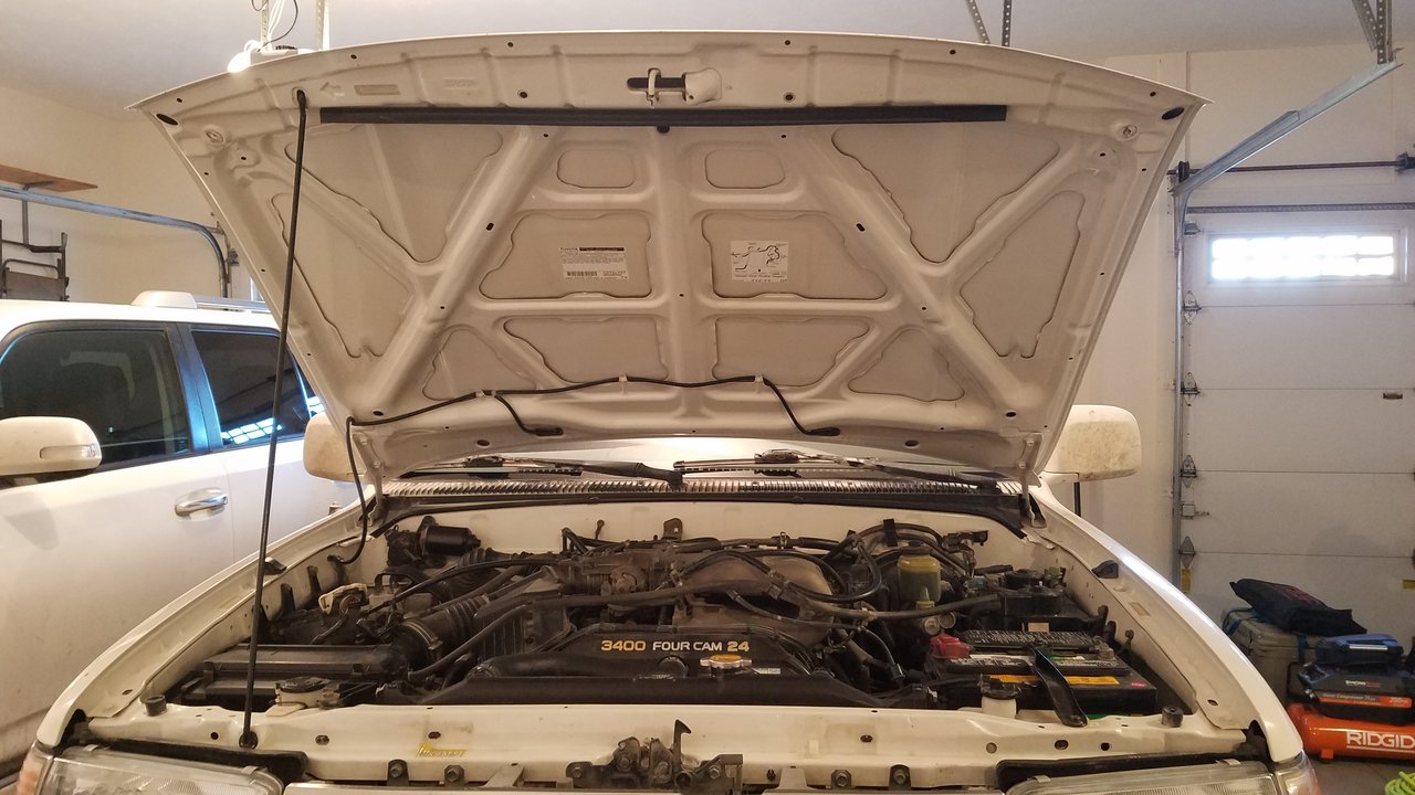

Deleted the hood insulator which was turning in to dust. If you do this I recommend putting a drop cloth over the engine and wearing a respirator and safety glasses for the fiberglass dust. All the clips broke off inside the hood and/or fell on the engine.

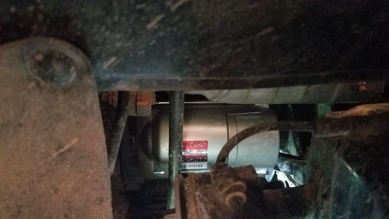

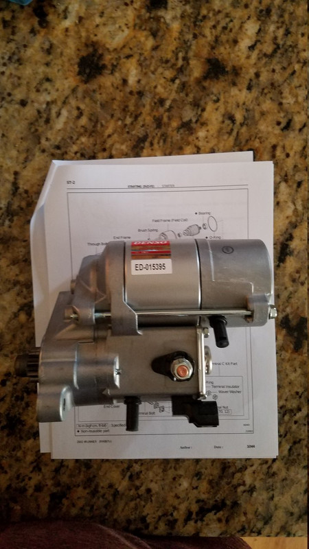

New starter. I was going to do the contacts, plunger, etc. and then remembered I had replaced it before with some O'Reilly type Chinese one ages ago, so I got a Denso reman from Napa (280-0166 1.8 kw). If you can't finangle the way to get it out/in the wheel well remove the UCA nut and push the bolt in, go have a smoke or meditate for 10 mins, then try again.

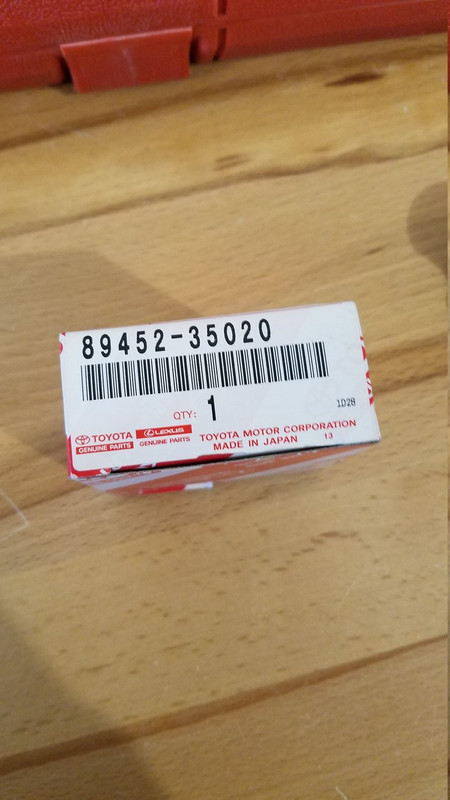

I've been having idle and stalling issue while stopped in D or very very lightly touching the gas pedal, which had been coming and going for years. I thought it was probably the TPS or maybe ECT sensor but was too lazy to replace it. Well it finally lit up the CEL (first time EVER the 4runner has thrown a code in 250k miles!!). Yep... P0120 throttle position sensor.
Holy crap I should have replaced this ages ago it drives so much better. I think it may have fixed another issue I thought was a driveline problem where it will "thud" occasionally when I let off the gas completely on the highway. Makes sense that would be the TPS but not the first thing you would think think of.
Out with the old:
In with the new:

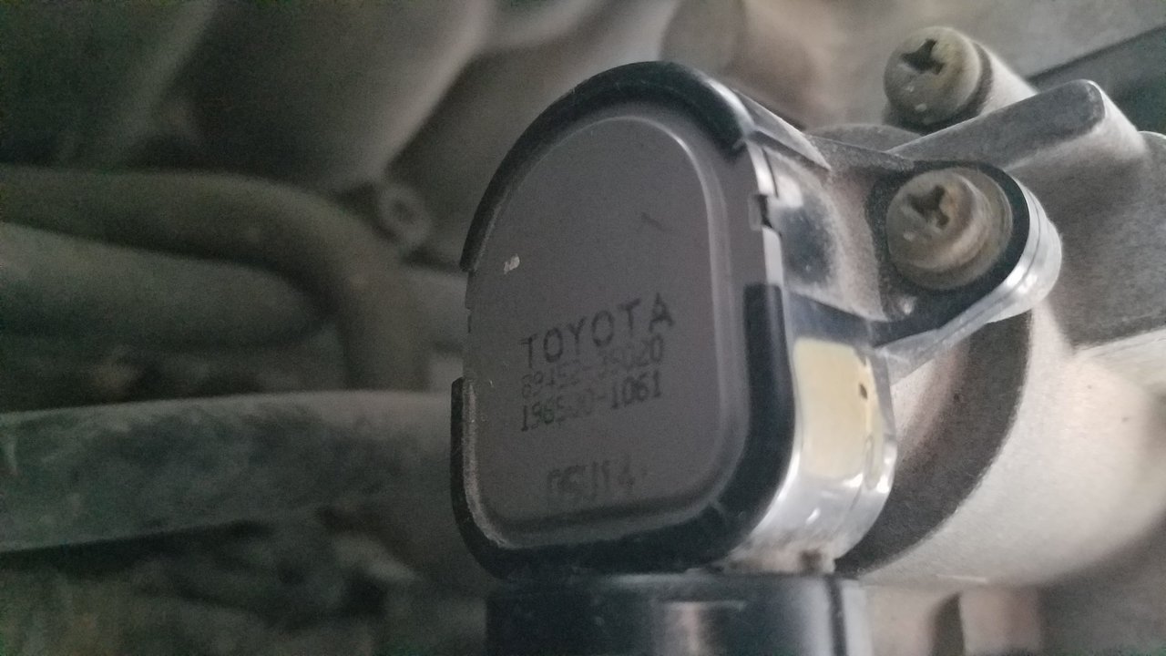

Out with the old:
In with the new:
Did you need a gasket? Or just the TPS? Thanks
