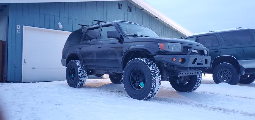

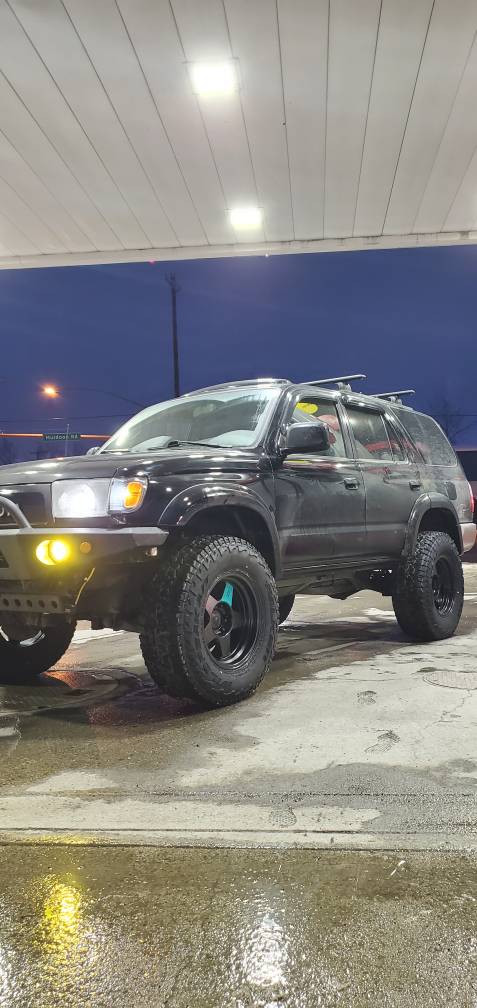

Got the SCS Gen5's and 285/70r17 Falken wildpeaks installed. Rides way better than the LT 10 ply duratrac I had before. This weekend I'll do the Depo LED tail lights and a 22 inch light bar from Extremeled.
Love the way these wheels look but the teal decal was pre installed from SCS so I might swap that out for a white decal or just remove the decals completely. Any input on the decals? 20220114_165356.jpg20220114_170838.jpg20220103_204522.jpg

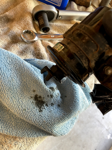

Replaced the fuel filter on my 3RZ, which is incredibly hard to access (under the intake plenum, bolted to the block). Almost as infuriating as replacing the valve shims up against the firewall. I'm pretty sure it was original, and after 298k miles, lots of black fuel came out.

I was fortunate to do mine at the same time as I changing out the alternator. Turns out that it's way easier with the alt out of the way.

I could see that being way easier. I considered removing the plenum for a hot second before being discouraged by needing to get new gaskets.
