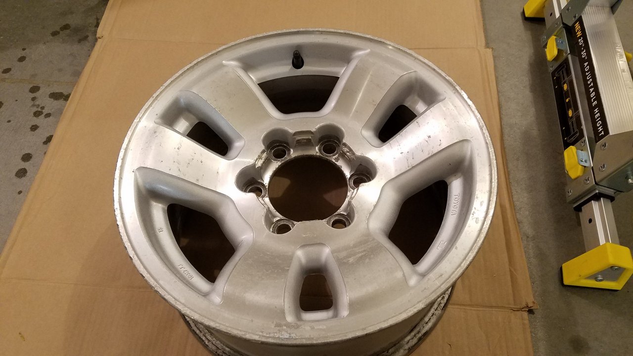

Found a matching aluminum wheel to replace the steel spare so I can rotate the spare with the new tires I got the other day. Looks like whatever vehicle this wheel came from had a a rear axle seal issue, smells gross. Couldn't get much of the gear oil stains off the inside with either simple green or aluminum wheel cleaning and a brush but it's good enough for now.

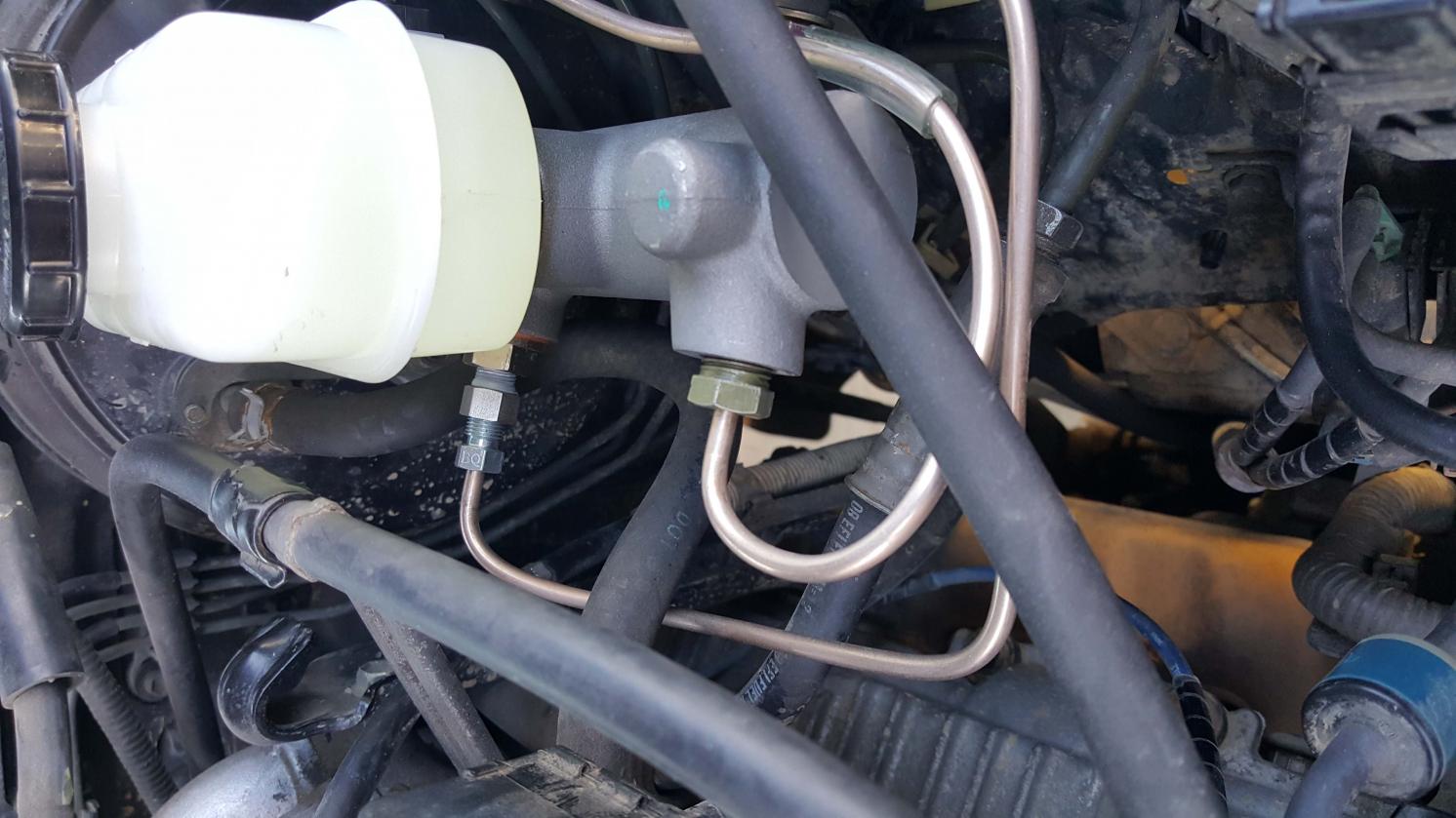

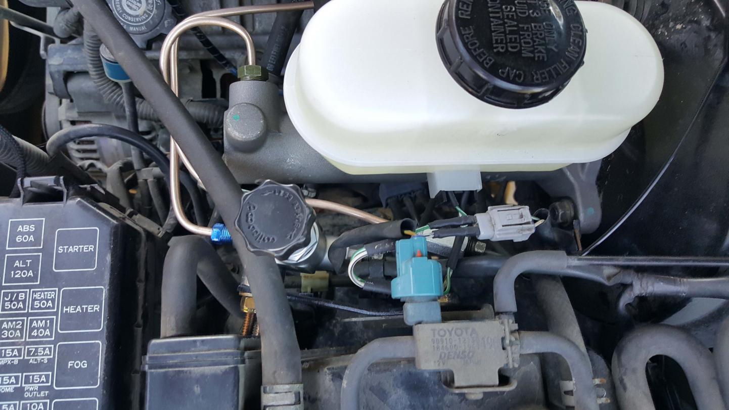

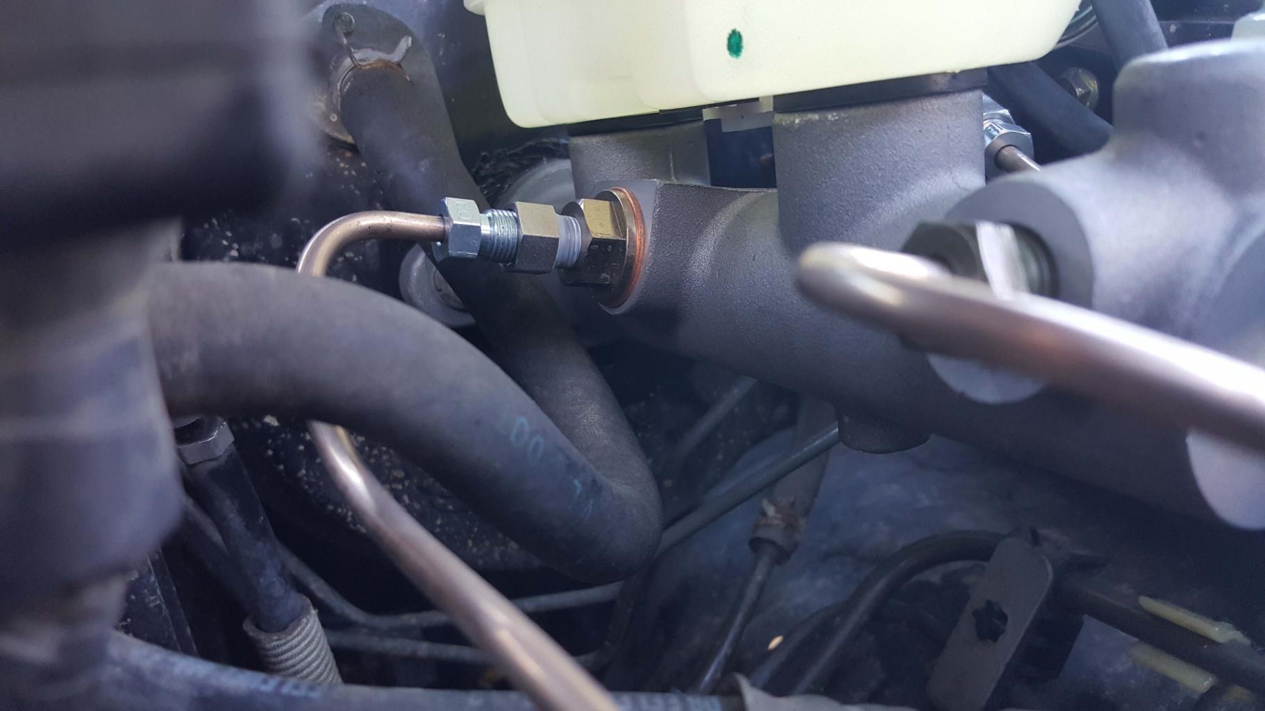

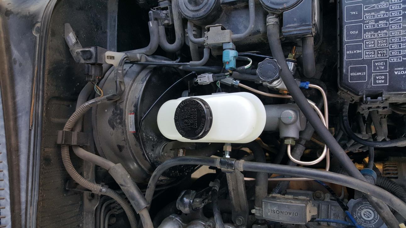

I don't have any finished pics, but the bolt spacing is perfect on the f350 master, I had to make an extended push rod as the f350 has a deep hole. The master was a pita to bench bleed. Everything worked fine, I'm 100% happy with how the pedal feels. Much better then stock with TBU and rear discs. Just made a jumper harness so the fluid level sensor would still work.

You’ve peaked my curiosity. What did you do exactly? Did you have to replace the hard lines and fittings between the master and abs pump? Any additional modifications to do this? OEM booster?
Bad Luck, I had to make 2 short lines. Used a wilwood proportioning valve (didn't need) and a union to join to the oem lines. Stock booster, made a longer plunger nose to fit inside the f350 master or you can use a master slug (what ever it's called that fills the hole in the master).
Here is what I used:
1997 f350 1 1/8 master
M18x1.5 by 1/8 npt adapter
9/16-18 inverted flair fitting
3/16 brake line
M10x1.0 inverted flair fittings
M10x1.0 inverted flair union
Long bolt that threads into the booster pushrod
Here are some pics:
