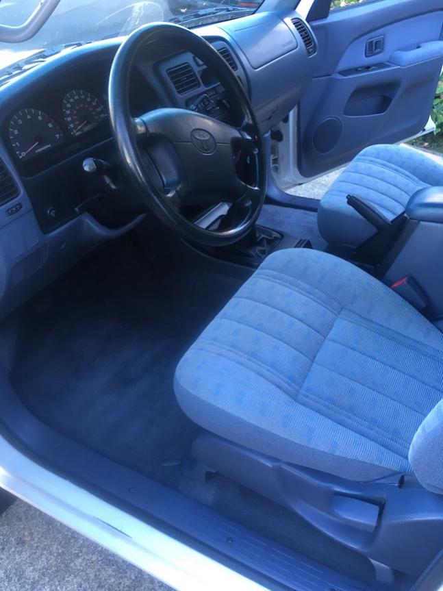

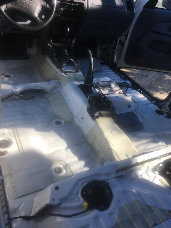

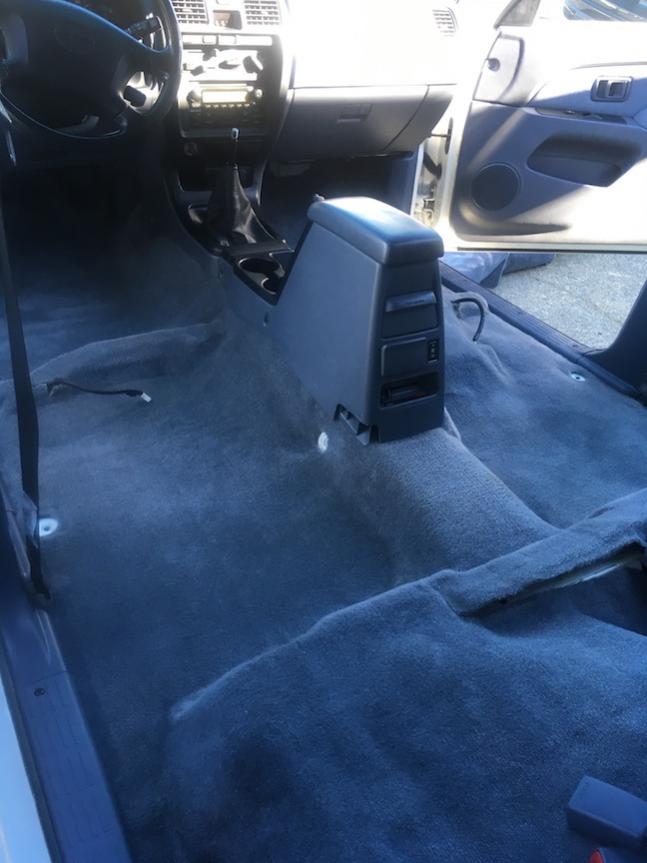

Replaced my carpet, found an excellent OEM passenger compartment carpet out of a donor vehicle. HD cleaning out of the car, then installed today. My lousy photos don't do it justice.

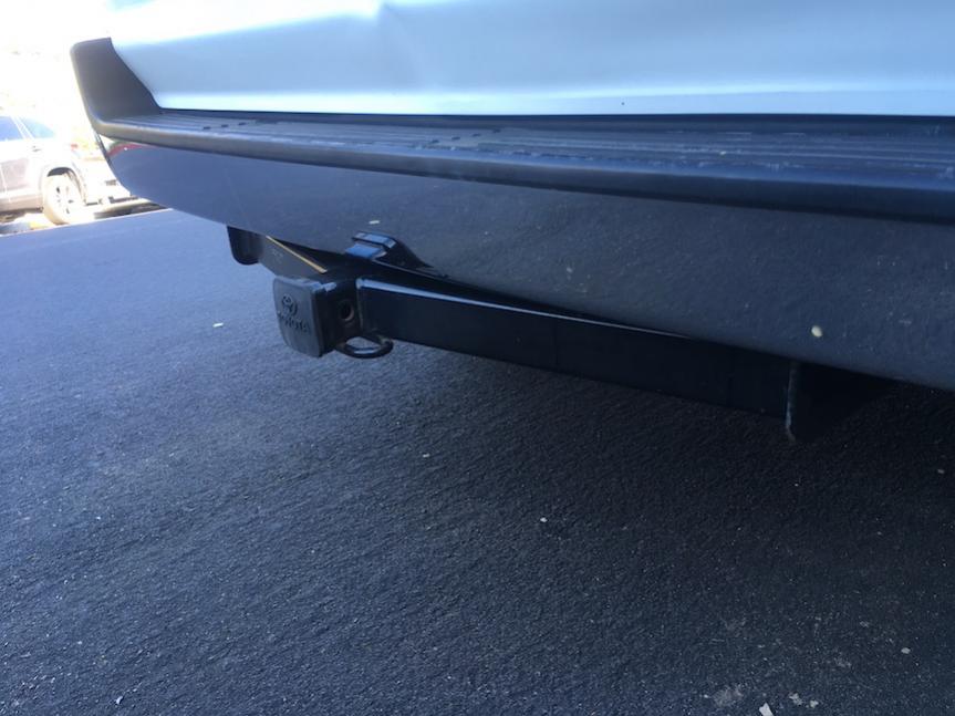

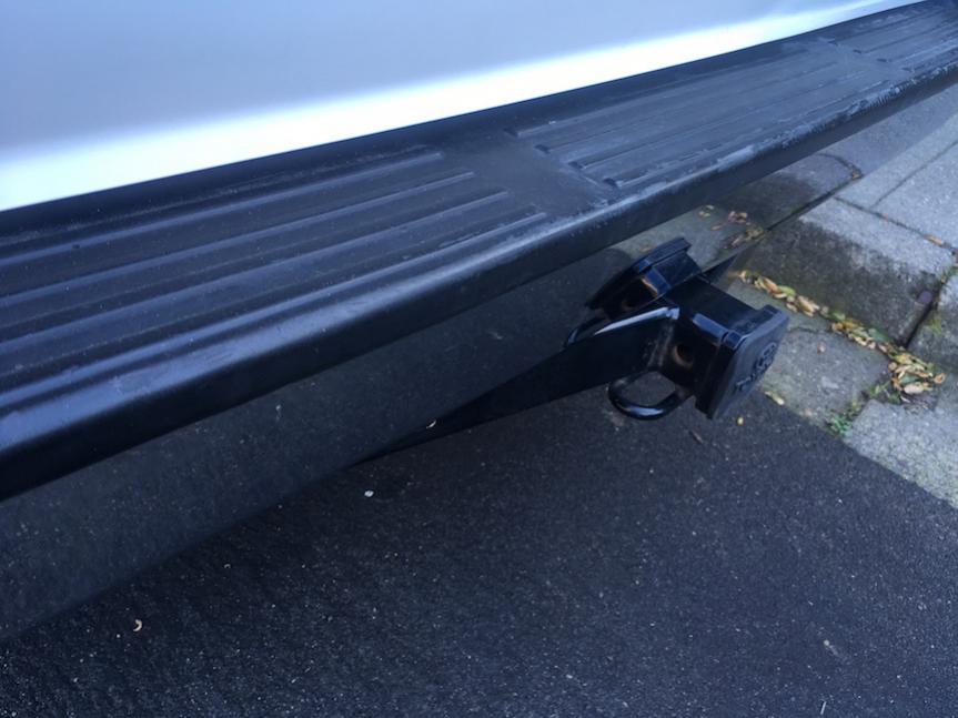

Installed a hitch I picked up, wanted something low profile. This one only extends 2-3" beyond the bumper and has better ground clearance than the typical OEM hitch. Maybe an older Curt?

looks good, only problem I have found with the aftermarket is how big of a spare you can fit, for example, I took off a aftermarket and went with a stock toyota so I could fit a 265/75/16 ko2 on a factory 5 star wheel for a spare, this can be important if you do the TBU brakes or do lots of long off road...then again some who do lots of long range back road have a big bumper with a spare mount

Looks good, but whenever I see a glossy hitch on a 3rd gen I can't help thinking to myself "pass" haha. It's the first thing I notice on ones for sale... if the hitch is glossy or doesn't have remnants of the original Toyota hitch sticker (i.e. it's been painted over) it always has rust issues and I don't even bother looking at the rest of the pics. The state of the hitch sticker is like the fastest way to gauge the condition of a 3rd gen IMO :D. I had that same hitch cap until last week when someone must have stolen it!

Funny, it's the original powder coating, I didn't repaint it. Stickers were missing, that's why I wondered who the manufacturer was. Picked it up on my last Rancho Cordova parts run, it's used just very clean. The frame/undercarriage of my 4Runner nearly as clean, spent it's life on the streets of San Jose, CA.

Doesn't apply to your aftermarket one, I meant on the original stock tow bar people like to do a quick paint job on it before they sell if they have rust problems and it's a red flag if the stock tow bar is too glossy or missing that indestructible sticker with white writing. If the tow bar is rusty the rest of it is much worse. I look for UV faded gray with white writing above the hitch when shopping 3rd gens, we have rust problems up here though. It's great for filtering out problem vehicles at a glance. Example:

Generally true, good indicator for machine tools too -- a nice fresh coat is paint usually says "guilty!"
My 3rd gen is rust-free but the hitch has a fresh coat of paint... because I took it off and painted it! :)
