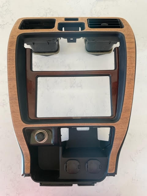

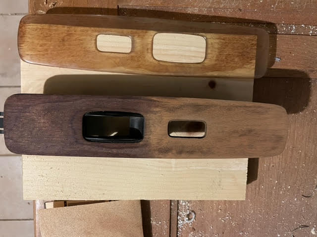

I got the idea from an old post by TheDurk. There is thick plastic covering the wood veneer. You can see it was already peeling away from the upper right in the original picture. I was able to just peel off the rest, pretty much in one piece, from the center trim. The trim around the shifter and the door trim pieces weren't peeling as much, but I was able to get a corner started and used a putty knife to pry it off the rest of the way. I tried to be patient and go slowly, and most of it came off fairly easily.
Once off, I just sanded down the veneer until most of the color was gone (picture 1 partially sanded, picture 2 complete). I then applied a couple coats of stain. I was trying to get a color close to the original and ended up using American walnut. It turned out a little lighter, but still looked good. Lastly, I added a couple coats of semi-gloss spar urethane. I went with spar urethane over polyurethane because it's supposed to hold up to moisture and UV better and my 4runner lives outside.
The worst part was trying to get a smooth layer of the urethane. I tried wiping it on with cloth and foam brush, but neither of those worked great. Ended up using a regular paint brush. You can see some brush marks/thicker spots at certain angles and lighting, but overall not too bad. At some point, I may try lightly sanding with very fine grit sandpaper/steel wool to smooth it out a bit. I didn't do the trim under the gauge cluster because it still looked okay. Also, be prepared to drive around without trim for a couple days while it dries between coats.

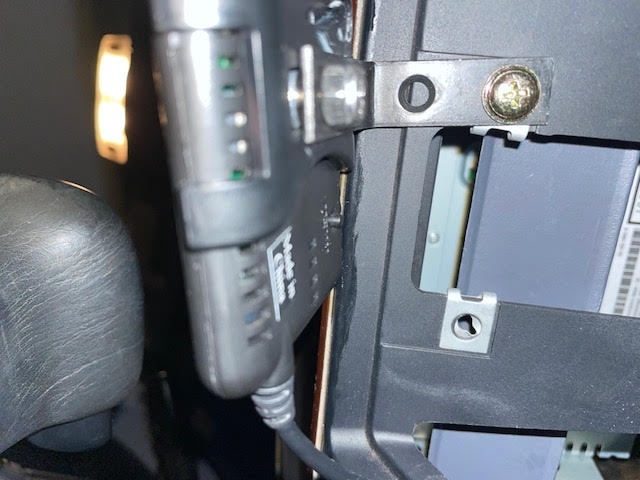

What mount did you use for that Ultragauge?
I just used a black L bracket/corner brace. I took out the ash tray and used the same screw to attach the bracket, then just bent it slightly to angle it up a little. I attached the gauge mount using a bolt with the thinnest head and washer I could find. It was cheap and has worked well.

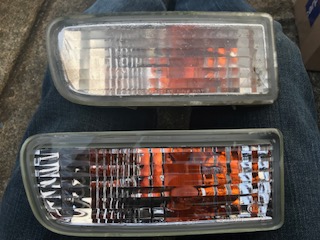

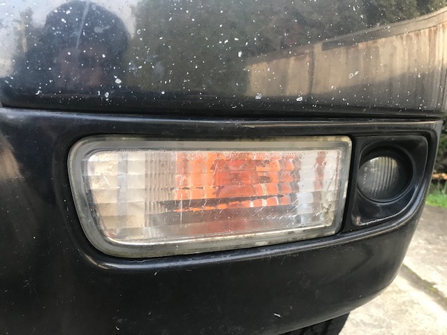

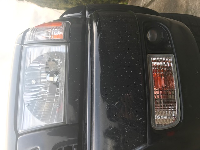

Went ahead and swapped out my turn signal lights with some aftermarket ones from carlights360. I ordered the same kit that someone earlier in this thread posted about. They seem to be of fine quality, about the same weight as the OEM lights. We'll see how they last but they look great as of install time!

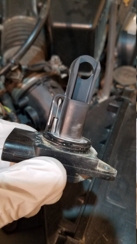

Replaced air filter.
Changed engine oil and filter.
Greased SPC UBJs.
Adjusted kickdown cable slightly.

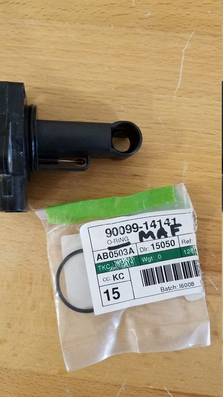

Cleaned MAF. This may explain why I've been getting 13 MPG lately. This is with the standard Toyota air filter that was about 6 months old and had been cleaned twice already. Going to try to avoid dirt roads (dust roads) as much as possible until I get a snorkel.
Replaced MAF o-ring
