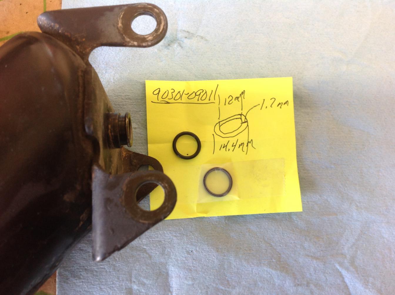

Oil change at 209000 miles
Half a bottle of Sea Foam in the crank case about 250 miles before.
Tundra engine oil filter (higher capacity than 4Runner filter, Toyota PN 90915YZZD3)
About 6 quarts of Shell Rotella T6 5w-40 Heavy Duty diesel engine oil (5.5 quarts plus about half a quart for the higher capacity filter)

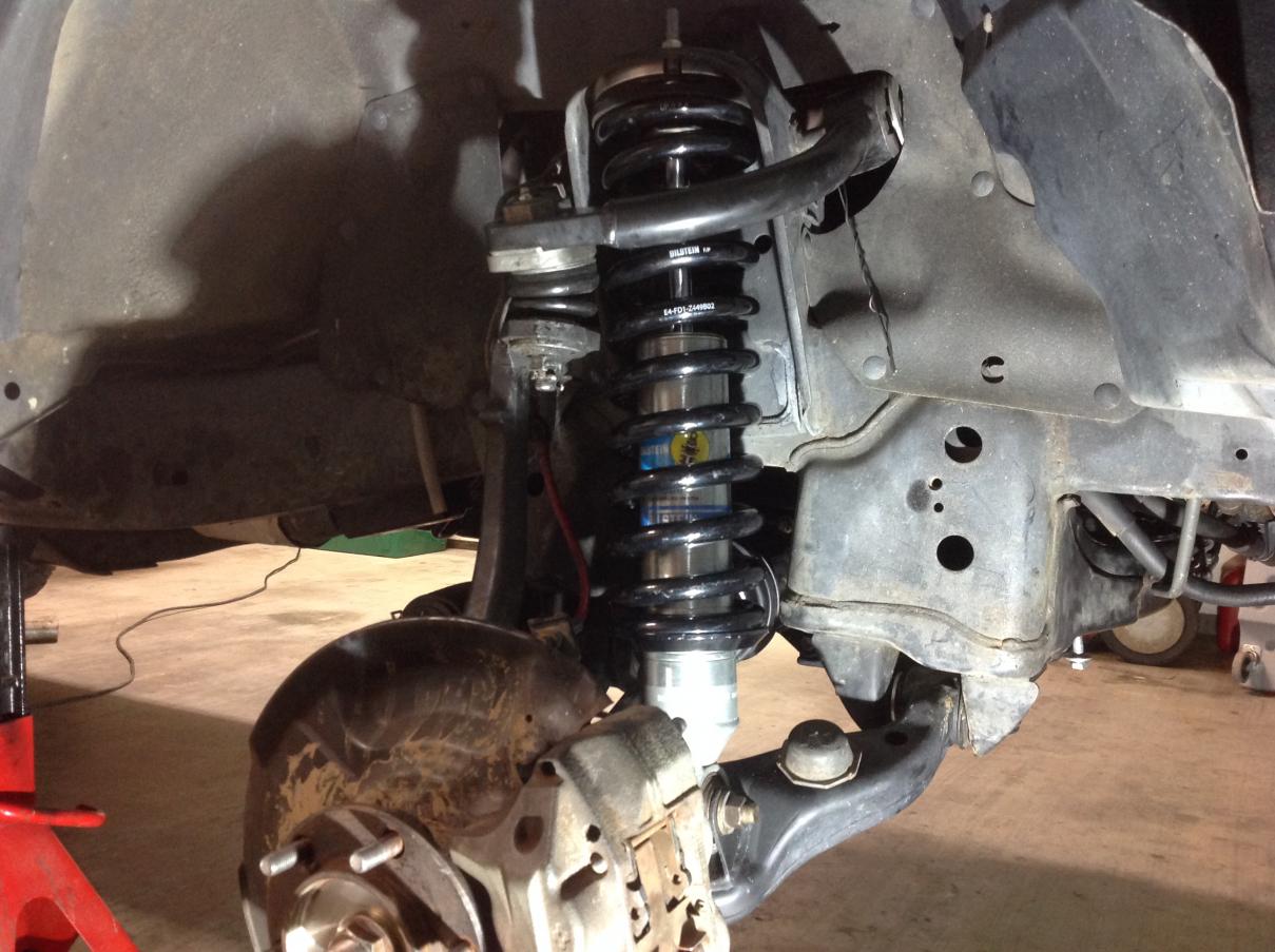

Wash n Wax my 6112's
Since they were out and disassembled.
Along with this week:
New Rack Rag joint remove flush hard lines replace return line hoses PS pump service. New rack feels real good.
CV axles drain n fill Diff.
Add 3/8" top hat spacer. Like current preload.
Adjust UCA BJ's LCA cams to increase Trac width 7/8" to match rear missed this on initial install.
Measurements stroking travel for limit straps left side full droop will bind outer CV n break stuff.
Almost done.

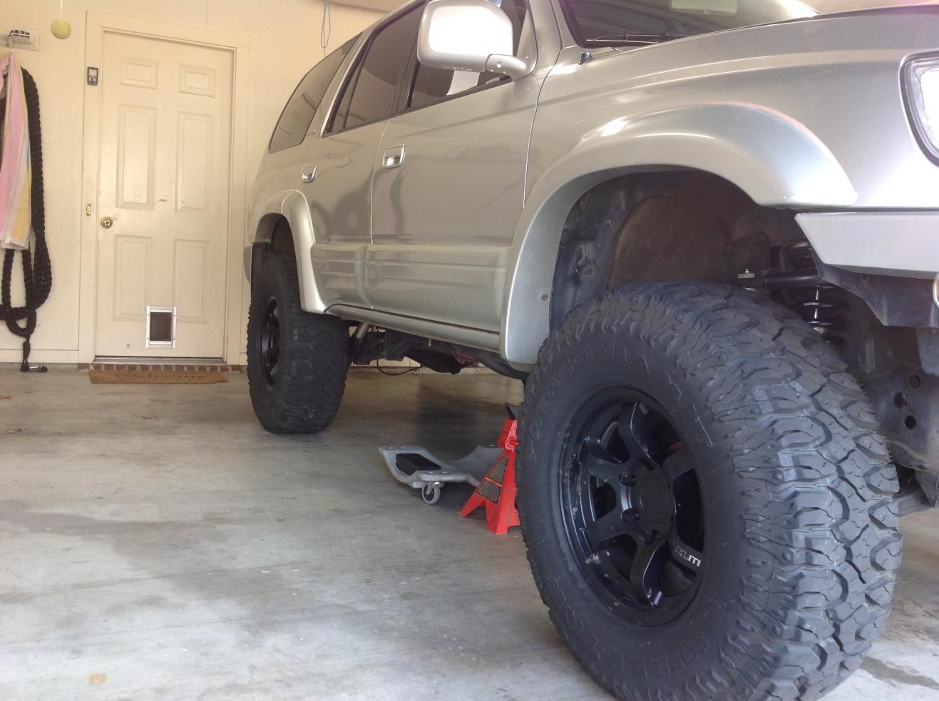

Gettin there
Back on 4 wheels setting level 120# of weight plates between rear wheel wells.
Adjusting Camber and Toe maintaining Caster next on the list, toe is good at the moment camber has tire on outer third of tread caster is at last alignment +-3* for the moment. Before I'll think of driving 9/10 of a mile to machine.
But then there's powering up P/S system filling Diff and a roll around on the creeper looking.
Party tomorrow!
