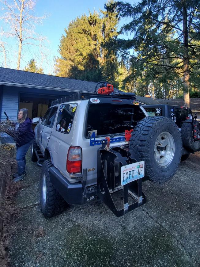

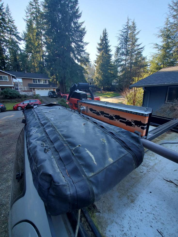

Added some OLAF (Overland As Fxxx) PNW style. Chainsaw scabbard up on my rack. Just fabbed up some simple L brackets to hold it. Have a feeling there's gonna be a lot of trail cleanup needed this season..

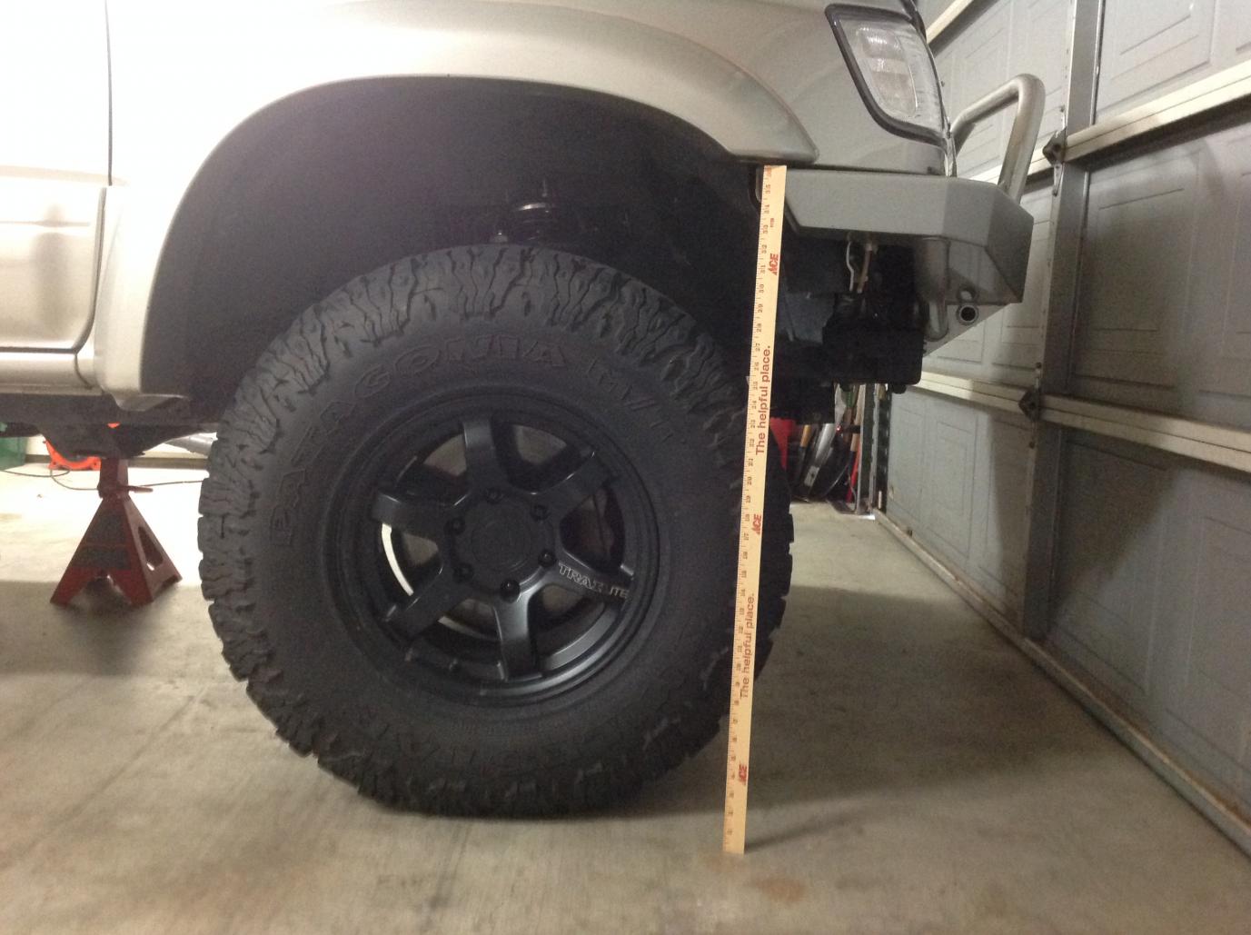

What's high enough.
Think I'm there.
6112 PS 3rd groove DS 4th 3/8" tophat spacer both sides hub center to flair 24".

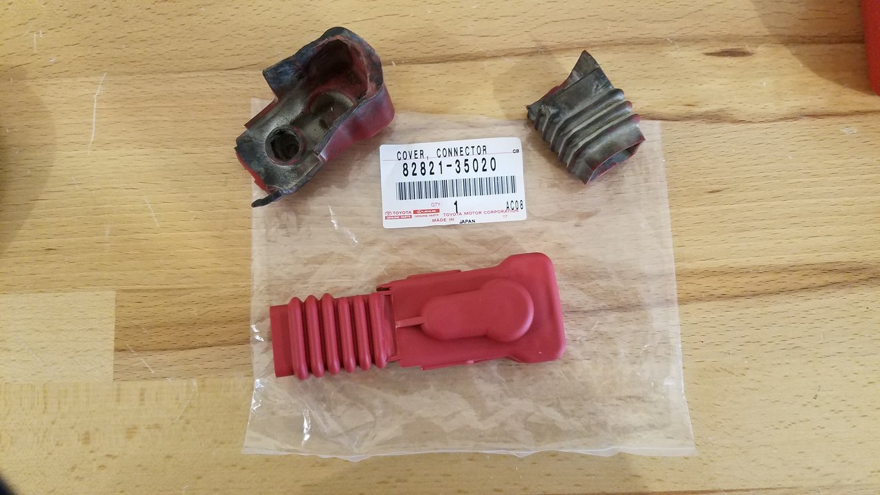

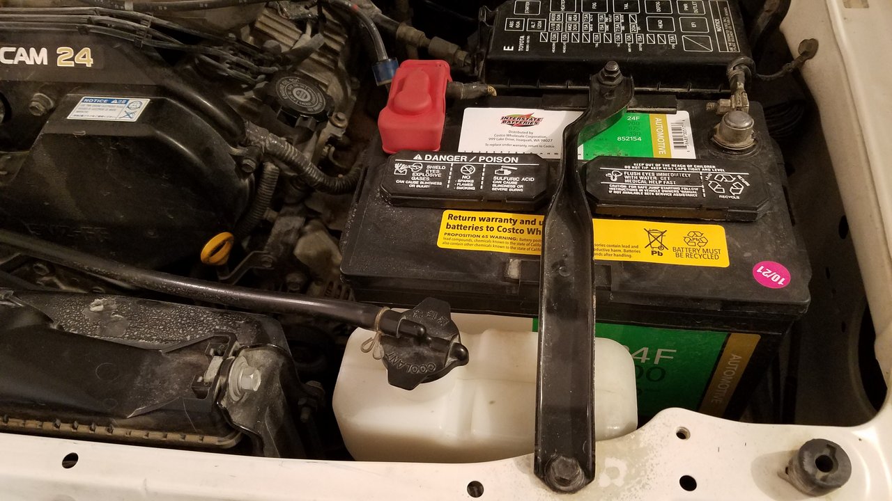

Been wanting to do this for years and then the hinge part broke so there was nothing really holding it on. Un-doing that terminal nut took some experimentation with different kinds of pliers.
Safe to say this thing has seen better days. Yikes. Going to replace ASAP.

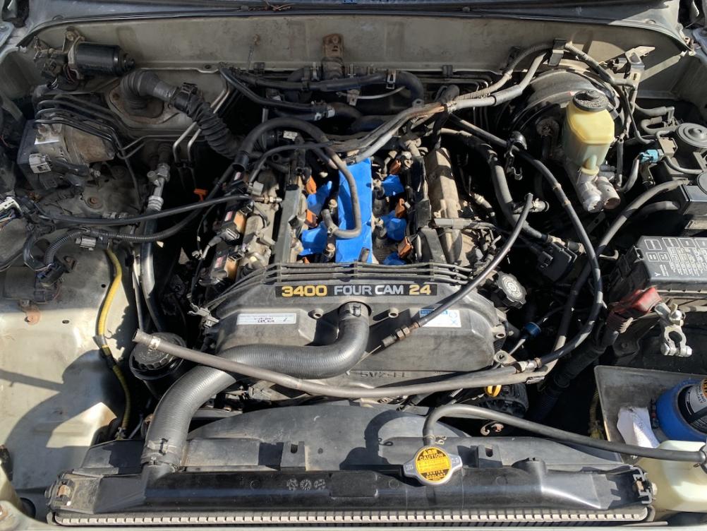

Tore the top end apart so I can upgrade to the Denso fuel injectors. injector #5 failed the OHM's test which was expected as that one was constantly misfiring....
One of the injectors got stuck on the block when attempting to remove it but using a drop of engine oil and working the injector side to side did the trick.

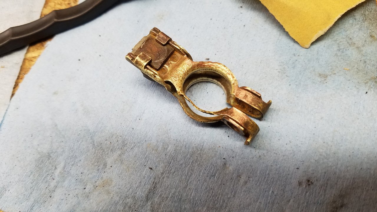

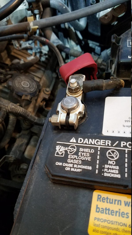

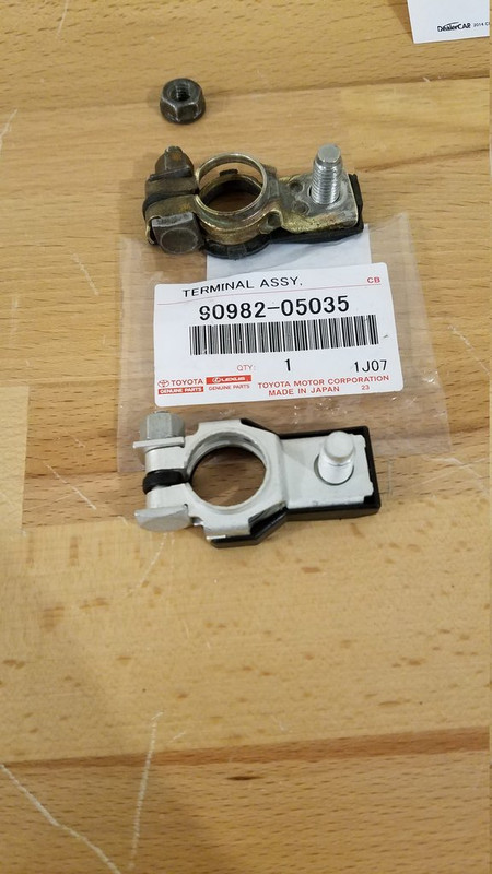

New positive battery terminal. I suggest replacing this with the wire off the battery so you don't put any stress on the battery post. The old one was tightened on really good so took some effort. The dealer try to give me another of the old style ones but I asked to order that specific part number because the new one is beefier and perfect for the terminal cover to fit on properly and the fuse box cable sits higher so fits better too.
