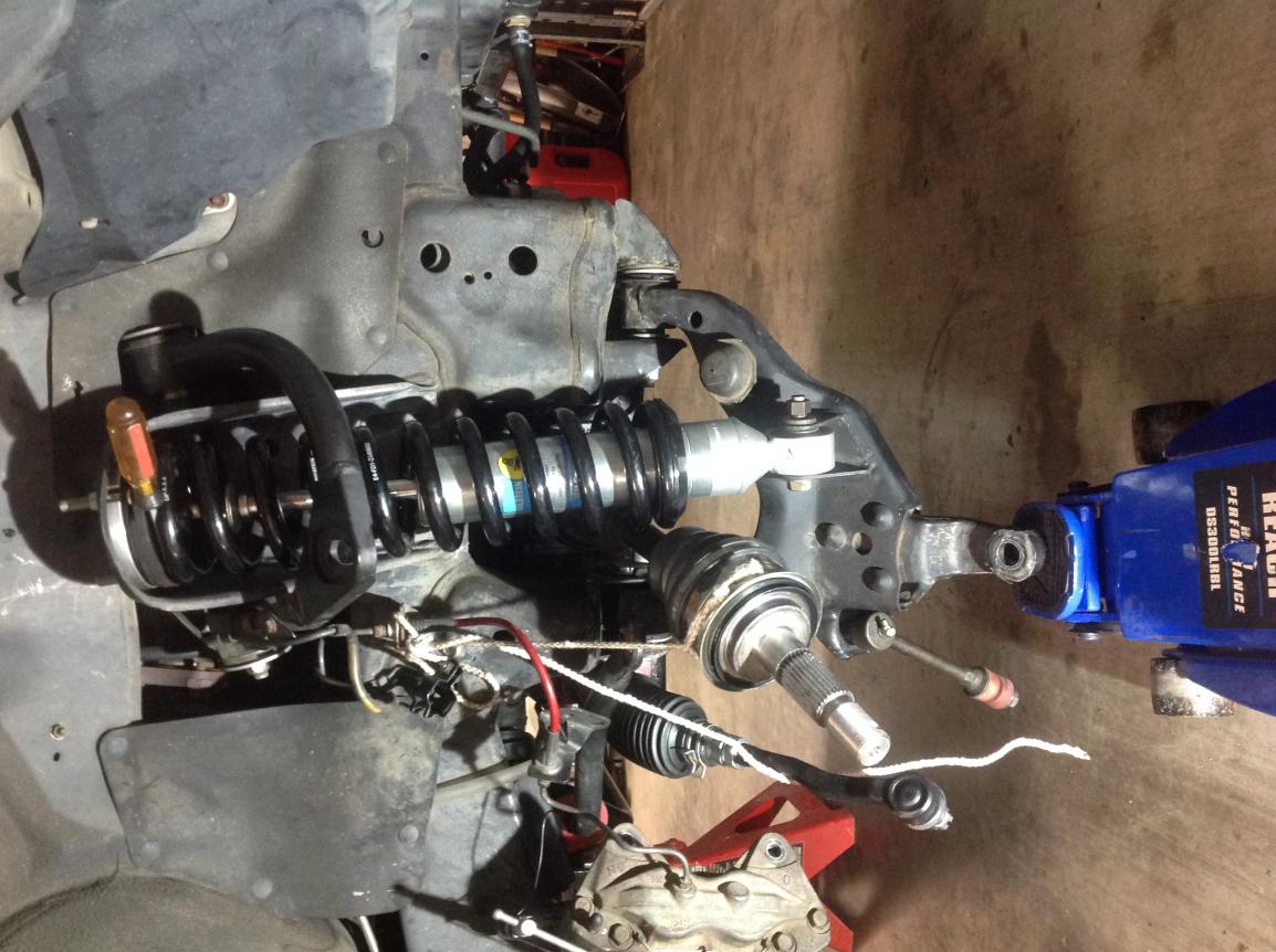

Installed my SPC UCAs - only tool 6 hours working mostly alone lol
Tim and Shaun's video helped, specifically on the removal of the UCA bolts - that was honestly the easiest part. Thanks for that, men!
The most challenging step was pressing the factory UBJ out of the spindle. I did one one the car, big mistake. I removed the second spindle and did the press work on the ground using a loaner ball joint press from the parts store.
The second bugaboo is the snap rings, removing the factory and installing the SPC on the spindle adapter. What a PITA
I did not get to LCA bushings, and I did not install the 333 Fab cam eliminator kit, so I set the UCA ball joints to "D" per the instructions for now. Next weekend, LCA bushings and new LBJ, then an alignment.
Torque on the UCA top nut is 150 LB FT, so I ordered a new 40-250# torque wrench
I also swapped center dash bezels between my 2WD and 4WD, to retain my antenna switch mod, and swapped steering wheels - I actually miss my thicker self-wrapped steering wheel!

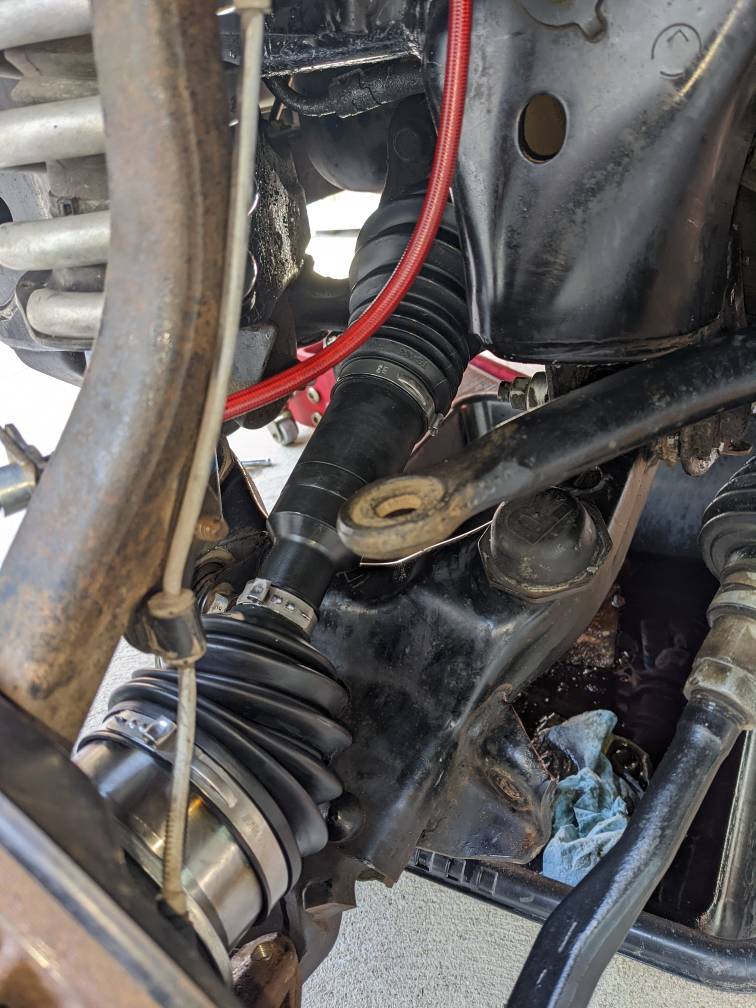

Today I will replace the stock CVs with TO8043ET (TrakMotive) extended/high articulation CV axles. I hope to get this done in 4 hour or less considering all the cleanup I have to do...
Best I can tell the nut up top just unscrewed itself. Glad I have the bags.

Replaced both CV axles with TrakMotive extended/high articulation CVs
The passenger side CV separated when I removed it, leaving the inner share and cut in the diff. Glad I had a catch bucket under it. #nopicture
Replaced swaybar end links, too. 95 4runner rears in the front with poly bushings, my stock fronts in the rear with new rubber bushings.
