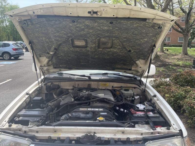

Bolted a small plastic container of naptha mothballs to the fuse box to try to keep the mice out and added hood insulator blanket (Part # 5334135022) to replace insulator lost to massive fuel leak caused by rodent damage. The clips for the hood blanket are part # 9046709006. The insulator blanket is rigid enough that it can be clipped into place with the hood open as shown. So there's no need to take the hood off, which helps a lot.

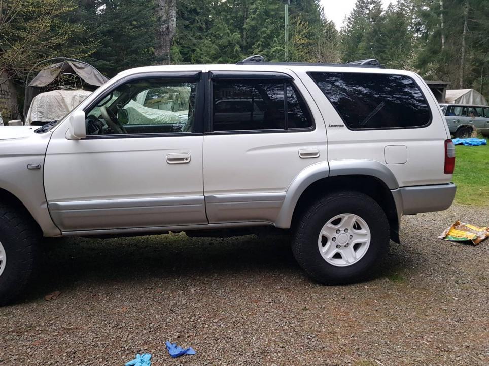

are those side marker lights on front fender. do they work as blilnkers too ? Are they toyota
I got a set of front fenders from the wreckers. Someone cut and put those lights in. Not sure which type. I actually just painted up my other Limited fender white to replace this one so it will be coming off soon. Getting tired of driving around looking ridiculous with multiple colours. Then, the bumper, and it will start looking nice.
Hard to tell from the pic, but it looks like the Saab side markers I'm using on mine.
They come in clear/yellow bulb or yellow lenses.
If you wire the hot wire to the parking light circuit, and ground it to the hot wire on that side's turn signal bulb, it will do both. When parking lights are on, current will flow through the side marker bulb and on through the larger turn signal bulb, lighting the smaller side marker bulb, but not enough current to light the turn signal.
And when the turn signal bulb goes on, then that circuit 'saturates' (probably not the right word) and no long acts as a ground for the side marker bulb, so it goes off.
Net result, bulb is on when parking lights are on, bulb blinks when turn signals are on.
