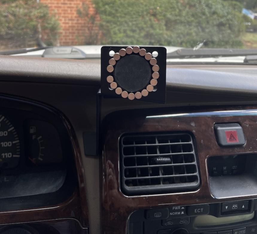

Installed Spiker phone mount. The magnet that's included with the mount isn't quite strong enough to hold an iPhone 12 with case and MagSafe wallet (total weight = 8.845 oz) but there's an easy fix: surround the included magnet with neodymium kitchen magnets and you should be good to go.
Note: The MagSafe wallet is what makes all the difference when it comes to getting enough magnetic force. Without the MagSafe accessory, there's not enough force to hold just the phone in its leather case, even with the extra magnets.

That's a clever solution :thumb:.
It's nearly impossible to find a one-size-fits all magnet for the large variety of phone sizes and protective cases that's out there. If I supply a magnet strong enough to hold a large phone with the metal pad inside the case, then someone with a smaller phone with no protective case will have a really hard time pulling the phone off the magnet. And vice versa, as you are finding out.
Another option for a situation like yours is to use a rare earth magnet with a hole in the center, which can be easily attached to our phone mount. Like this one - LOVIMAG 60 lbs Holding Force Neodymium Cup Magnets, Industrial Strength Round Base Rare Earth Magnets with Heavy Duty Countersunk Hole and Stainless Screws for Tool Room,Workplace etc, Pack of 12: Amazon.com: Industrial & Scientific
Just be aware that this one is rated for 60 lbs, likely a huge overkill - you might need to add some plastic shims to reduce the magnetic force.
