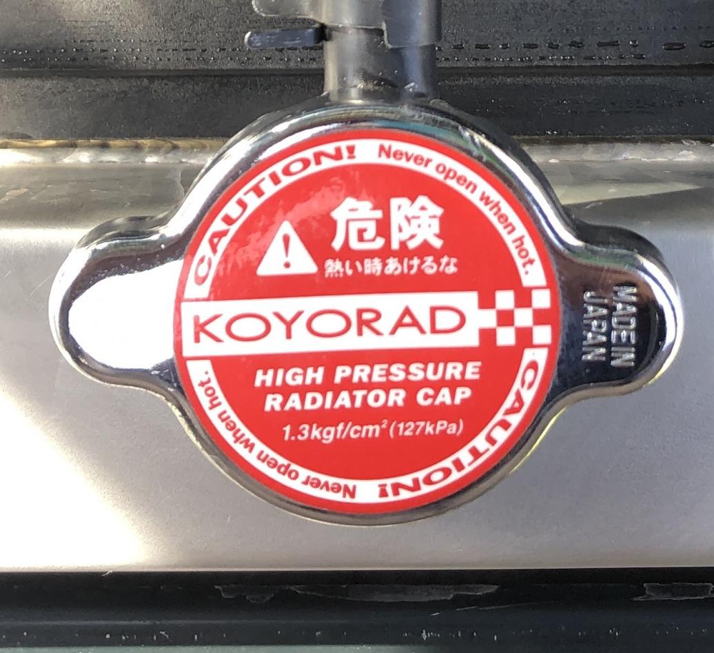

Yep always at 6 O'Clock. When I got this 4Runner nearly 5 years ago the cap it came with started to disintegrate internally causing pressure loss. I replaced it with the OEM 88 kPa and was fine. When I replaced the radiator it came with with a $120 Denso I also replaced the cap and it was fine for a year or two. Started getting some fluctuations and tried the 108 kPa for the heck of it and saw no difference at all. The Koyorad uses its own 127 kPa cap. Most of the time things are swell so I will just keep an eye on it.

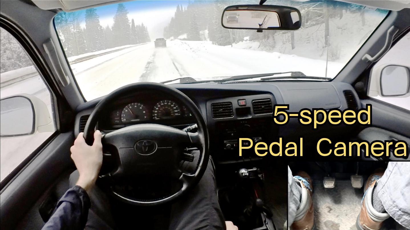

POV & Pedal Cam - Manual 3rd gen - Blizzak DM-V2 Winter Tires
Made mountain pass snow drive video with new Blizzak DM-V2 winter tires. Updates on my recently purchased 2000 SR5 4x4 'Winter Beater' with ~175k miles.
POV & Pedal Cam - Manual 3rd gen 4Runner - Blizzak Snow Drive
LINK: https://www.youtube.com/watch?v=st723Jq8hrw
Hope you enjoy!

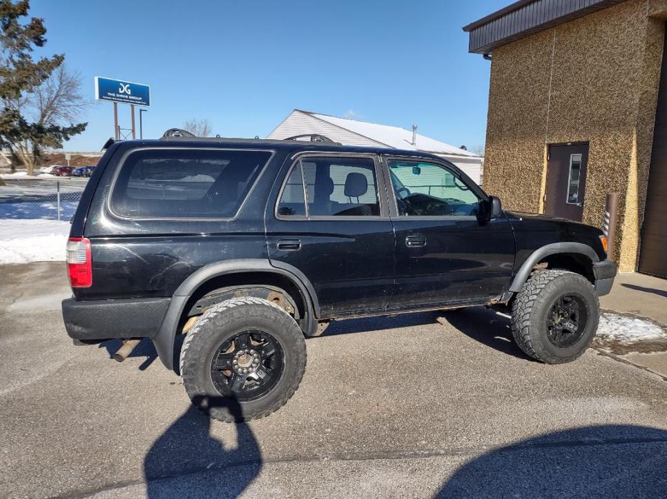

But I spent 9 months in WI on a job and just got back home. Brought back a '99 from Wausau.

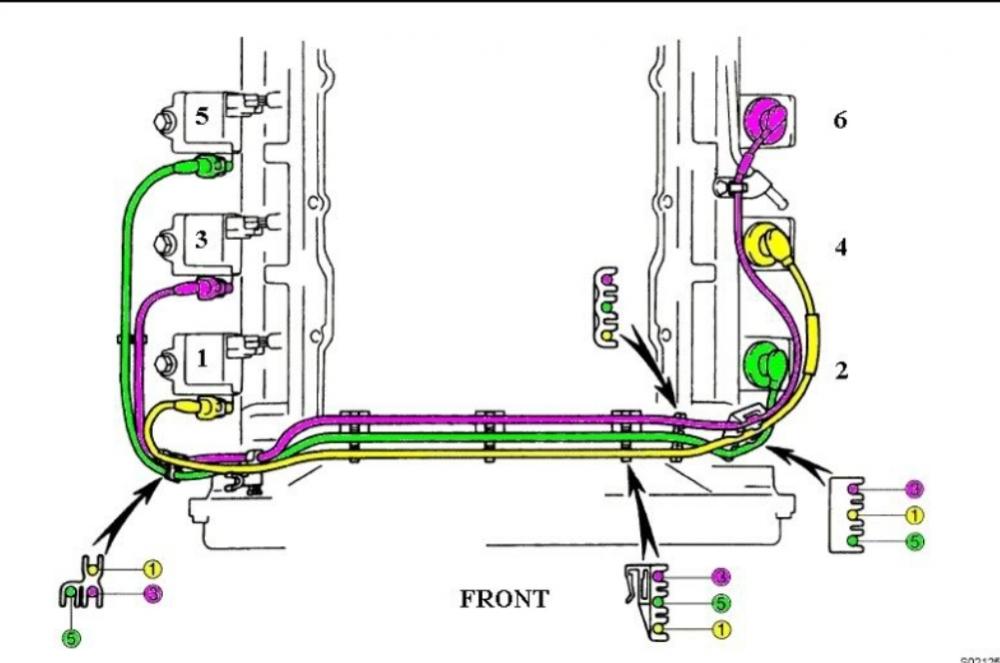

Not sure what exactly you mean by a "pop/bang noise/banging from engine"...BUT it sounds like a backfire out of the intake, if so the most common cause for that is the engine is out of timing, which would be from the rebuilding process and not getting all the timing marks lined up correctly.
[MENTION=790471]DownstreamYota[/MENTION] check to make sure your spark plug wires are going to the correct cylinders, easiest to check, if they are correct then check for out of time Auseeker mentioned.
That makes sense, it sounds possible that a really sharp burst of air is causing the noise. I double checked the spark plug wiring is correct too.
