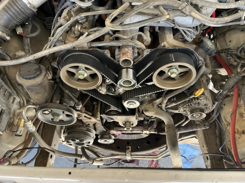

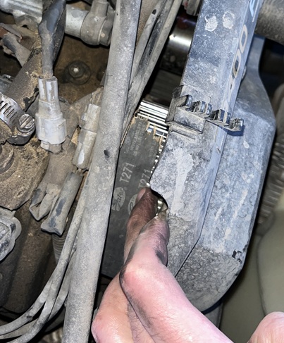

Last week while driving to work my engine shut off. Coasted down the freeway offramp and pulled out my little obd2 scanner, and got a P0340 Camshaft Position Sensor. After a quick look under the hood and not seeing anything obvious, I called my friend to pull me the last mile to work(a Toyota pulled by a Jeep - humiliating).
After work, I borrowed the company van to get my tools and came back, thinking maybe there was a wiring issue or the sensor went bad - and after about 3 minutes of disassembly I saw a broken timing belt. Yikes. Completely my fault for putting that off so long.
Watched Timmy's timing belt video and bought the aircabinman kit off Ebay, plus the SST for holding the harmonic balancer and the camshaft tool. Trailered my rig back home and started taking everything apart while I waited for parts to arrive. Unfortunately I think my harmonic balancer tool got stolen off my porch, but I just used the old starter bump with a breaker bar trick to great success.
Install went incredibly smooth thanks to Timmy's video. The only time I didn't follow the video was installing the timing belt - I put the tensioner pulley in after the belt and it was way easier than levering the belt into place. Without the harmonic balancer SST, I had to rig up a sketchy solution with my camshaft tool but had no problems getting the crankshaft pulley bolt tightened.
Really can't thank Timmy the Toolman enough. I've been watching his videos since I bought my 4runner and they saved me a lot of time and headache on this repair. Our taxes should go to him lol
