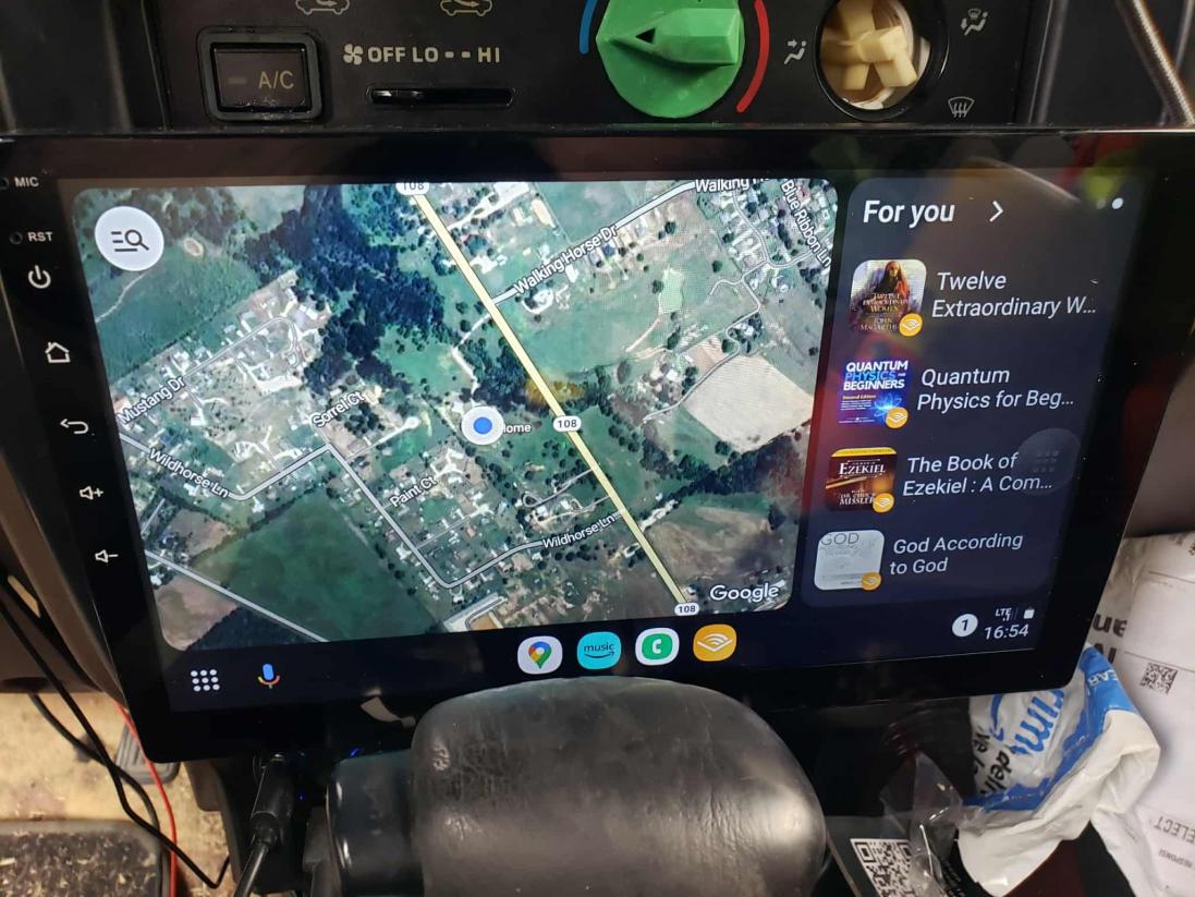

Still need to finish cleaning up the external USB and mic wires, toss the packaging from the various crap to help make it happen, and find where I dropped the other A/C knob, but with some creative bracket design and 3D printing, I got a 10" Android stereo mounted in the 98.
I ran a hot wire from the battery to under the center console and installed a fuse block to add charging ports in the front and at the rear door. Found a really nice panel on etsy to install in the back.
