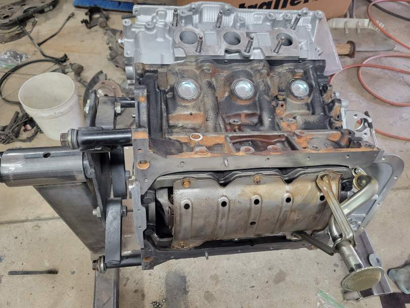

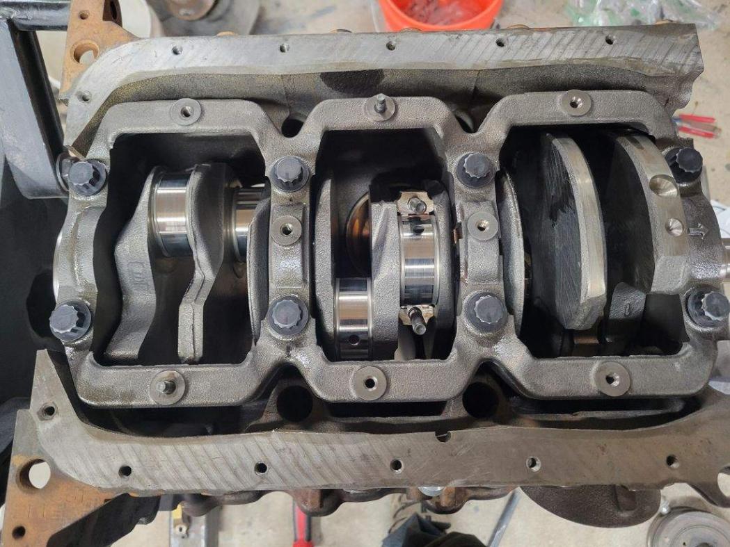

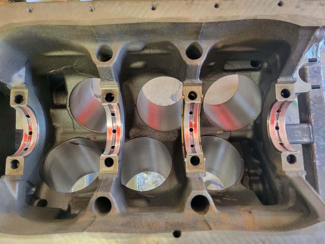

This is a very low mile engine, that sat for many years, I picked up from a guy that started a project and never completed. He had the heads rebuilt and was going to slap just run the block side as it sat. I only bring this up to make the point the bottom end was is really good shape, all the bearing could have been reused but being this far in it was better to just finish it correctly IMO.
The block needed to be resurfaced to make sure the MLS head gaskets had a good RA and because visually it was clear it needed a fresh surface. Had the crank polished and replaced all the mains and connecting rod bearings with OEM Toyota bearing with the same numbers installed in the block. Reused the original piston (again in great shape) and just had the cylinders honed for a standard bore ring set.
