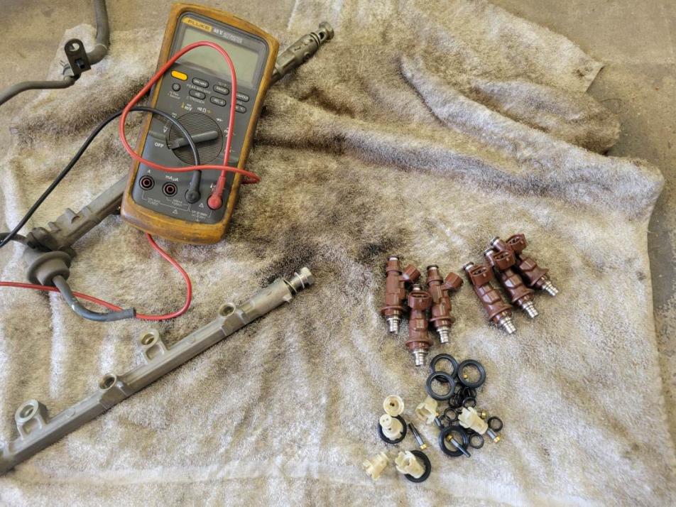

I have Midwest injectors sitting, and I'm starting to notice a slight rough idle. 250k miles on oem injectors, I'd say they worked hard enough. Decided to ditch the pre-made power station dohickies as the ones I want are all over 1k$ now. No thanks. So I'll build my own "house" battery. Also got to start on the sleep platform thingy.
