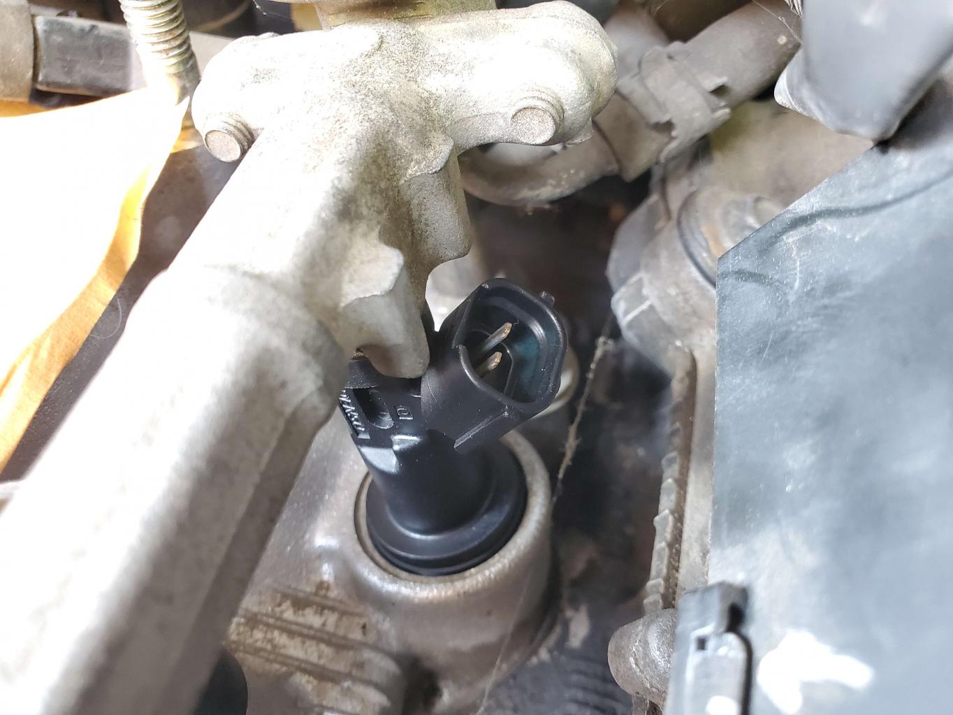

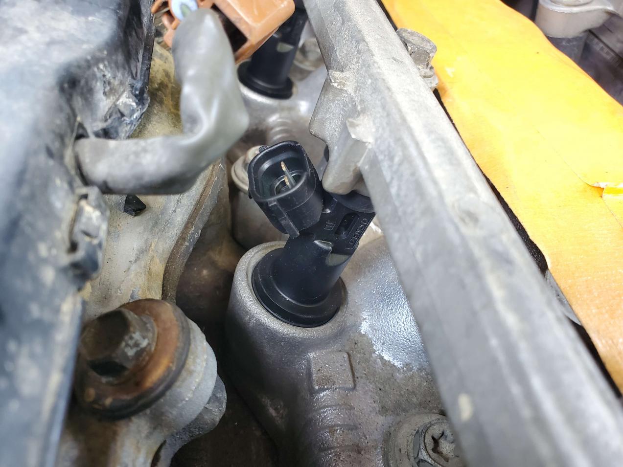

Well finally had the time to install the motor west injectors. Everything went smoothly, perfect weather, no leaks afterwards. Like a kitten, it purrs! It is so much smoother both in idle and driving around. I guess my oem injectors were going out for a bit now. Now next project is to finish the e-fan swap.
How did you get your valley in there so clean?
[MENTION=588857]OpenYota[/MENTION] a few years ago I had to replace the lower intake gaskets as they rusted out (head to intake). During that time I did a ton of cleaning. Now I just wash it out and blow it dry. It was filthy, really bad.

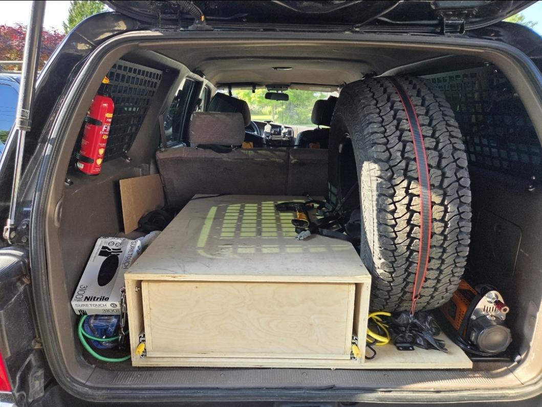

Made a little drawer system for my camping gear and for a place to store the spare since I dont have a rear swing out bumper

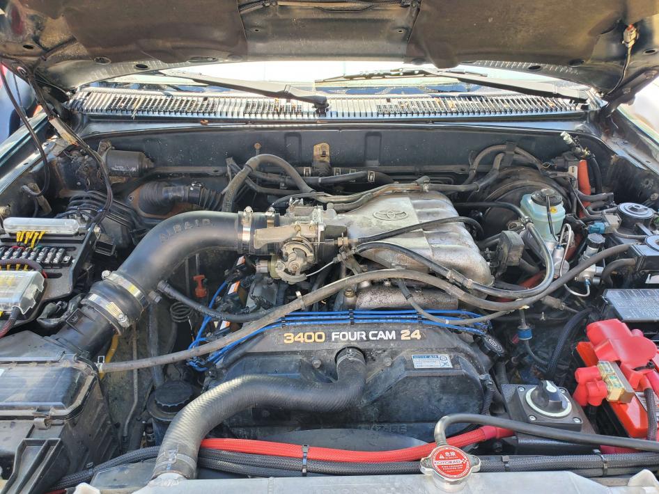

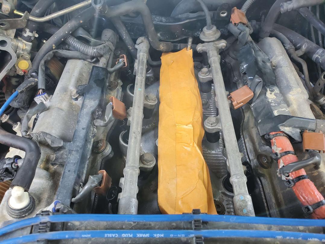

Changed out my aftermarket (unbranded) fuel injectors for some Denso's I pulled off of a 2003 Lexus RX300. I had them cleaned and tested by Motorwest Performance :)
My rich fuel conditions disappeared instantly. Yet another endorsement that aftermarket injectors aren't a wise investment. Mine were GB Remanufacturing, completely unbranded.
If pinched for money, the Lexus RX300 injectors were $85.48 from my local pull a part and MotorWest charged $160 for the cleaning / o-ring replacements. Sure, I took a gamble that the junkyard injectors were / are good, but the overwhelming opinion is that those Densos are indestructible, hence MotorWest using them as their stock replacement for 3rd gen 4Runner fuel injectors. The grand total of $245.48 is only slight more than the cheapest option on RockAuto ($172.74 without core charge). I wish I had done this previously.
+1 for MotorWest Performance services, another warning about using aftermarket injectors.

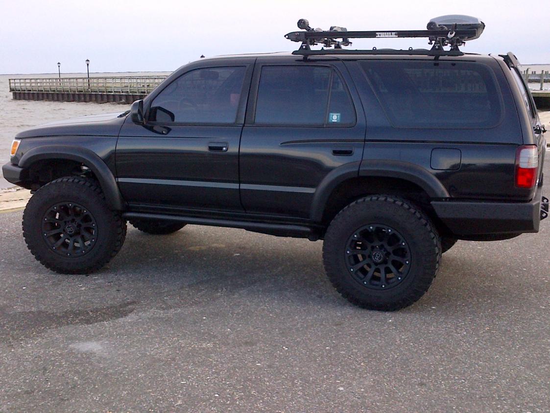

I'll just add that having my last alignment tech set caster to 'Max within Spec' fixed 99.5% of my rub (rear of fender well when stuffed and steering locked). I have mild 5100 lift/33" pizza cutters/1.25 spacers/methods w 4.5 BS/0 OS (standard for 16" toyota wheels they sell).
