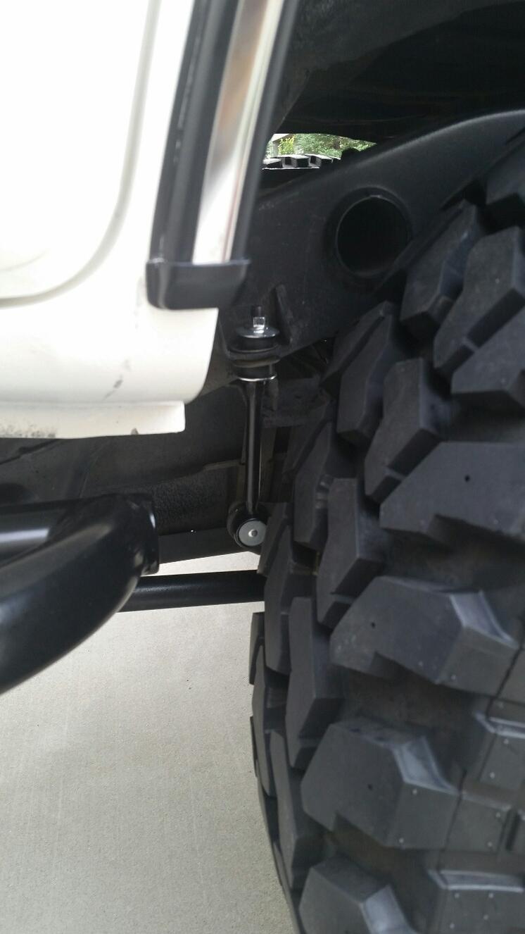

Longer rear sway bar end links
Finally got around to this project today... New order Aftermarket '98 front links used for rear. Did the trick nicely. We'll see if they last. Considering I never broke the shorties even off-road with a lift maybe these will also hold out. FWIW: Each kit only came with top and bottom cup washers. So I salvaged the two each from the old set where it passes through the frame mount top and bottom. You can tell by the color in the picture. YMMV...

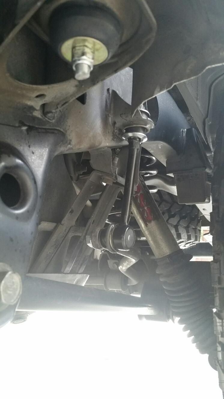

It took a while, but my friend and I managed to install my lift today/night. King 2.5 extended travel coilovers, SPC Light Racing UCAs, SS 1.2 rear lift and SS front drop diff spacers, MStudt's front extended sway bar links... and I guess that's about it.
I have an appointment to have it aligned tomorrow morning at Firestone. I hope they can figure out the SPC LR UCAs. I will bring the sheet in for reference.

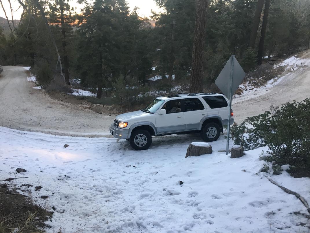

Took a drive up to big bear :) girlfriend planned a whole thing for my birthday and wanted to off road. Lucky man.

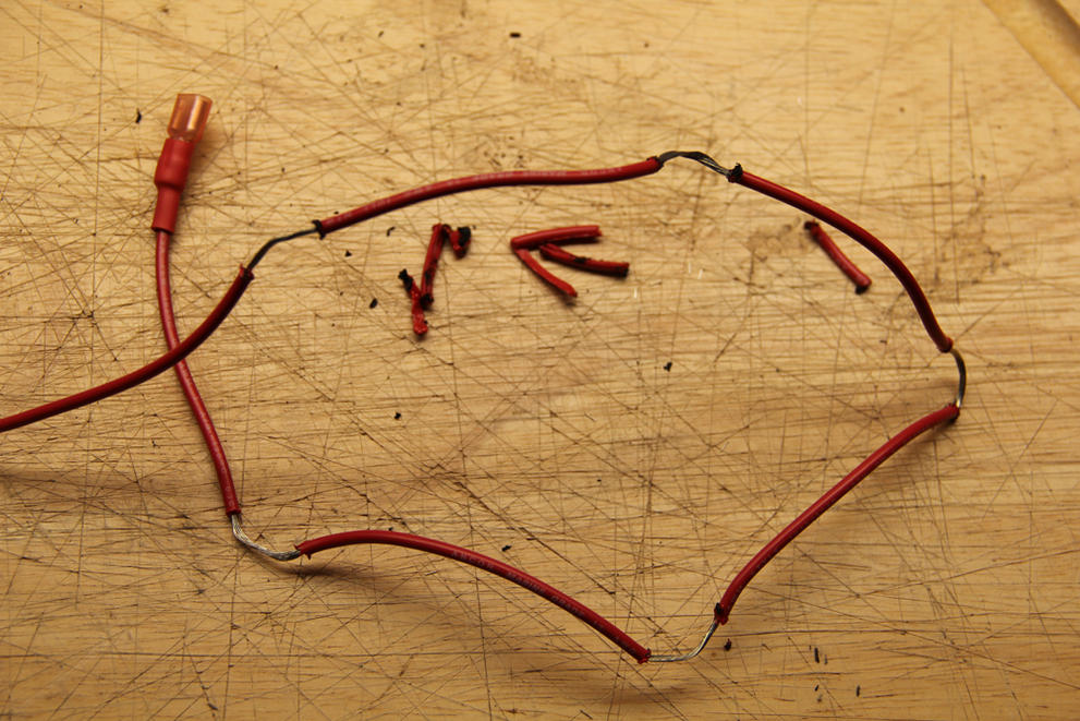

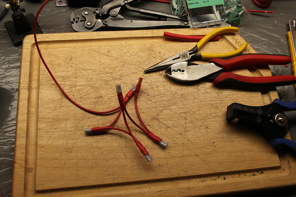

You can either cut, twist, solder and crimp or do it the way I did as seen below. Just strip off a section of wire, bend, twist and use a 14gauge connector. I like this way the best.
Photo of the end result. I made two daisy chains; one for the positive side of upper lights, (always on or switched) and one for the negative side of both dependent and independent lights.

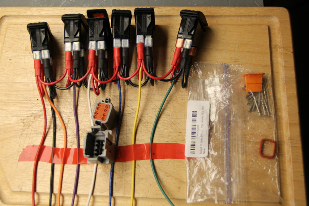

Here's a good look at each individual switch and the wiring. Notice the color coded wires. All 18AWG since they're just switches on this side of the firewall.
Finished product with a two-foot length harness, braided with heat shrink and an eight-pin Deutsch connector.
