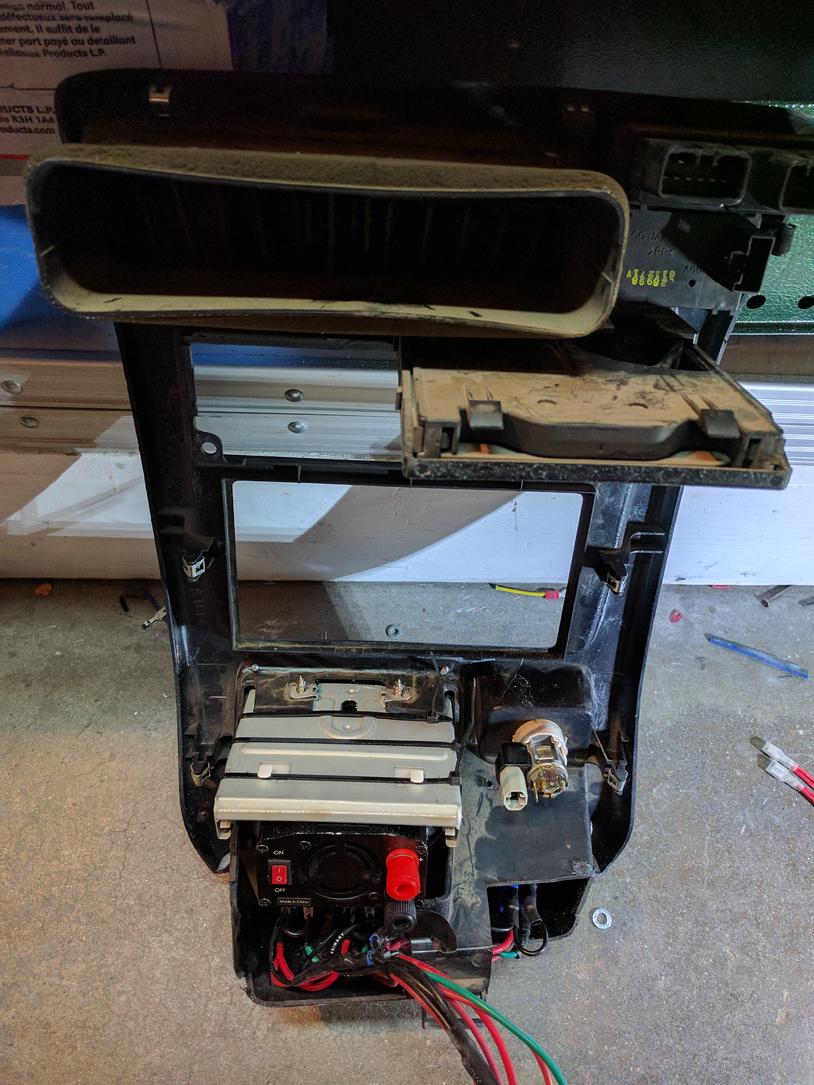

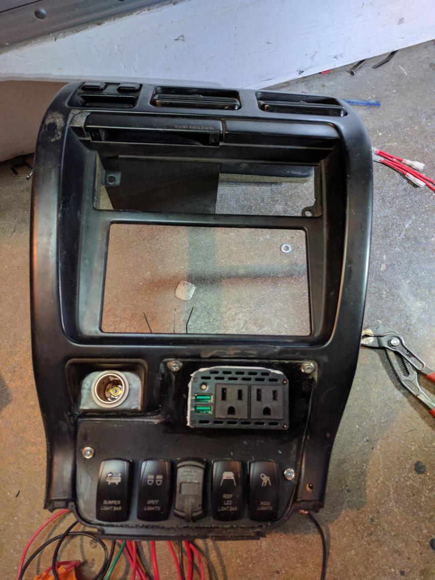

Ok. Now I'm really done. I had this idea to put something in my center console mod void where the ashtray was. I hadn't exactly decided what that would be. More switches, a CB? So while I'm painting it last night I look in the arm rest storage for some reason. There's my little 300w inverter. I use it all the time camping to grind my beans for the french press. Yeah, I love my coffee.
It looks like the right size. Yep it'll fit. Oh, wait. I still have that ashtray holder somewhere. Yep there it is. 30 minutes of grinding and dremelling later and it's a done deal. Once the DAP dries it gets some touch up paint then installed. I still can't decide if it's cool or really friggin cool but it will be useful. lol

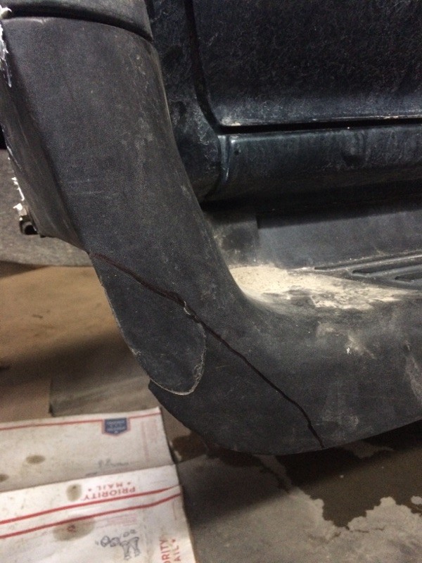

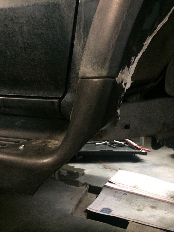

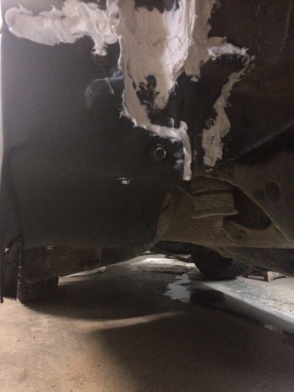

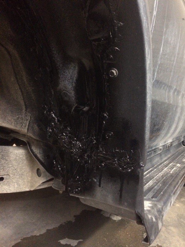

Cut up my front running board end caps and sealed the inner fender liners. I was going to modify some plain mud flaps, but these were actually a perfect fit. I could not get any large flat plastic mud flaps to mod....I live in bum fack so where...so I made it work. I cut the bottom loose from the sides, heat gun molded the bottom, and it lays perfectly along bottom of body to running board with some self tapping screw help. Cut the side to match and I have the needed clearance for my chains...and no more mud all over the side to the roof of the rig.
