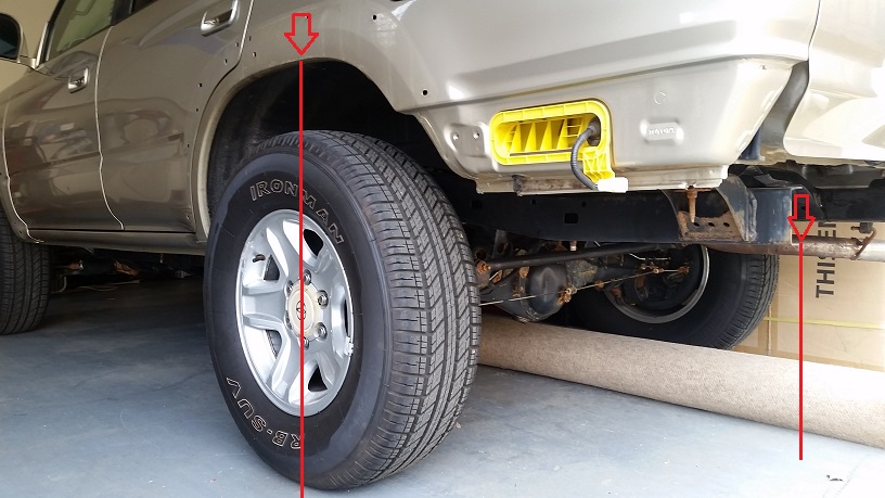

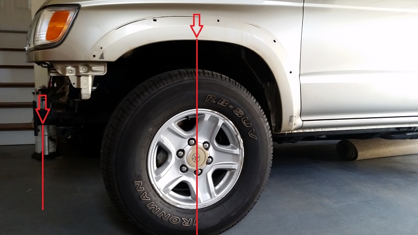

Measured heights
1) Unloaded
L <> R
Rear Fender 35 1/4 <> 35 1/2
Front Fender 34 1/8 <> 34 5/8
Rear Frame 21 <> 21
Front Frame 18 5/8 <> 18 3/4
2) W-full gas tank and bumpers, underbody panels, running boards, hitch & spare tire set back in or on the 4runner:
L <> R
Rear Fender 34 1/2 <> 34 1/2
Front Fender 34 <> 34 1/2
Rear Frame 20 <> 19 7/8
Front Frame 18 5/8 <> 18 5/8
