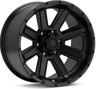

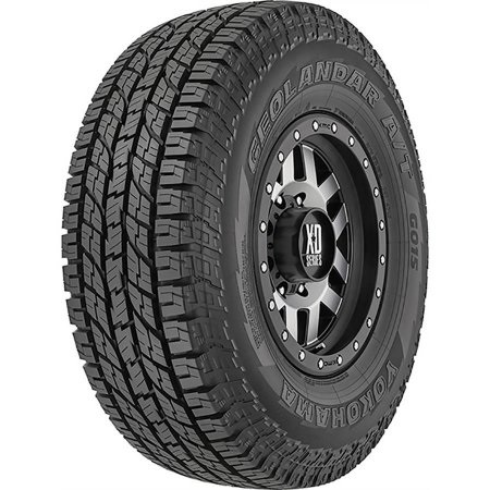

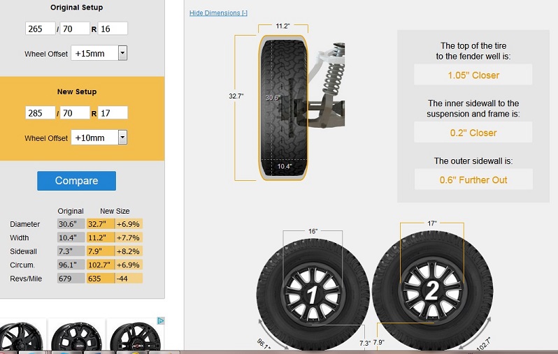

Yokohama Geolander G015 285/70R17s (45 lbs) on Ultra Crusher 17x8" (25 lbs) alloys. This I spent probably 30 hrs investigating my options and learning what variables there are. Larger wheel = more overall weight all other things being equal, which = slower accelleration, breaking, and fuel economy. More sidewall = more cushion but less responsiveness. More width = more off and on road traction, but worse accelleration, fuel economy, hydroplaning, potential for rubbing. I targeted tires that were not heavy to start (for on road driveability; accel & fuel economy), designed for offroad use, good in winter weather. I then looked at options with ~32" diameter and width slightly > than OEM. I don't think I have to worry about hydroplaning with all the extra weight I am adding... Anyways, I settled on the Yokohama Geolander G015 285/70R17s (45 lbs) on 17x8" (25 lbs) alloys. +2.1" diameter, +0.5" tread width, +0.3" sidewall, +430lb load rating over OEM, but the combo does add ~12 lbs. Also, the wheels have a 10mm offset (vs 15 mm for the OEM), so the outer edge of the tire will extend out 0.6" further than OEM, which is fine since the SR5 I have came with wheel flares that should still encompass outer edge. I am hoping that, with the lift and modest increase in the diameter, rubbing will not be a big problem. We shall see...

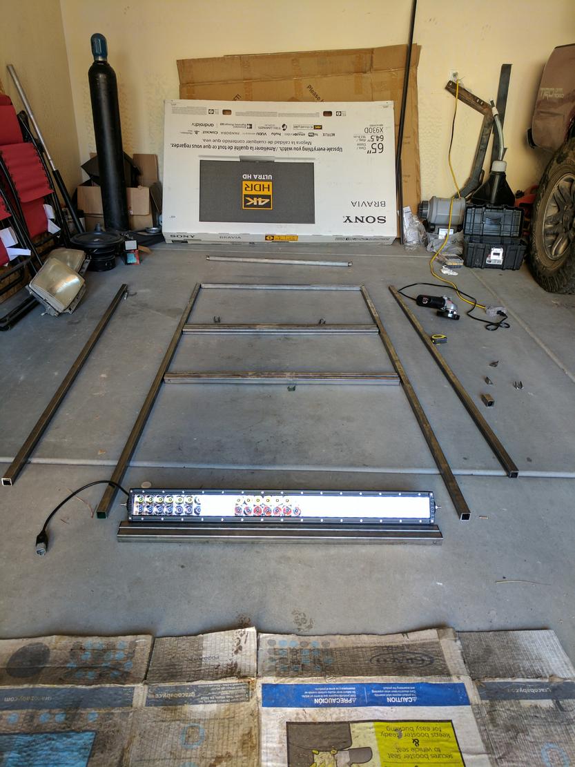

Boyfriend worked on the roof rack today! Probably two days of welding and it'll be done!
