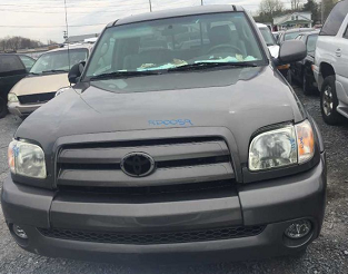

Picked up a pair of Tundra calipers for my 4runner on ebay for $100. They were advertised to be from a '05 4x4 Tundra that had only 92k miles on it before it was retired to a junkyard in MD. Hopefully they will be in good shape.
Donor puppy looks so sad ... :violin:
