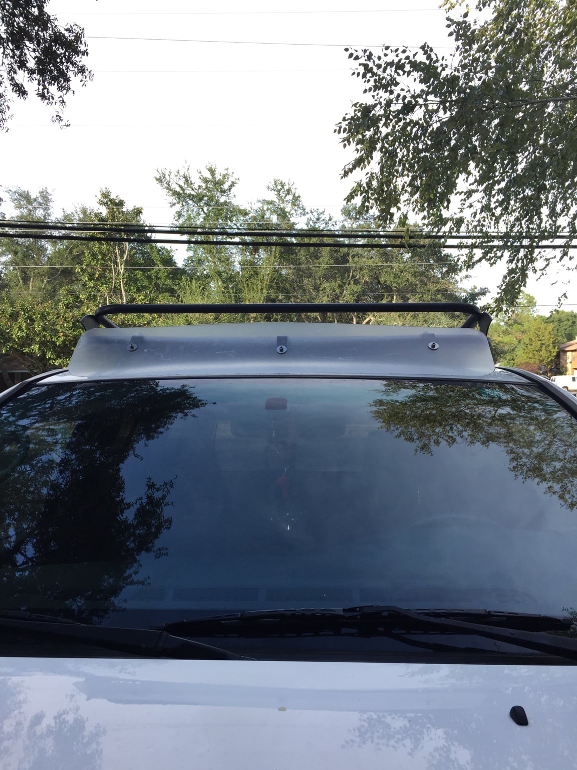

Finally got some time to cut out a fairing. The brackets were a little tricky but the Test fit was perfect and the test drive was quite. Time to paint [emoji106]
what kinda material did you use? where did you get it from?
I just did mine two days ago on my WM rack. I wasn't as lucky on the fit. I also still have a lot of wind noise. The vibration sound is gone, but not the wind. Have you taken it up to 70+ yet?

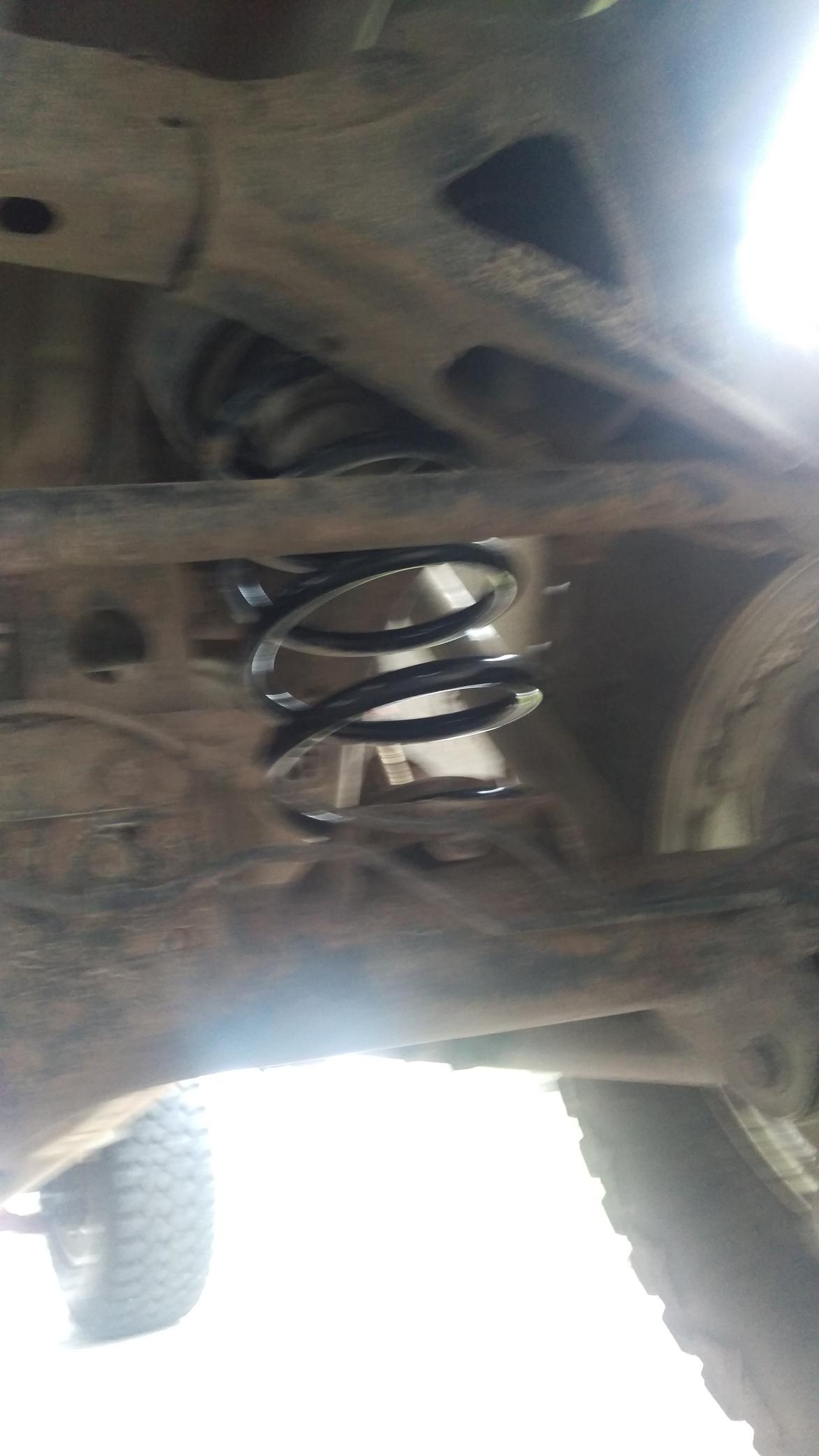

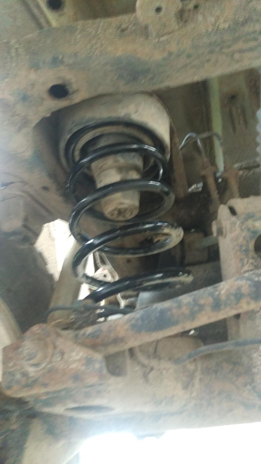

Put FJ coils in the rear, gained a solid inch I also put that bump stop that goes inside the coil back in as I had mistakenly tossed it away back when I originally lifted my truck. Doh! uploadfromtaptalk1446248326539.jpguploadfromtaptalk1446248343817.jpg

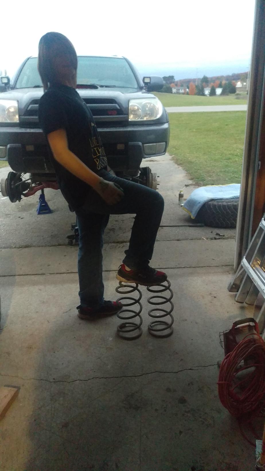

My son holding the old ones like captain Morgan. Lol

Have your son strap them around his shoe and try walking with them, or see if he can dunk with them "nike spring air's"
So now you got the rear in are you doing anything to the front tonight as well?
So you know you gained an inch what are you sitting at total in the rear now

Lol, I'll tell him but I'll bet he's to chicken! Lol
I am putting a spacer in the front and lowering the Bilstein. I tried setting the shock at. 85 and putting it in with a 3" spacer but I was binding the cv up. Going good to set them at 0" tomorrow.
Also will be replacing tie rods tomorrow as mine are shot. About 1/2" of play in them now.
Will be more on my build thread too.
