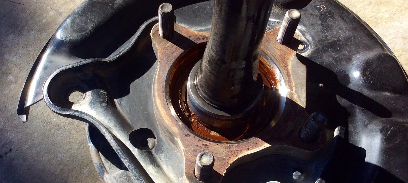

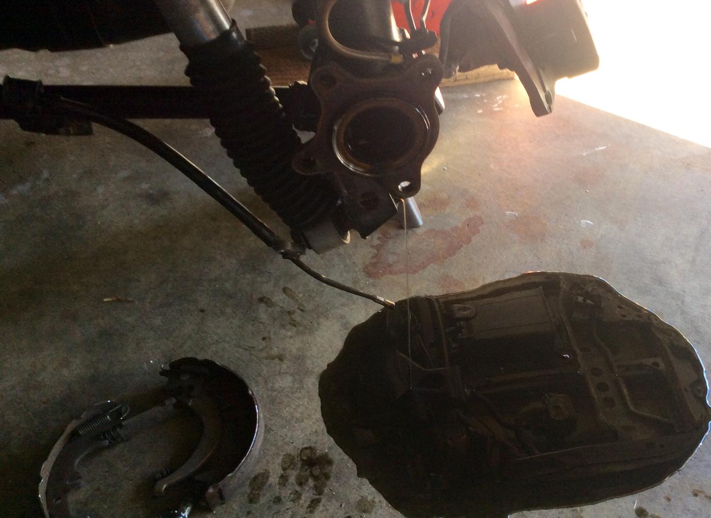

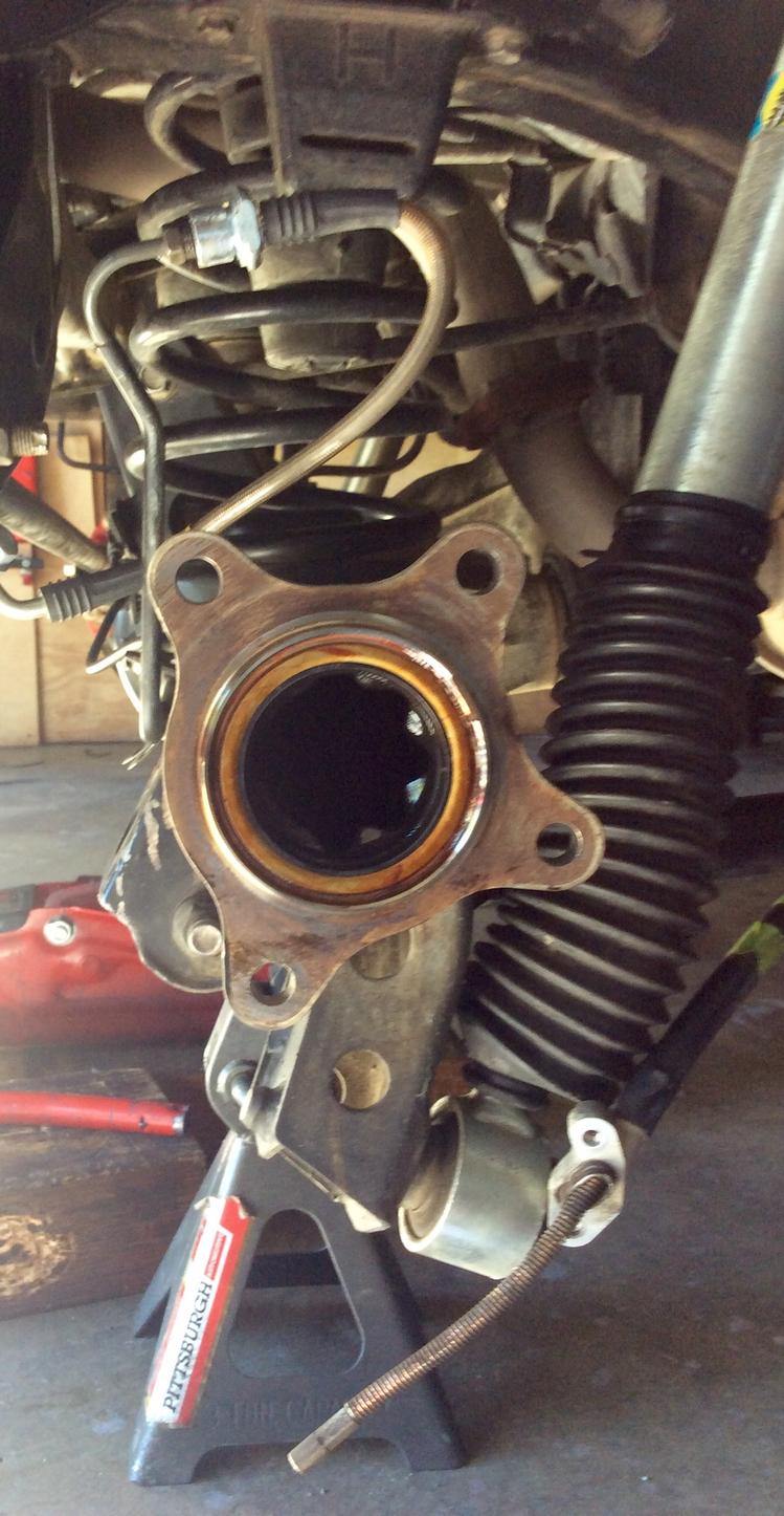

Well I finally changed out both of my blown rear bearings and all new seals and components. While I was at it and had everything torn apar,nI also decided to install new parking brake shoes and complete new hardware kit, and while I was still at it I might as well fresh in up my rear brakes so I installed a complete rebuild kit along with of course some new brake pads. also flushed Out my brake and filled with all new and drain my diff and filled with new.nand of course to top off my my complete new rebuilt rear end/axle I also got her some new 4"stilettos 285/75/16 she went bigger 2" heels 265/75/16 and I must say she fills them in very nicely.
So new parts installed
..2 Rear Wheel Bearings
.. Seals,retainers,clips
..parking brake shoes
..parking brake hardware
..rebuilt calipers
..brake pads
.. Ss brake lines
..Brake fluid flush
.. Tires 285/75/16
..differential fluid changed
Pic of blown seals just as I pulled the axles,
Pic of blown bearing if you spun the hub or shake the hub you could hear the bearings shaking inside and when I pressed them out a couple rows of bearings just fell out and was just brown sludge inside

I will never touch the parking brake components on one of these 4th gens ever again, this is the only thing I have ever said I won't touch again and this will be also the first time I would say I would pay and allow someone to work on my rig.
That design is a F ing nightmare, never again. I will just go without a parking brake if there's ever an issue in the future.
