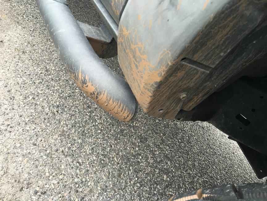

Gave it a permanent "mud" look. Haha. Ran through some wet paint. Good thing us a majority of the paint got on my unpainted parts of the runner. Now the tedious job of peeling off latex paint and getting it off my tires.
