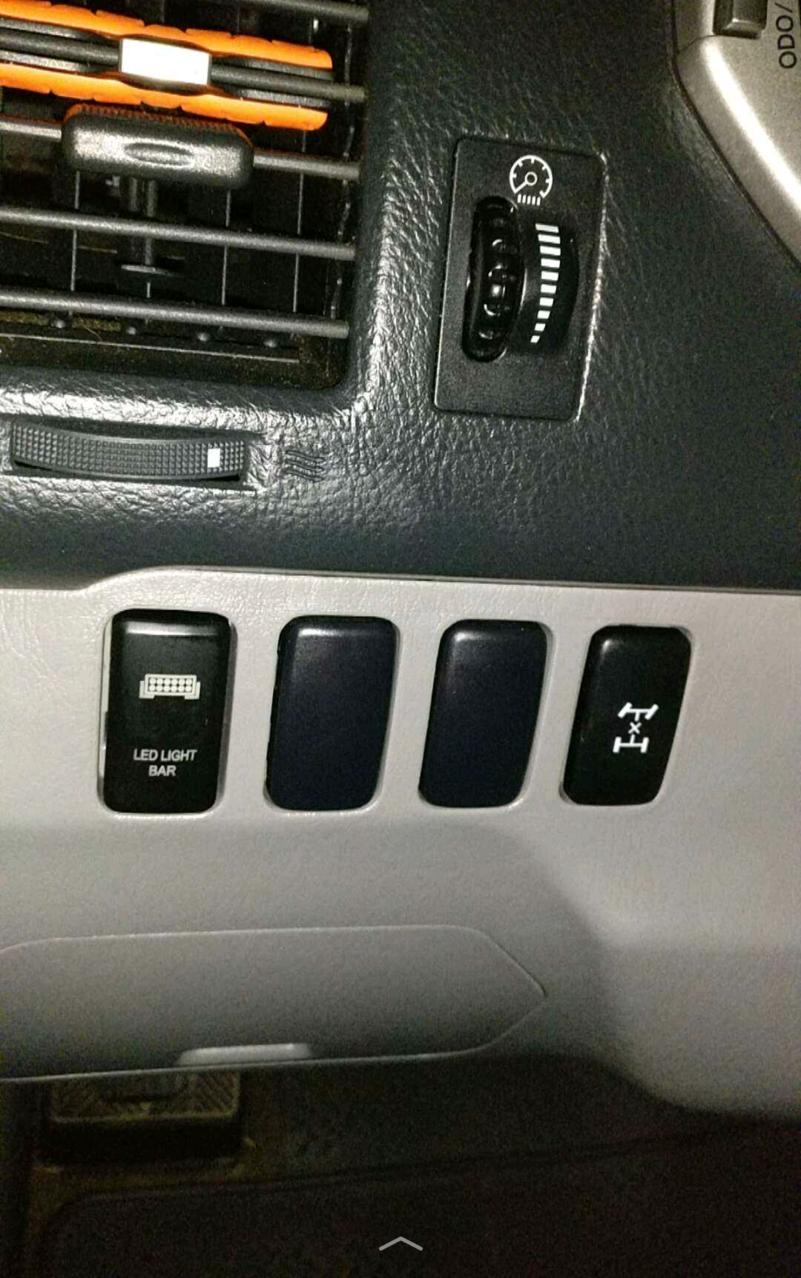

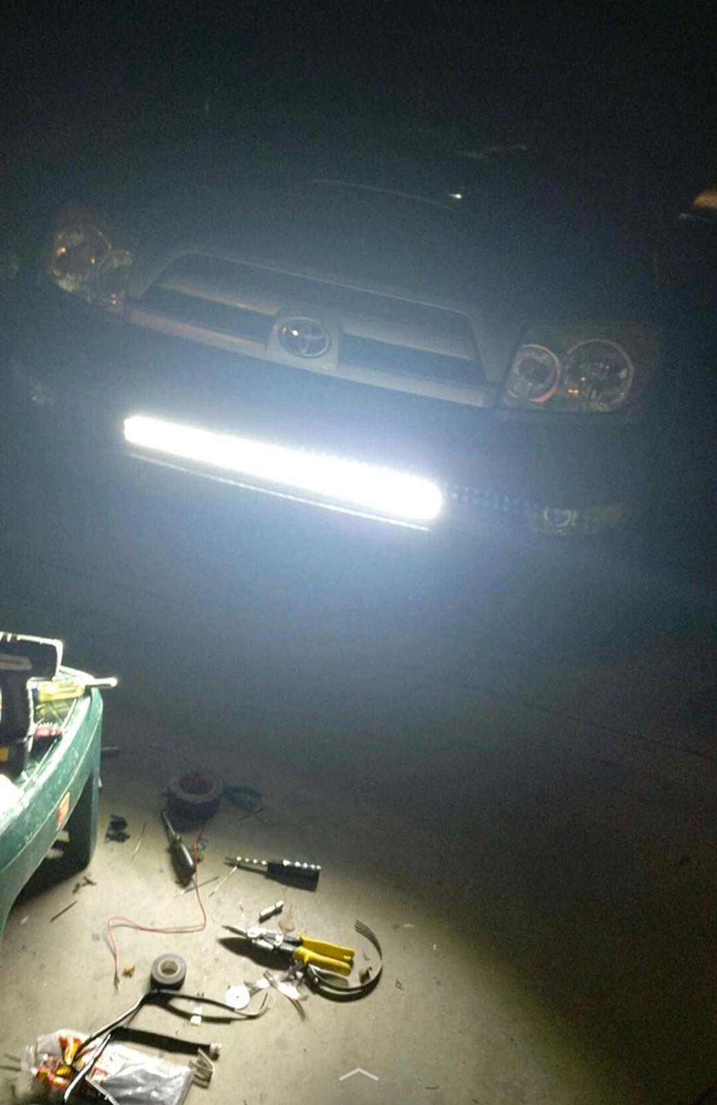

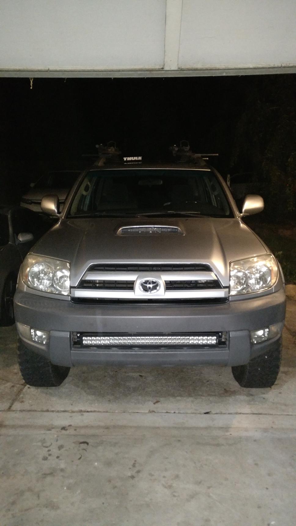

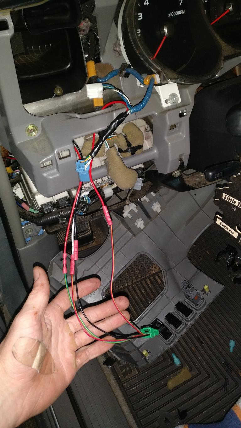

Installed a 32" light bar into the front grill. Took a lot of experimentation to get it mounted, and a ton of confusion and frustration to get it wired. I surfed forums for hours trying to figure out that the final wire went to on the switch harness. (Black to ground, green to positive battery, and red #1 to white wire from relay). Read that the remaining red #2 goes to a dimmer wire so that the switch backlight will come on with the dash lights, but didn't know which wire in the dash was the appropriate dimmer wire to splice into. Final answer, USE THE DARK GREEN ONE BEHIND THE DIMMER DIAL OR REAR WINDOW SWITCH.
In the end I'm happy with how it looks in the bumper, and the switch is nice although a bit bright.
