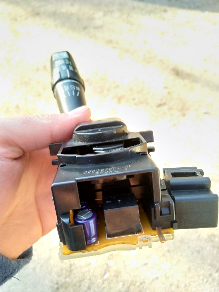

Replaced the relay on my wiper switch. Works great, but unfortunately the relay I bought is very clicky. I will see if I can stand it. Easy fix for only $9.
If you don't want a clicky one don't get the Panasonic JJM1-12V which was recommended as a replacement for the relay on the switch (now obsolete). There are probably others with a similar form factor.

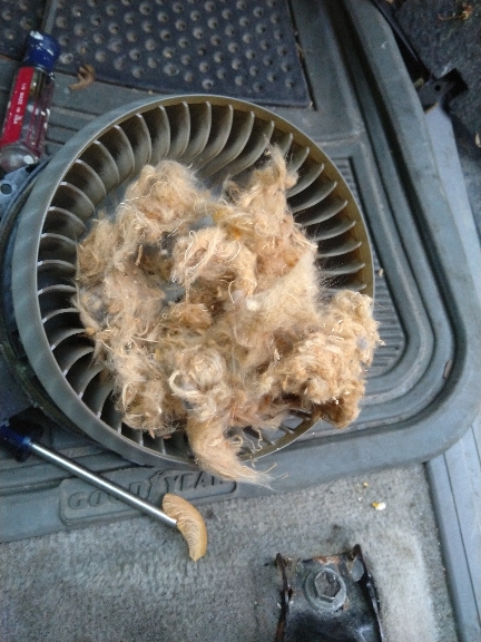

Also removed this from the blower motor today:

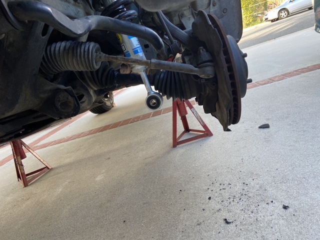

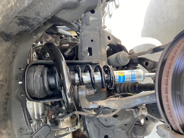

Replaced lower control arm bushings and ball joints
I had replaced the upper control arms with new ball joints and bushings, and took it to get aligned. Alignment shop said lower control arm bushings were shot, so got new ones, new ball joints. Took the LCA’s off, took them to the local machine shop and had them press the old ones out and the new ones in. Put it all back together and got it re-aligned.
Front end completely rebuilt now!

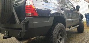

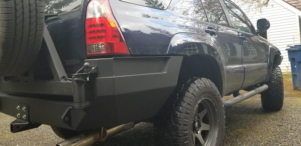

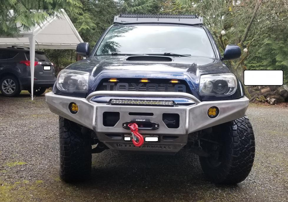

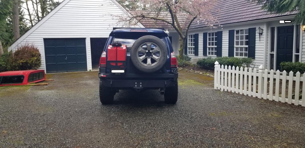

Installed new CBI rear bumper with single swingout, prinsu roof rack, and a couple of single row LED lightbars :)

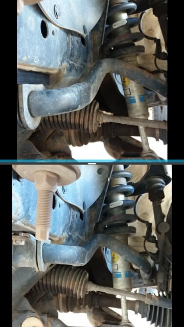

Installed a swaybar relocate kit today. It lowered the bar and moved it forward about an inch, giving better clearance to the shocks.

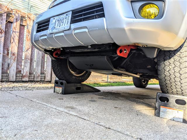

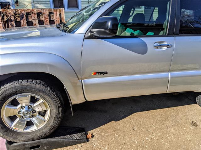

Now that it's finally warming up here in Wisco been trying to keep busy the last couple weekends. Started with an oil change with some good ol' Redline 5w30. Sprayed the radiator support and some other misc spots with Rust Reformer and some flat black Rustoleum. Replaced the SR5 4WD badge on the doors with TRD ones from Kempter. Threw on a Victory 4x4 front skid plate and Apex Overland recovery points while I was at it. Hoping to have time soon to finally throw on the Daystar lift, body mount chop plates, and the rear diff breather extension that have been sitting on my workbench most of the winter. Next on the list to order is the Bud Built hidden winch mount and right now thinking Milestar Patagonias 285/70/17s and some Spidertrax wheel spacers.
