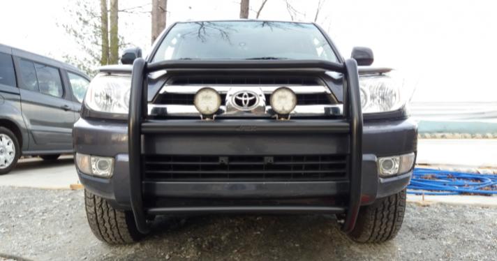

am a lil intriguied by your bush bars, did you mod the original design?..would you mind posting a full face on shot of the truck?
Was originally bars around the lights with 3 horizontal bars across those loops. Very 2000s. Blocked a lot of light and vibrated against the fender. It's stock add on brand ARIC I believe.
The lights hardly do much unless it's pitch black out and you want to see more in the woods near you.

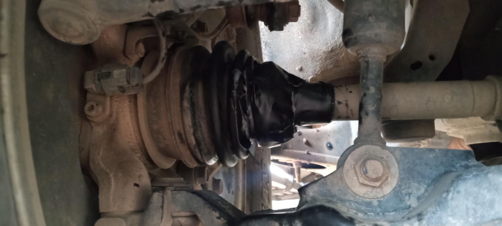

Added an upgraded, modified front right drive axle..
Not really. Just drove for a few years with a tear in the CV boot, forgot about it all the time, and then drove in deep puddles on trails for the past few weeks and then also on the highway, to make sure ALL the grease got washed out.
Heard clicking.... So I pumped about 50 or 100 pumps of grease in and wrapped in gorilla RV tape to hold me over.

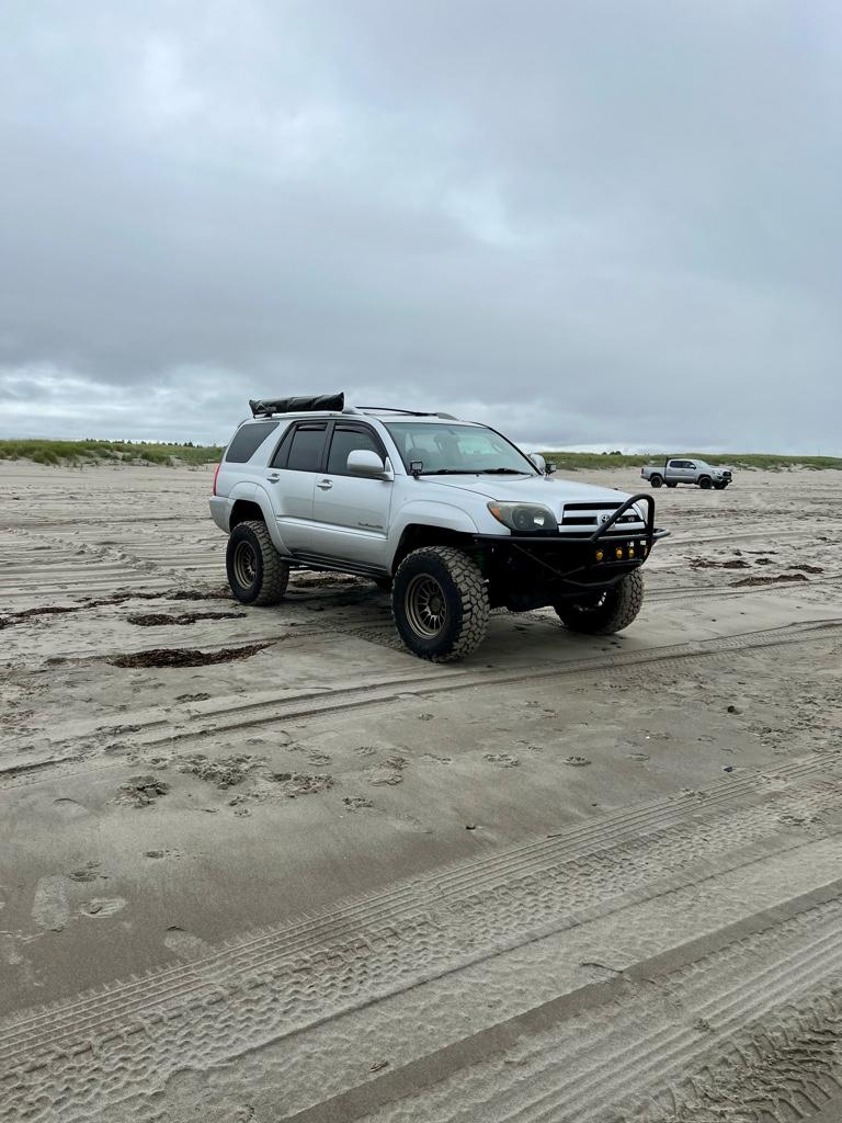

Took a beach trip out to Long Beach WA. Had a great time.
Tacoma friend out in the distance..

ok ggreat, i have similar brush guard....and the 3 horizontal part blocks my headlights output as well, would consider using a dremel to perform the surgery

The headlight bars just unbolt easily. No Dremel needed! Unless you are talking about the 3 narrow ones yea.

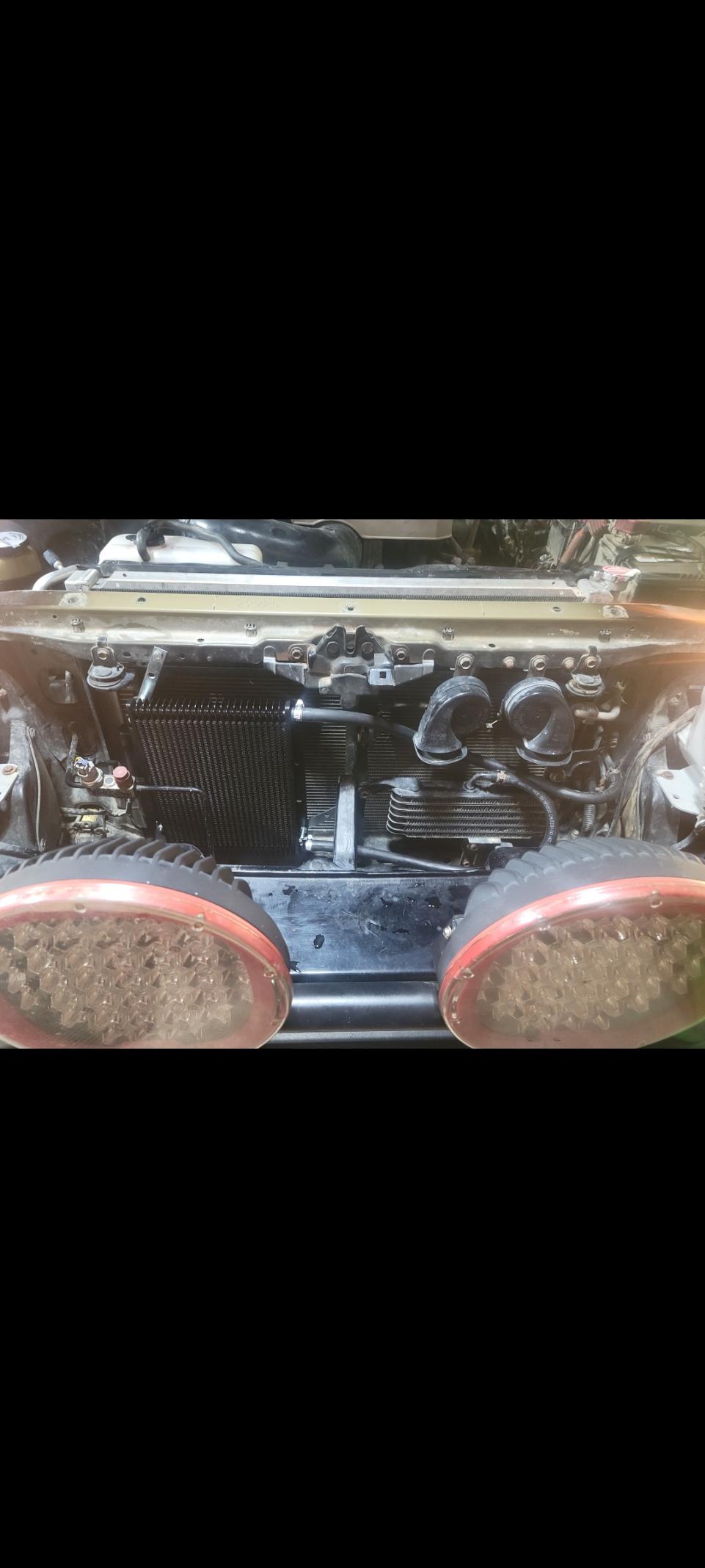

Added a second trans cooler in series with the factory one. My thinking... I replaced the factory radiator with an all aluminum KOYO radiator, which does not have a built in trans cooler. So even though I have the factory aux cooler, I wanted to make up for the capacity that was lost when getting rid of the radiator cooler. Tracking Temps with Torque Pro, I would get up to 220 sometimes sitting in traffic on hot humid days. We'll see how/if this improves. Probably overkill, but better than underkill.

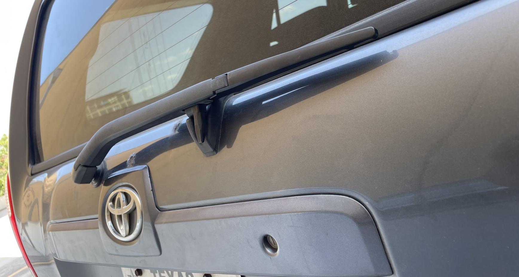

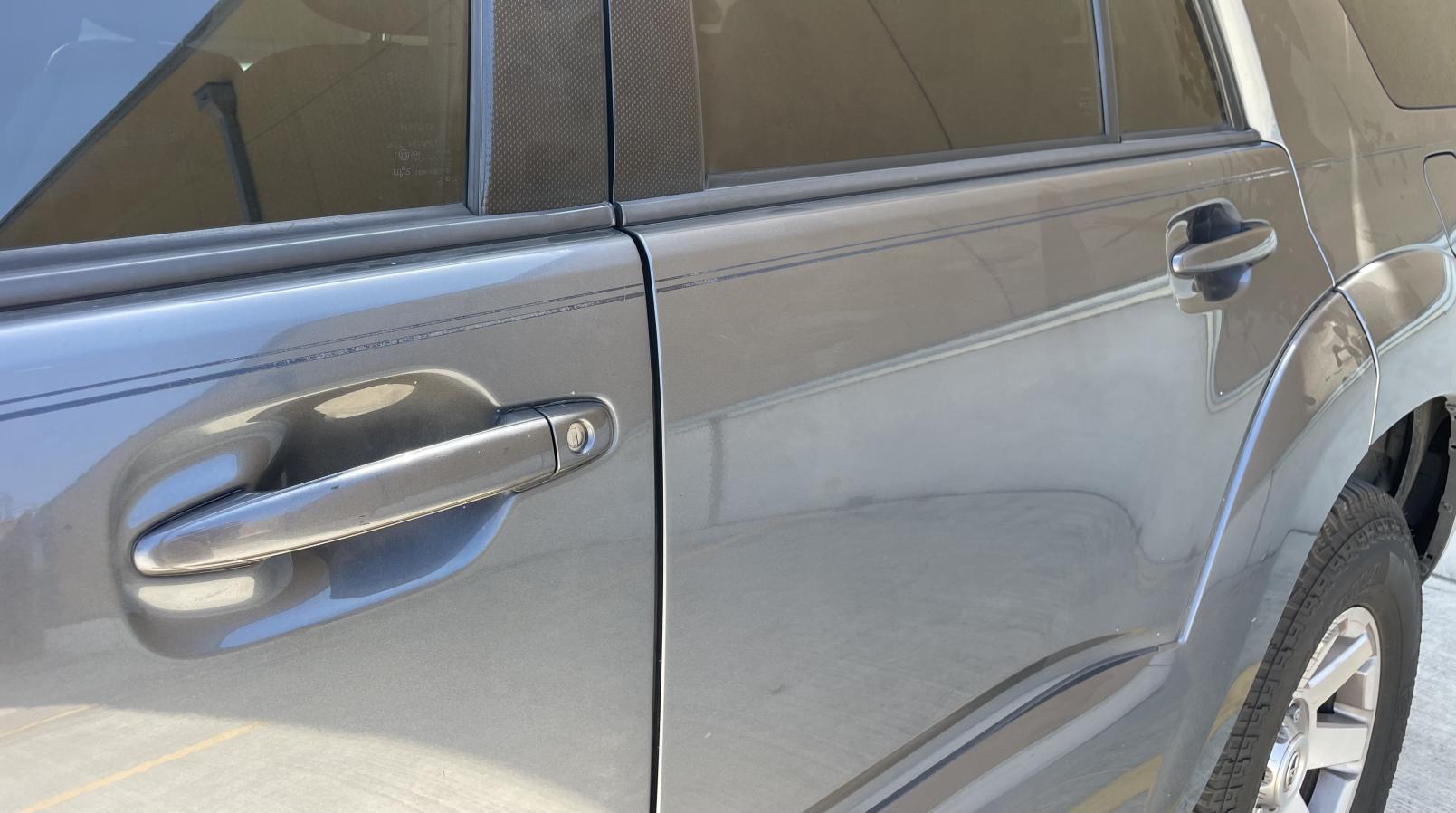

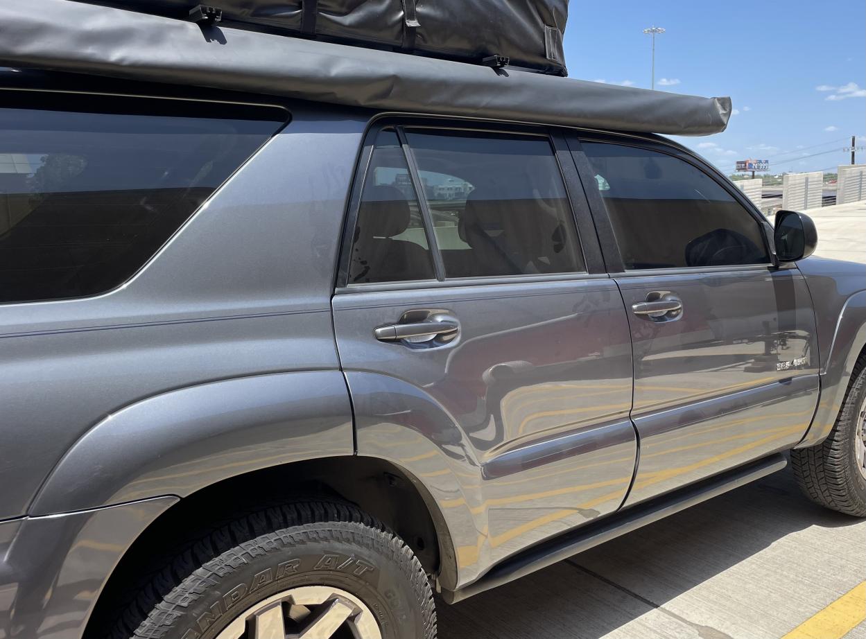

Swapped out 4 door handles, and rear trunk piece for colored matched ones. Also put in a new rear wiper blade.

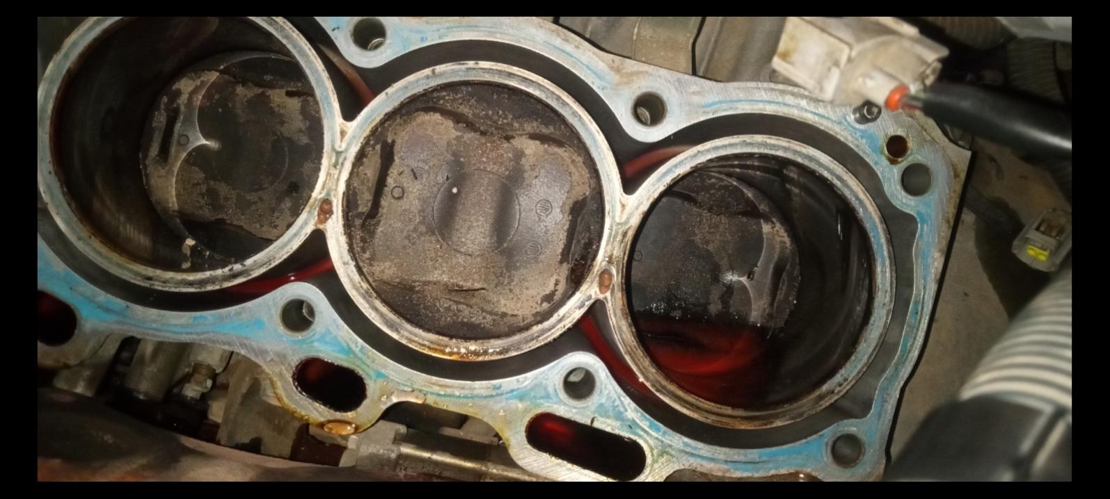

Enjoying my second head gasket repair on my 2005 V6.
Didn't have the heads machined the first time. Dumb me.
Now my 'dang waterfall noise' thread is solved.

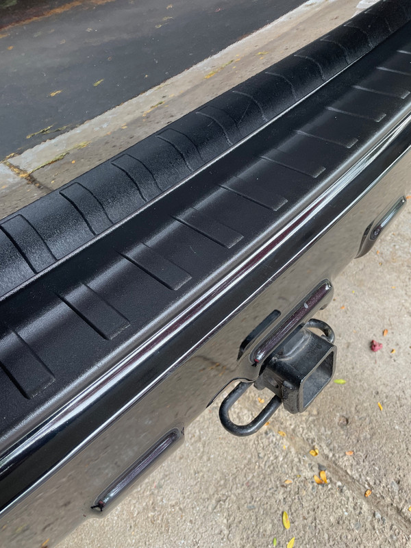

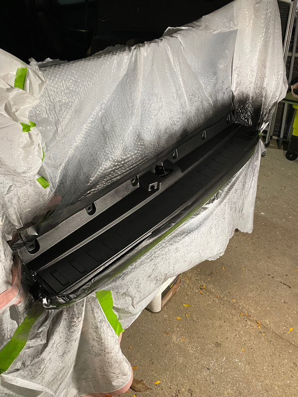

While not part of the interior, I did plati-dip the last piece of grey plastic on the exterior being the rear tailgate trim.

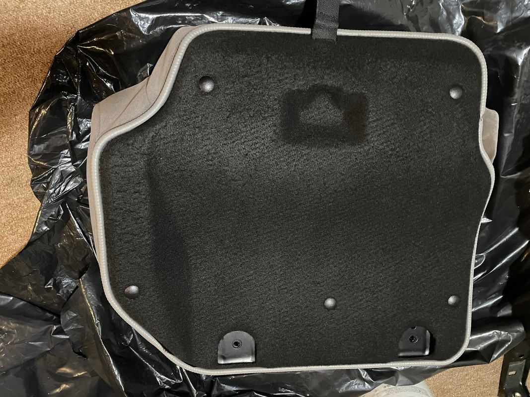

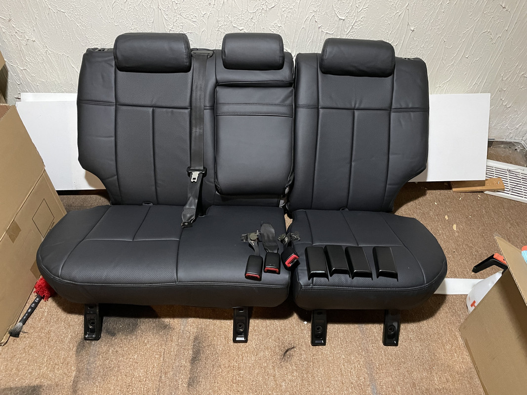

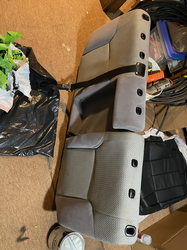

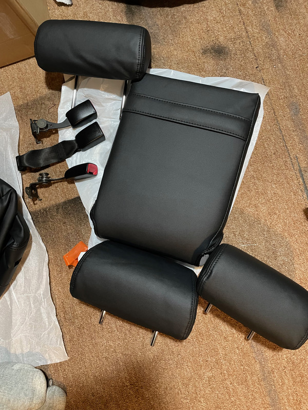

Okay, now the fun stuff, the rear seats and the Clazzio seat covers. These took a lot of extra prep painting the trim pieces and dyeing the seatbelts. I also dyed the underside so when the seats are down you don't see the grey carpet. I'm really happy with how these turned out.
You want to see them inside the car? Well there was one more thing I needed to do before installing them...

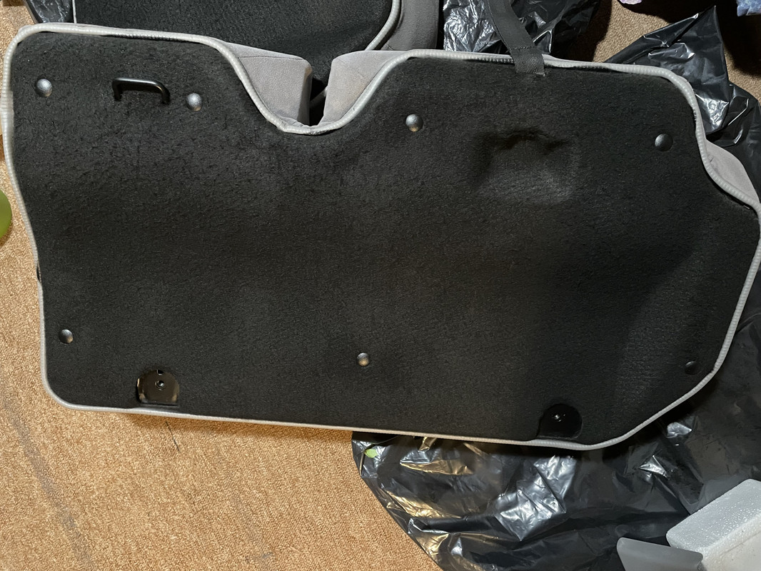

I started with the rear cargo area. This carpet can be removed but I chose to leave it in. I used dye in a condiment bottle to squirt dye on the carpet and then agitated it heavily with a nylon brush. This made an absolute MESS on the interior trim but luckily it was easy to clean with alcohol. And it's going to be black anyways I guess.
