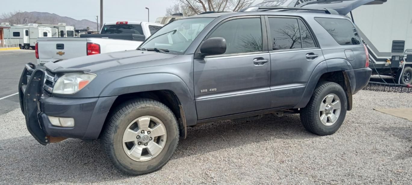

Got a 2" lift by just removing the bendy aftermarket side steps that were dangerous to actually step on and had a piece cracked out of them.

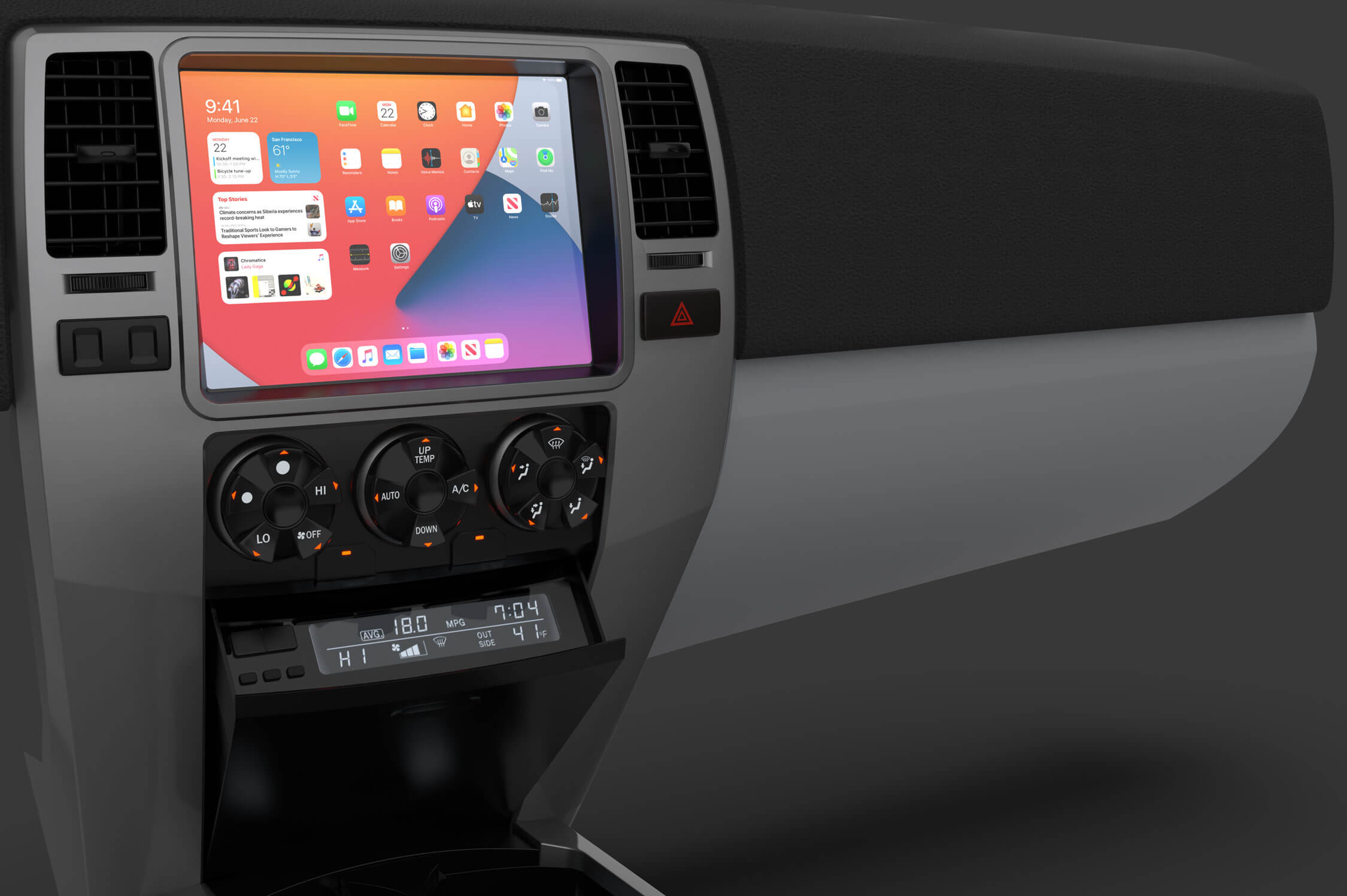

Sold my 4Runner last year, but found my old 3D model of the iPad dash I eventually built. My favorite thing I did to the 4th gen interior. Figured I'll upload it here in case someone ever wants inspiration for a similar build

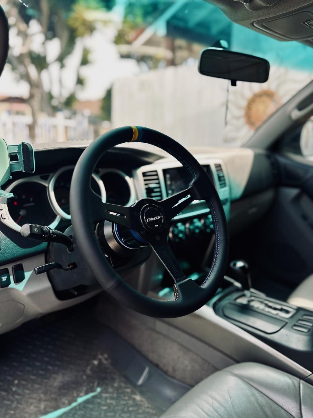

Greddy Steering Wheel
Theft has been hot, here in Los Angeles CA. So I decided to add an extra safety feature by installing this Greddy Performance Steering/ Quick Release combo. Anyone else have additional anti theft features?

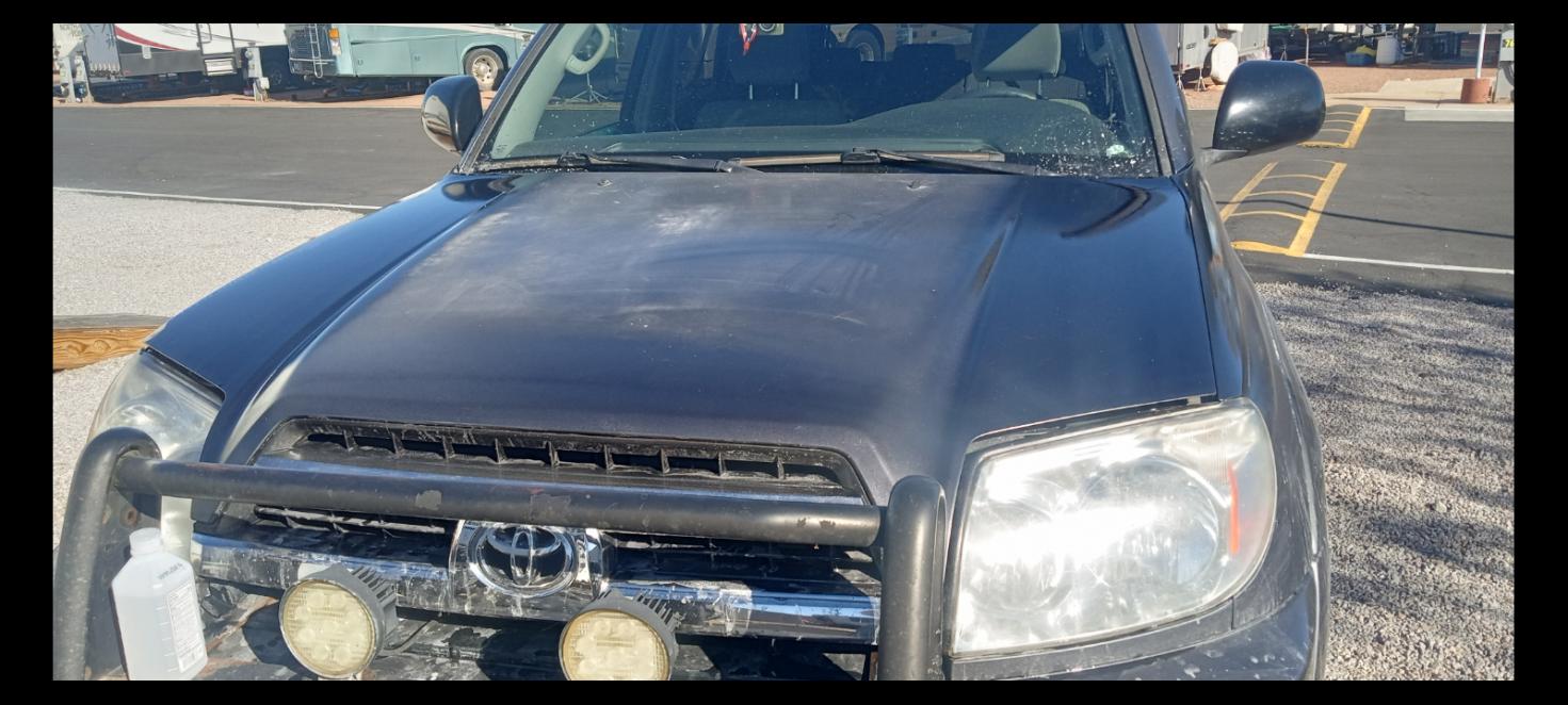

Did half of a half ass job painting my hood with color match paint. Got 2 cans of the Duplicolor for $17 each. 1 can does the outside of the hood. I wasn't sure if the paint would match enough, but the clear coat was so wasted, it is worth the experiment. I might do a black decal on the center portion or just scuff and paint the center and hope there is enough in my second can.
Clear coat with a few runs added for effect as well. As you can tell, it's near ready for a Barret Jackson auction.
