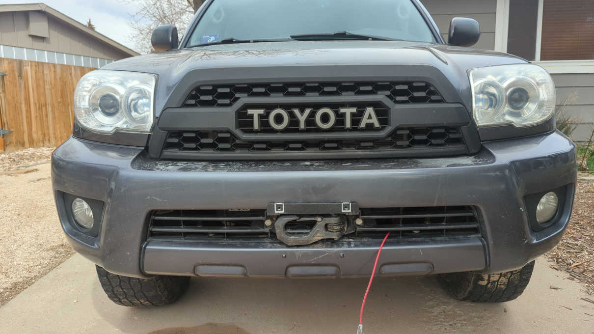

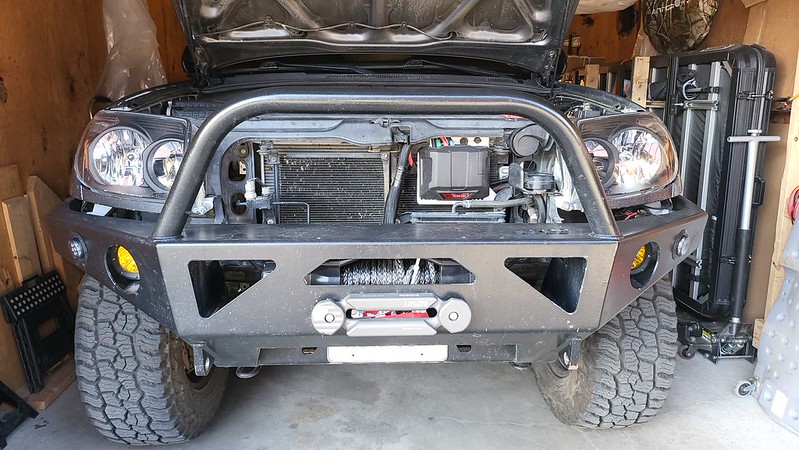

Back in December I installed the budbuilt hidden winch mount with a Warn evo vr-10 (with a HF synthetic line). I didn't take any pics, but installing the budbuilt mount was fairly straightforward and there are some other pics already on the forum. I relocated the winch relay to the top of the stock relay box, and clocked the clutch 90 degrees so the clutch lever is on top. I also had to bend the bumper support with a hammer to clear the lever, but I probably could have avoided that if I clocked it 180 degrees instead of 90.

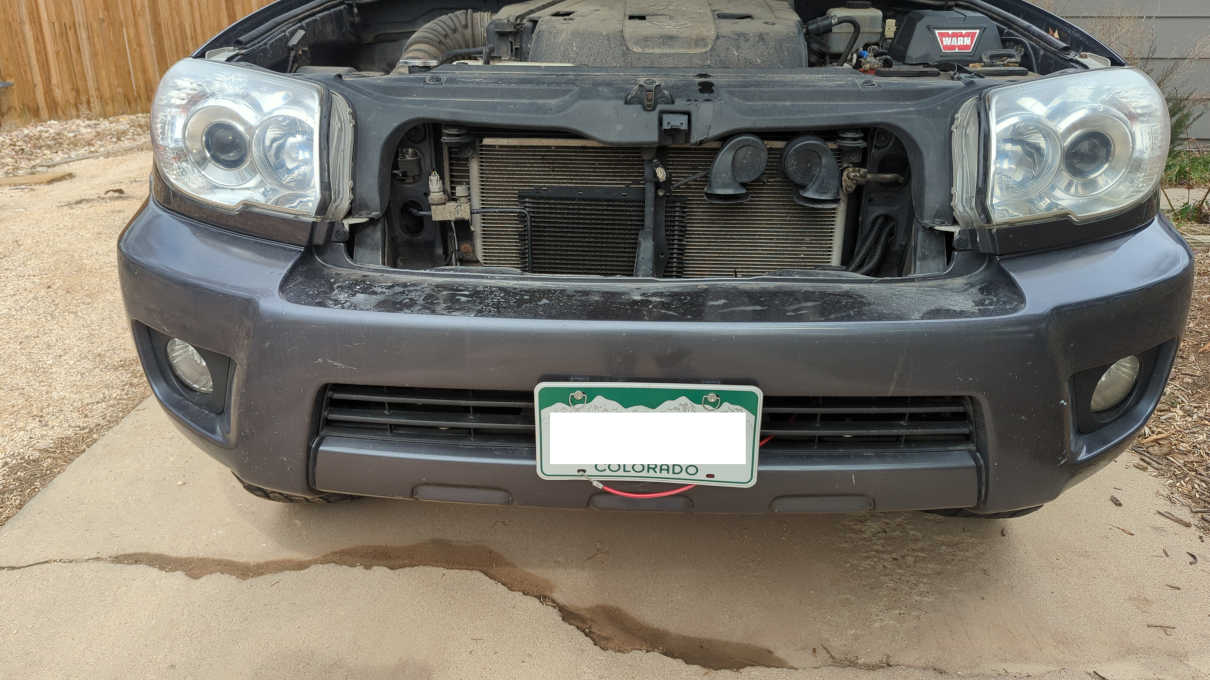

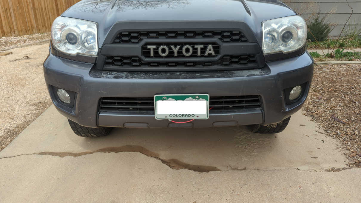

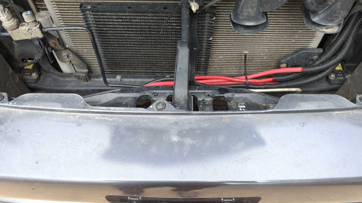

Then a couple weeks ago I designed a 3d-printed license plate bracket. I'm using the same bolts that originally held the black plastic "grille" in the bumper, but I'm screwing them in from the bottom instead of the top (inside the bumper) to hold on the bracket. The license plate is held on with 1/4 turn quick release fasteners, common on sport bikes and airplanes. I've also got a steel cable attached to the license plate, so I don't lose the plate if I hit something and break the bracket, and to dissuade theft. The only downside is it would rub the winch line if I have to pull upwards, but it would just take a few seconds to remove the whole mount with a 10mm wrench.

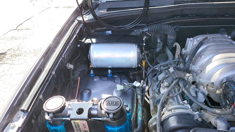

In the process of building out my onboard air system with 1 gallon tank. I had to create a custom bracket to mount the ARB Twin air compressor. This also required relocating the power steering reservoir, which also required customizing a bracket.
I think it came out pretty good. I need to make some revisions to the bracket, but it’s solid.
With the air comp installed and wired, I am positioning and plumbing the 1 gallon air tank after which, I will get my air locker solenoids hooked up.
Thats awesome creating a bracket with a 3d printer. I need to make better use of mine. Didn't think we had that much clearance above the fuse box.
This is were I mounted my relay box. Not a fan of this as it blocks the much needed air flow to the radiator. I haven't experienced any overheating yet, so it might be ok.
PETG was a gamechanger for me. Just as easy to print as PLA, with almost the same temperature-tolerance as ABS. Anything printed in PLA will start to melt the first time you park in the sun...
The bracket I'm using now was printed in ABS, but most of the testing was done with PETG.
It's pretty tight, I think it actually touches the hood liner when the hood is closed, but not enough to leave an indentation or put much pressure on the hood/fuse box.

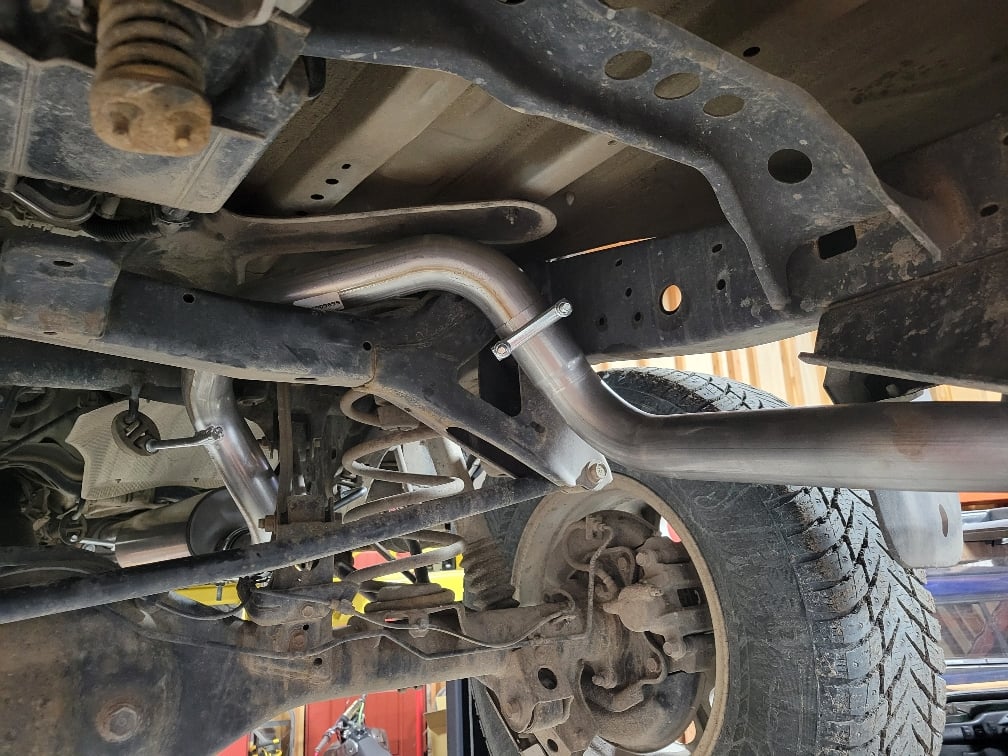

I threw on a Gibson exhaust catback side exit.... also threw on the summer wheels and tires...a solid Friday evening!
Sent from my SM-G991U using Tapatalk
i had to cut my side exit exhaust off after wheeling a couple times, it's just in the most terrible place. ended up having it just dump after going over the rear axle.

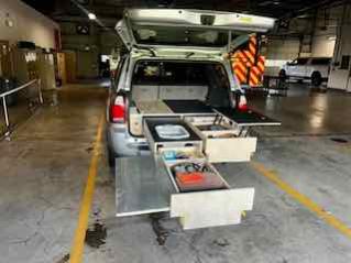

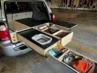

Just got done building a camp kitchen in the back of my 4Runner. Needed it low enough to get work stuff in the back and I think this will work! Also replaced the stock roof rack with a Prinsu rack! Really like the look and it lowered my RTT quit a bit!
As a result of the camp kitchen, I removed the deck board in the back of my 4Runner. I know these are expensive from Toyota when they sold them, but can they be added to a 4Runner that didn't include them? I'm thinking not, but I'm going to try and sell mine.
Very good looking set up. Just curious how much weight is hanging off the driver side of that box & how is it anchored in the truck?
