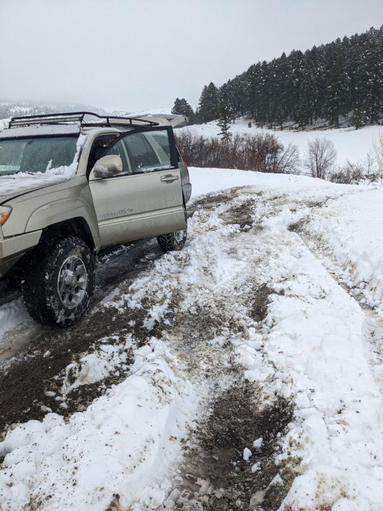

Well, it's supposed to be 70-75 degrees this weekend...but to get us ready for such lovely temperatures, we got 14" of snow yesterday and though it was slop more akin to slush than snow, I somehow got stuck still driving on my driveway...BUT, there is nothing like taking the ABS connection off under the hood to really wake up that v8 and exhaust notes; freedom was owed and I'm glad she made it out!

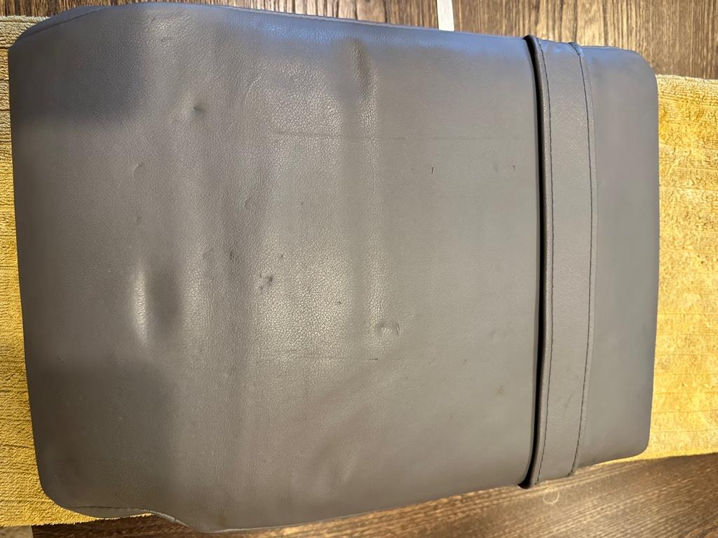

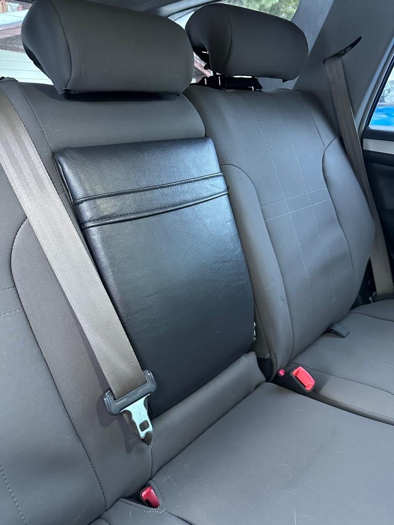

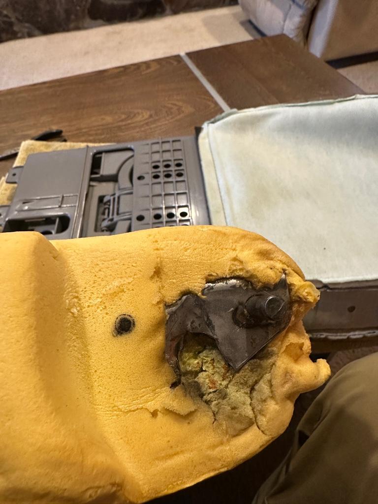

Rear center console had a busted bracket and wouldn’t stay in place. Found a working one at a Pick-N-Pull and swapped out the leather from mine. Good as new!!!

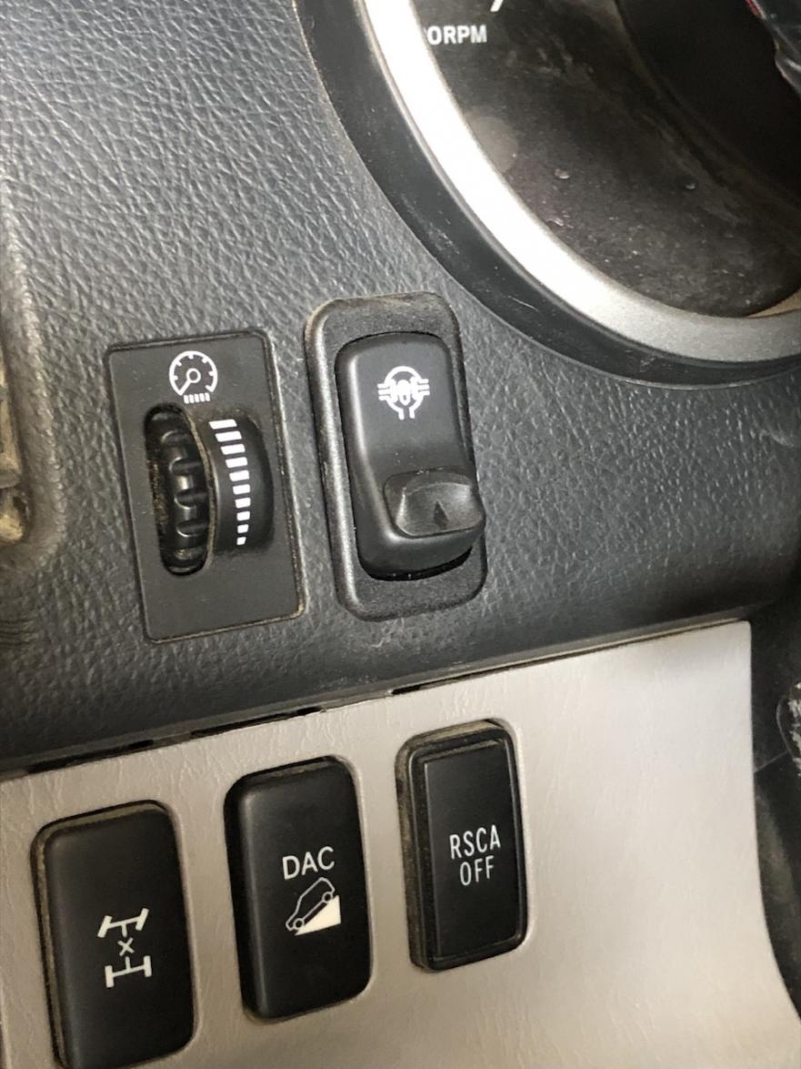

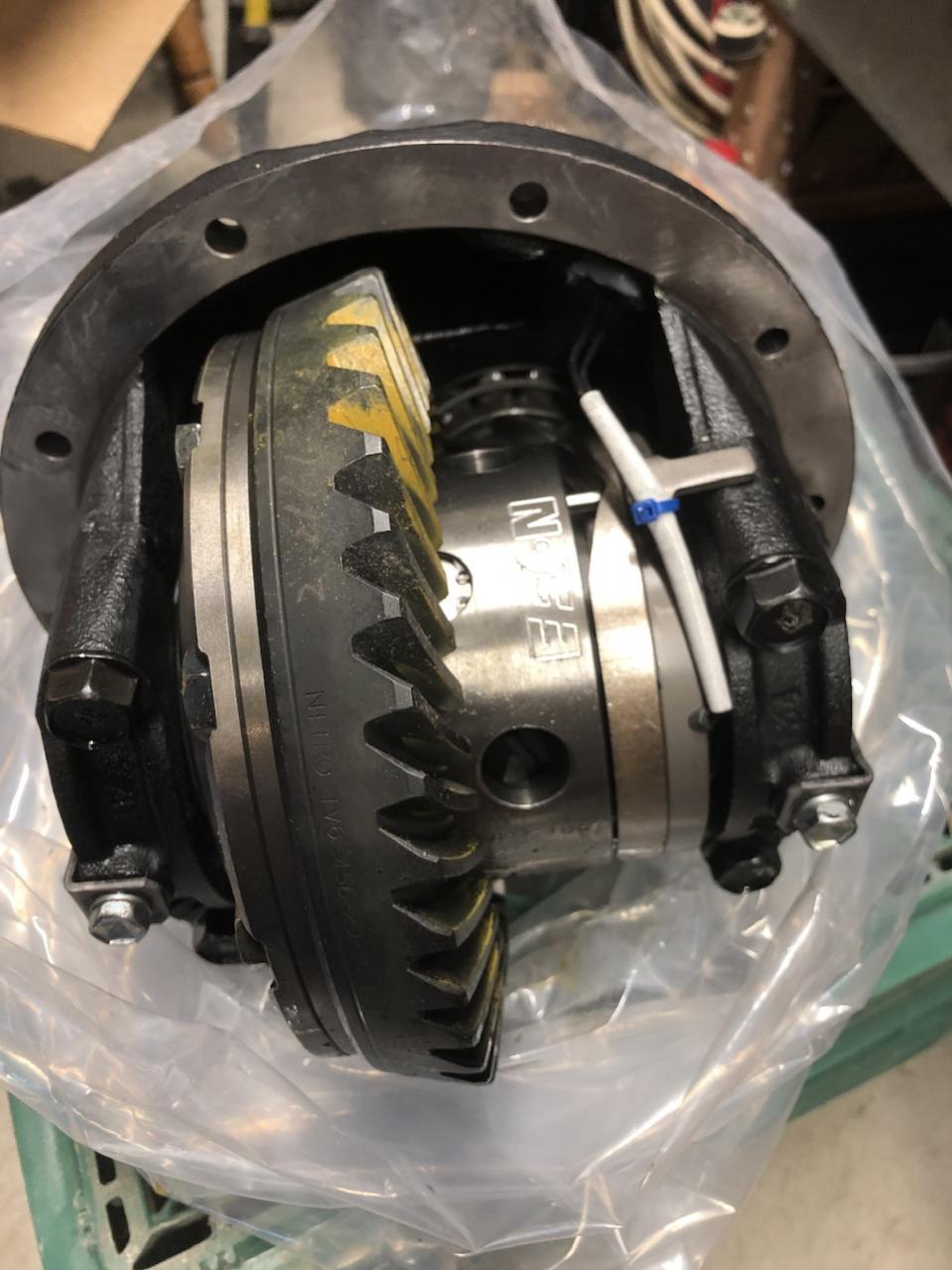

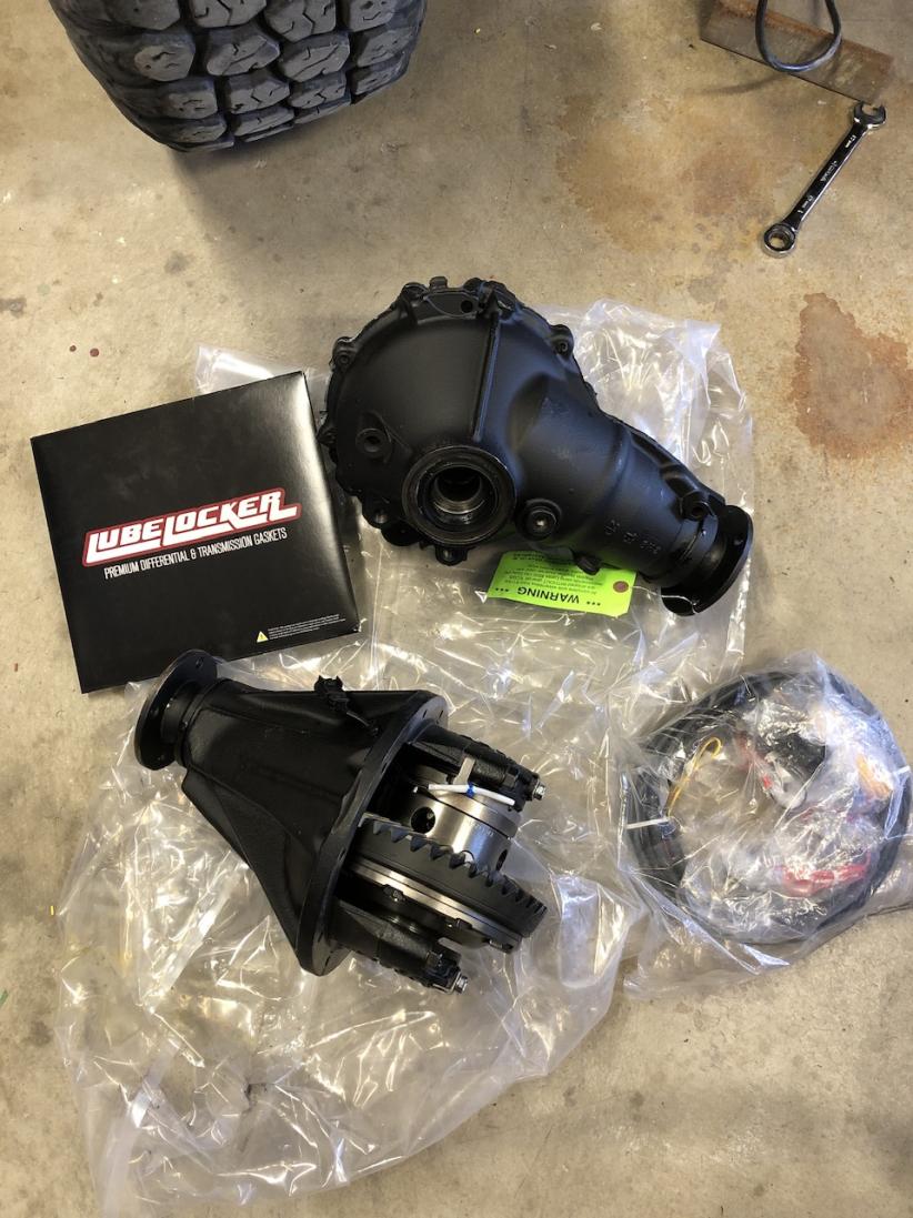

Test drove her a few miles after getting my diffs reinstalled. Got 4.56’s and an Eaton/Harrop E locker installed by ECGS. Still need to wire in the locker but got the switch fit into the dash. Also replaced a broken motor mount on my 2nd gen.

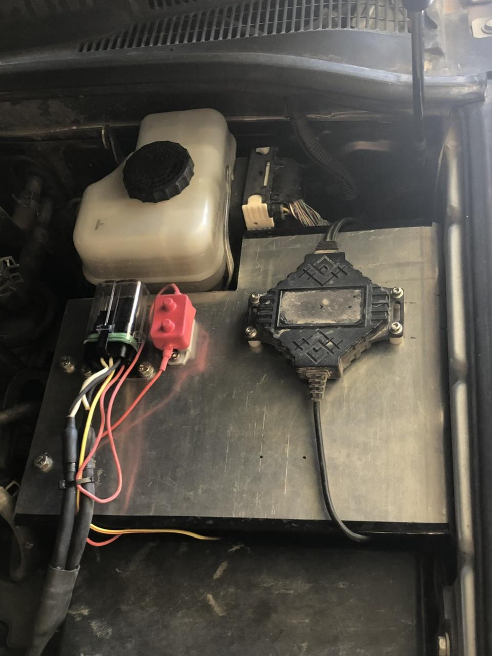

Finished up my E locker wiring. Installed the DIY power tray I’ve had on my shelf for months cause I didn’t have anywhere to mount the locker relay. Needs a little refinement but not too shabby.

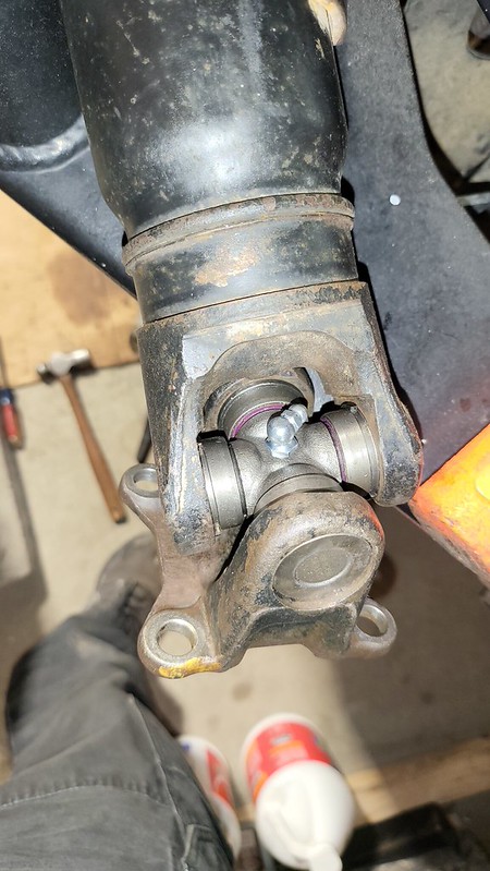

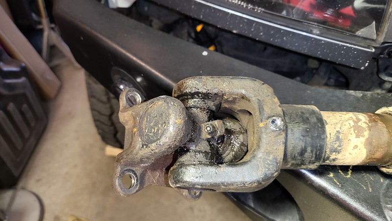

Replaced the u-joints on my rear driveshaft and changed the front and rear diff fluid post break in as I just had them rebuilt and re-geared.
I've been considering doing this on my rear as well. Did you have tools and a press to do it yourself? Since I don't have a press I might just buy a new rear driveshaft (~$425 from a recent check), which should also cut down on some of that braking clunk that got a TSB for some models.
You can install u-joints with a big C-clamp and some sockets, one big enough that the bearing cap can fit inside and another just smaller than the bearing cap, remove any retaining rings on both sides, place the larger socket on either side centered on the bearing cap, then put the smaller socket on the other side and apply pressure with the clamp until it's out.
Watch some YouTube videos even if they're using a press or whatever to help see the process, I have even changed them using a hammer and sockets if you really want to go caveman on them!LOL
